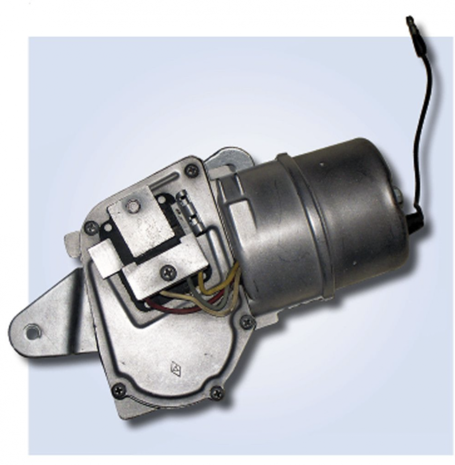

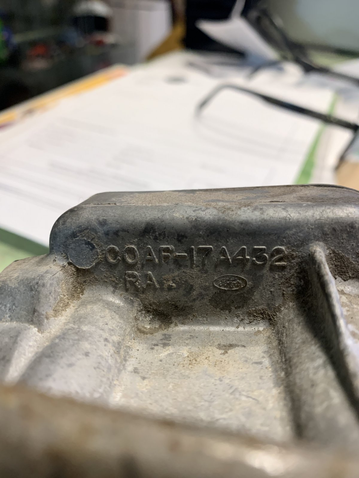

    This has been in my parts bin for a while..... I decoded it and its a 1960 electric wiper motor..... fits perfectly onto the 57...... not sure if its a 1 or 2 speed.... probably a 1 ....... need to figure a switch and make it work with my dash ... so it looks factory..... and yes.. test it.
    I have an Amish pal that love everything electric....fixes starters, repairs generators, etc,etc......
    Have at it Levi......
    Seems Hemmings says that Ford never came out until 61-62 with an electric motor.....
    Parts#say different.... IMG_9399.jpg IMG_9400.jpeg Screen Shot 2022-01-11 at 8.08.58 AM.png
    chryslerfan55, enloe, alfin32 and 9 others like this.
  2. Can't tell by either photo of wiper motor but if it has the slide switch as does the tri 5 Chevy unit the stock 57 Ford control cable hooks right up and operates it like a stock Ford unit. They were 2 speed motors.

    I'm thinking the 4 wires are telling us there's more than just one speed on/off.

    I tend to agree guys.... the switch has 3 positions when I slide it back and forth.

  7. First appearance of a factory Ford electric wiper motor was '60, it's noted in my factory service manual. Only used on the factory AC, PI and Hipo cars, the latter two as their solid-lifter motors didn't develop enough vacuum to run vacuum wipers well enough, so that's not a common part. For a number-matching restorer, that may be worth a personal body part in trade... LOL

    C&G sells aftermarket universal 2 speed switch for the motor. Believe the retainers and bezels are same for '57-'60 but they would be able to tell ya. Nice folks, know their Ford stuff.

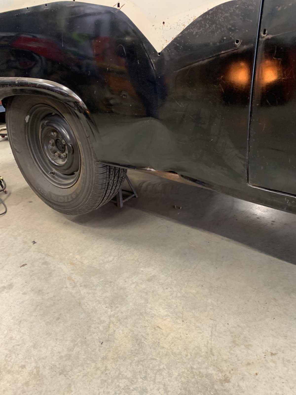

    There was a NASTY crush dent and tear in the p***enger side behind the B pillar and the rear wheel. I could have simply used a patch panel in stock.... but.. My mind was really on pulling it and straightening as best as possible.
    My skills are not up to this but my pal Rob looked at it and said lets give her a go.
    After 30 minutes... it was 85% in shape.
    I was just amazed at my pal Rob's skill.
    Still need a bunch more hammer n dolly work... but its on its way.
    This poor car received a lot of abuse..... in its prior life.... someone either went off roading and hit a m***ive rock or it was damaged by a forklift.
    Gotta remember,.. you could buy a used 57 custom in the 60's or 70's for $25.

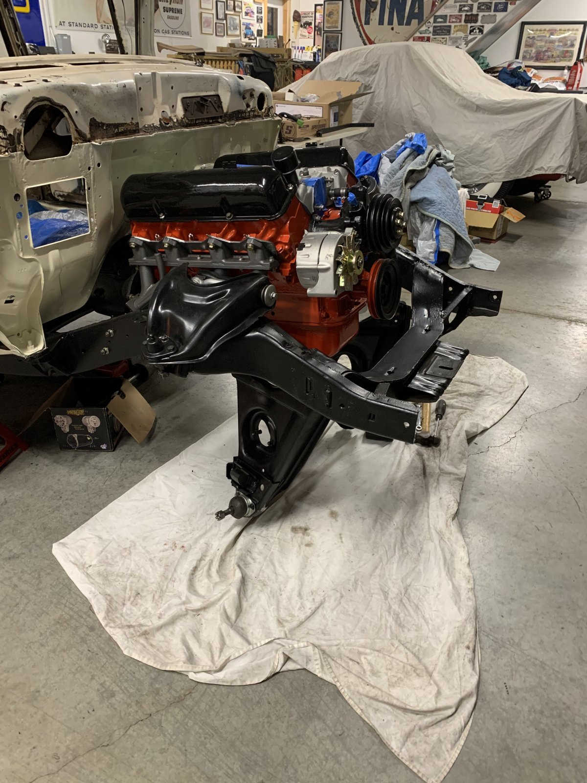

    And began to ***embly the lower A arms.....All new bushings and such.(upper and lower, with new Ball joints too) 66398144016__DC6516FF-17DC-44D6-894C-0B6AE26B5652.jpeg
  15. Wow, that's a good solid quarter bottom. I'd have done the repair instead of replace on that metal also. Nice save, nice work.
  16. Rob is my kind of guy. Less invasion, less repair. :)
