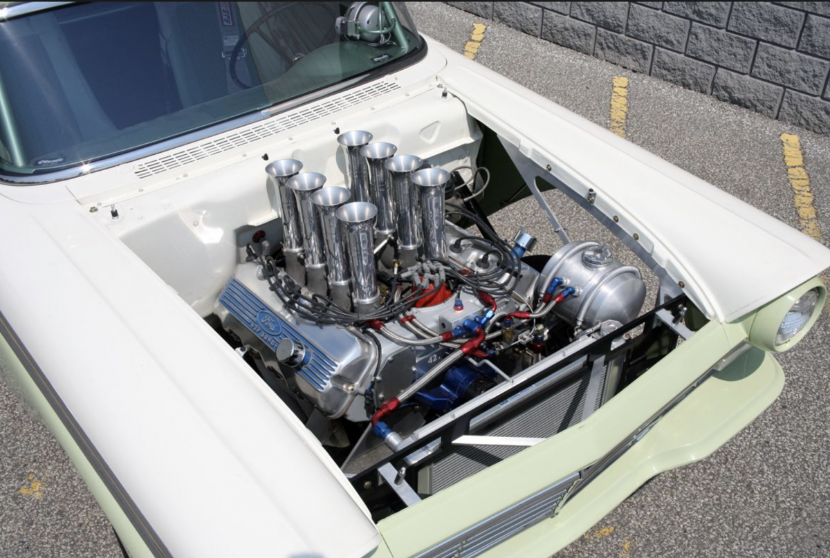

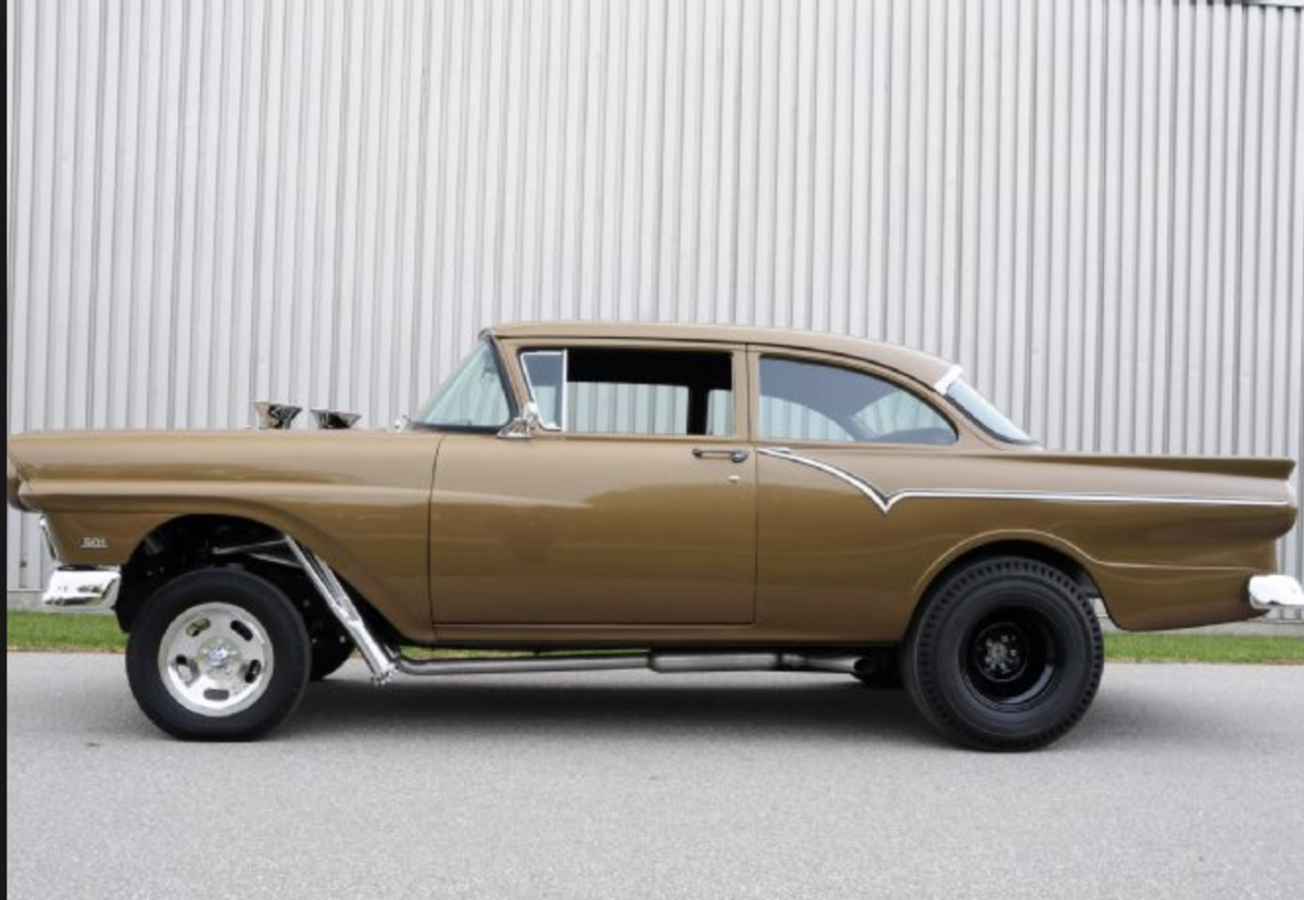

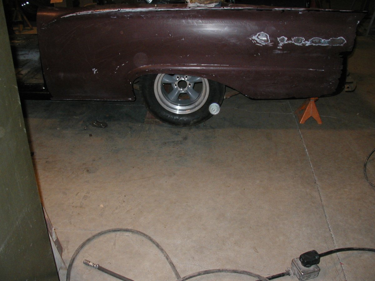

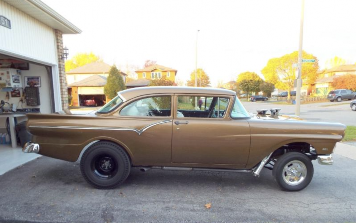

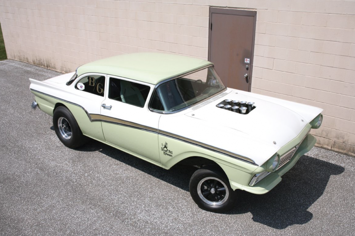

    There are a few local ones around here!..... I love them,Here is some inspiration. Screen Shot 2019-02-06 at 4.30.42 PM.png Screen Shot 2019-02-06 at 4.30.52 PM.png Screen Shot 2019-02-06 at 4.31.28 PM.png Screen Shot 2019-02-06 at 4.31.45 PM.png Screen Shot 2019-02-06 at 4.32.05 PM.png Screen Shot 2019-02-06 at 4.32.16 PM.png Screen Shot 2019-02-06 at 4.32.33 PM.png Screen Shot 2019-02-06 at 4.32.43 PM.png Screen Shot 2019-02-06 at 4.33.34 PM.png
    Good luck.
  24. On the Brown 57 I really like the detail work around the rear tire opening instead of just leaving the raw cut line.
    Texas57, Deuces, Hombre and 1 other person like this.
  25. Jeff Norwell
