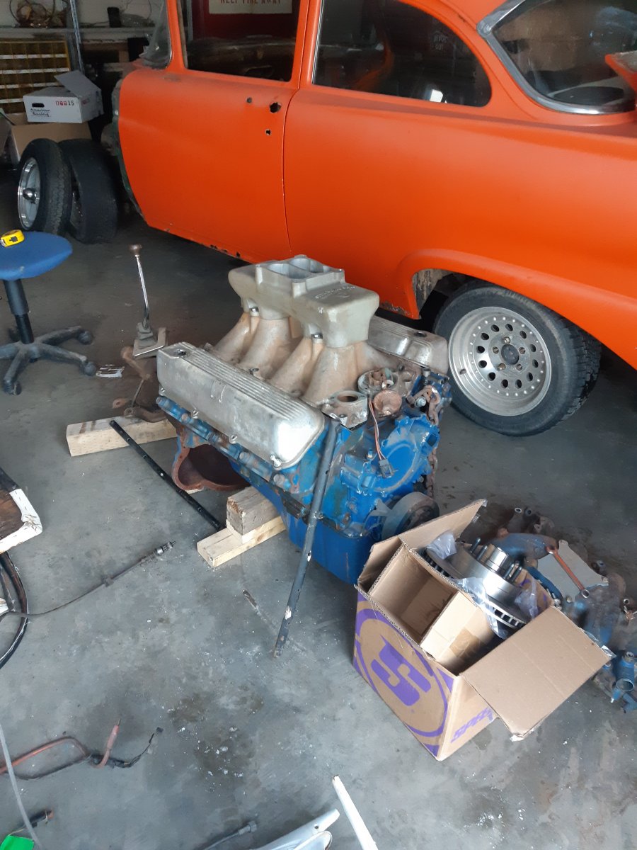

    I know i know. But honestly for now im going to run one. My work has a Quick Fuel 750 that was traded in 'deffective' they're going to give me. I don't want to bother with 2 carbs on a street car for the time being. Cost is a bit prohibitive as well, I'd be close to 2000.00 for a pair of carbs and all the linkage to make it work. Canada isn't cheap for anything.
    Had to set it on the engine, obviously. Lol.

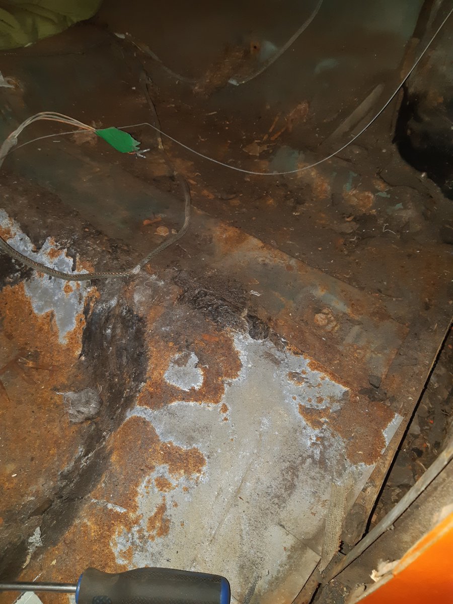

    So I did a little digging and investigation cuts. Not surprised at what I found. The original floor is under the SEVERAL stacks of what would appear to be old appliance sheet metal. There are 3 layers of this stuff riveted, screwed, and "welded" down. The body mounts on the frame themselves are good. Very little left of at least 3 of them in the floor side. The p***enger side is better with more of the original floor actually still being used. The inner and outer rockers are very soft in a few places. Replacement is necessary. The floor that is under the rear seat is actually quite good. Toe boards look good further up the firewall. Level with the floor and below have been patched. The lower a pillar has issues for sure, more so on the drivers side than p***enger. The tunnel has been cut for a 4 speed shifter before and patched with fibergl*** then cut again! So that will require some attention but not total replacement. I've got some work ahead of me for sure but i'm excited to dig in. Here's some photos of the rust and curiosity cuts I made. 20190228_183822.jpg 20190228_183816.jpg 20190228_183800.jpg 20190228_183729.jpg 15513939427867648615449305785774.jpg 20190228_183822.jpg 20190228_183816.jpg 20190228_183800.jpg 20190228_183729.jpg 20190228_183538.jpg 20190228_183534.jpg 20190228_183528.jpg

    oldiron 440
    The 429/460 is a good combination for a tunnel ram, some of the best running street tunnel rams I've seen have been the big Ford or 440 mopar.

    Lee Veinotte
    Should make good use of the long runners and big open plenum. Im really hoping that keeping the carb cfm lower will help with low rpm driveability. I know the big Ford will have a ton of torque down low anyway so it should work out ok.

    Im still wanting to keep this on the street. Back seats and all, the most roll bar I would want to put in it is a hoop over the front seats and maybe door bars. I don't really like the idea of the body being perminently attached to the frame. It still needs to be road legal and I don't think the inspectors would care for no inner rockers or not using the body mounts.
    I'll need to figure out another way to fix this rust up.
    Would a 1x4 tube frame under the floor suffice as body mount attachment? It would appear to be the right thickness and would be plenty strong

    Ill definitely do that, study the floor pans and brace design and draw it out to scale so I know what I'm dealing with. I think I've come with a decent plan for doing the job. I'm going to brace everything solid first off. I'm having new outer rockers bent up now and ill be replacing those first if all goes well.

    Beauty, I appreciate having somewhere to start. Ill take a good hard look at everything and see what sort of shape I need to rebuild my lower A pillar and work backwards from there. Would it be ok to cut a strip of the floor away from the inside of the door jamb in to the center of the floor say.... 5 or 6 inches? All the way from the front toe boards to the rear seat pan? Just to have a full view of the whole inner?
  16. I would say once the Home Work is done and you know how far the repair is going to go, you have your Cowell and B posts well supported I would remove all that rotted floor section on one side leaving the inner rocker to build out from. You should have a nice protractor to determine angles and a few good strait edges of different lengths. Personally I'd build all new body mounts if I had all the floor pan out of the Car. Nothing is worse than trying to weld new metal to Old Soft rusty tin. That said I'm sure you know that rust burns when trying to weld to it. Make everything you weld to clean and bright on both sides before welding.

    So I should build a temporary body mount from the frame up to the existing pillars after they've been repaired. Sounds like a reasonable plan to me!
    loudbang and Pist-n-Broke like this.
  20. Think of a Crutch. From the frame up past the broken bone to a solid support point like the Arm Pit. You also need to be able to work around it.

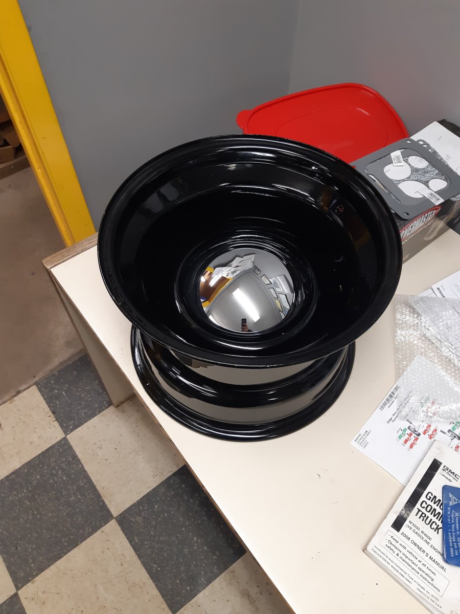

    Well due to a stupid snowmobile injury-s***ches in my knee cap and bad bruising- I haven't been able to work on the car for a few days. I did however receive my wheels for the rear of the car today. 15x10 black steelies. Also got my new Borgeson manual Vega box, and a front motorplate for the 429.
    The motorplate might not be super correct but i've had them on cars before and my god it makes everything so easy I don't think I could go back to mounts. 20190305_114303.jpg 20190305_132824.jpg 20190305_132829.jpg
