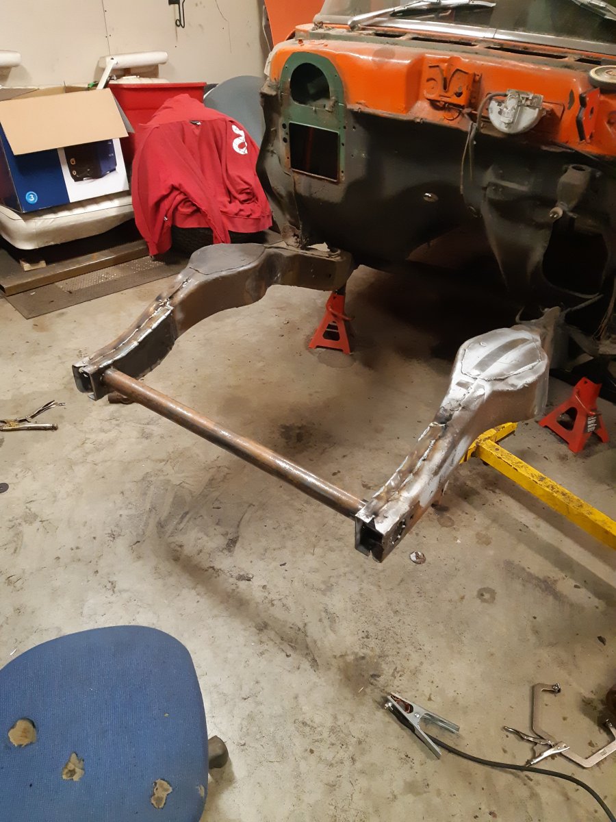

    No huge updates. Just been picking away at the front frame section. Got my spreader bar all tacked in place, need to make a couple end caps and it can all be finished welded and the axle hung. 20190320_203336.jpg

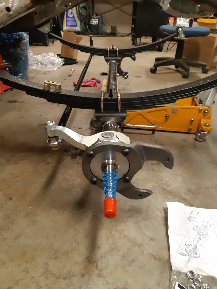

    Big day today. Got the axle located and the spring hangers tacked into their final resting place. Loving the look of everything so far. Engine positioning is next! 20190331_190955.jpg 20190331_192732.jpg

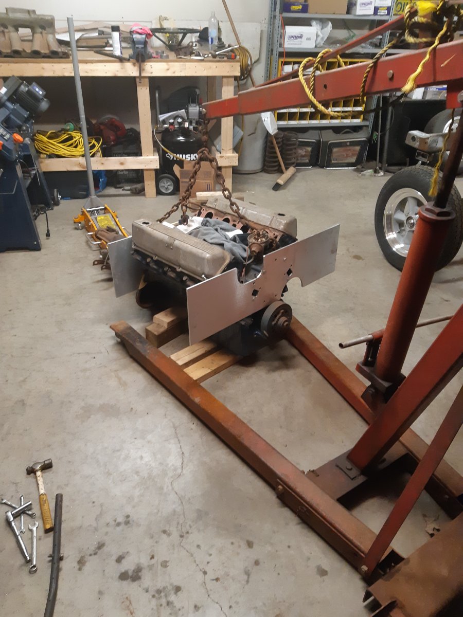

    Also got the plates fitted to the engine. Tomorrow night is mockup time. 20190402_201013.jpg 20190402_193458.jpg 20190402_211341.jpg

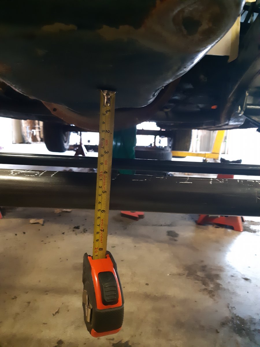

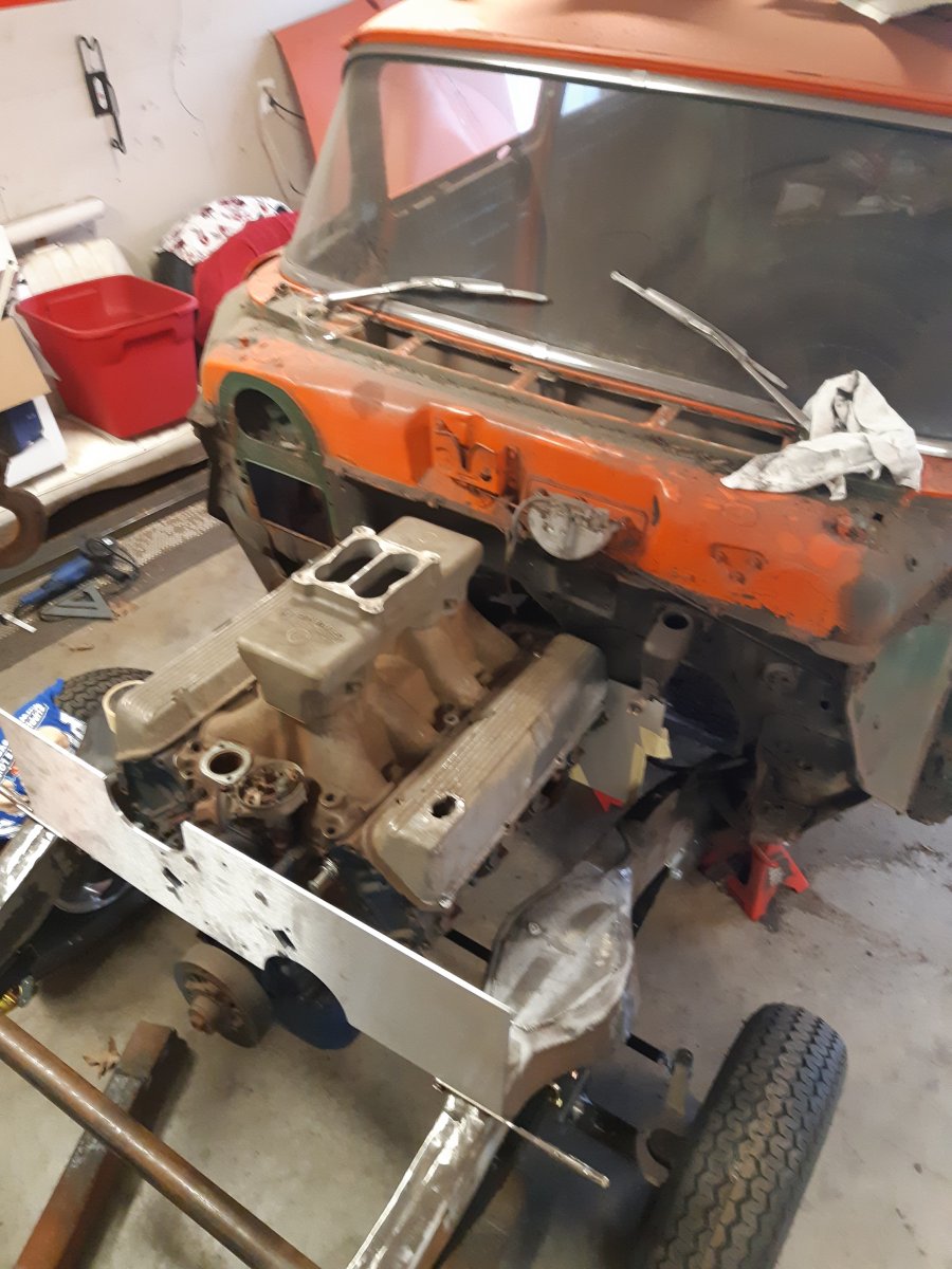

    So i've got the engine mocked up in the front frame. The motor sits nicely between the rails but I may have an issue. The axle is only about 4" from the pan. The drag link will be even closer. I'm at 27" crank center from the floor on the balancer bolt. I'd like to get it down to 24" as per 67' rules. However i don't see how I can lower the engine or the suspension that much. Any ideas? 20190403_185751.jpg 20190403_185828.jpg 20190403_185839.jpg

    I got looking around at the Shakey Pudding '55 and she wouldn't have any more than 4" between the axle and the underside of the frame. And much less than that between the drag link and pan. I doubt my car will pull the wheels and come down like that honey does so i may be ok?

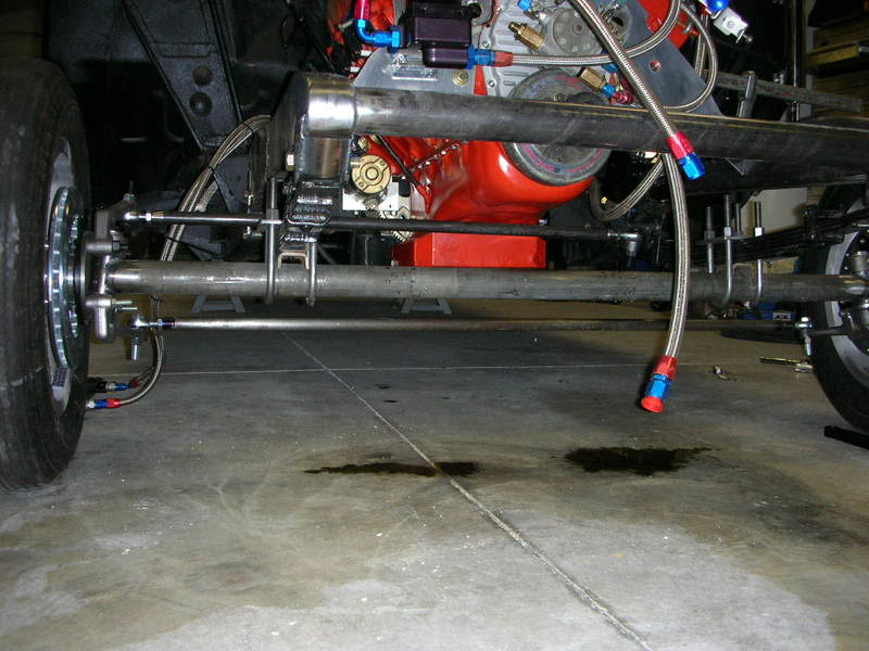

    "Photos borrowed from the build thread, please delete if it's not allowed" DSCN0460.jpg DSCN0461.jpg

    A rear sump pan. Like a 429-460 Fox body swap oil pan.
  21. Lee Veinotte
    Joined: Feb 6, 2019
    Posts: 142
    Lee Veinotte
    Only thing is the drag link will have no clearance with a rear sump. Its path may even want to go through the sump.
  22. Dang,, it's all that Math stuff that gets us screwed up eh? If I'm reading this photo right
    [​IMG]Judging by your valve cover to master and carb base on tunnel ram to hood latch, looks to me like your motor is mounted way low based on where it would be in stock 57 mount location. Is this correct?
  23. Sky Six
    Joined: Mar 15, 2018
    Posts: 16,010
    Sky Six
    from Arizona
    I just checked the position of my 292 in my '57 Fairlane, and the engine does look like its sitting low. Good eye PnB.

    Yes judging by the picture I have of the 289 that came in the car it is sitting a bit low. It can be raised but I'll have to build some fancy brackets for my plates. I'm basing the engine height on the rulebook for gas cl*** cars. My car is not very correct with the later engine ect but I'd like to keep it somewhat correct. I can raise the engine and lower the suspension, its very stiff as is so I would like to remove a leaf. But I still won't make up 3 inches of crank height. 20190209_190305.jpg

  27. I could give you a valve cover to weld seam if you like. So, were I doing this job the motor would be sitting in Factory location no matter how it was mounted. Reason being is Clutch linkage, why re design something that works just fine? Now that will raise the Crank C/L but may solve some of the other issues. I kind of get the Nose Bleed ride height but you may need to adjust some to fit the rules. I know everybody does it just like you did, in other words you followed the crowd. They may not want to fit the rules you do. What happens when you raise the motor to where it started and then mount your Axle on Top of the springs. Take some time and do some Math and get back to me. Screw the instructions and Screw how everyone else has done it. Make it work for your needs.

    The crank centerline should be a few degrees up front frame centerline not nose down.

    The axle over the spring will get it down in a hurry, but might cause more interference issues.
    As the Wizard said, work to the clutch cross shaft. The front sump has always caused issues but they can be resolved. Another possibility would be to use a dropped axle. Seems like it's counter productive, but it gets the center of the axle out of the way.
    Looking at this, I'd say your WAY HIGH! For a guideline the South East G***ers have a max rocker panel height of around 11".

    In that picture I've got the carb mounting flange set at 0° which equals about 3-4° downward slope of the engine itself.
