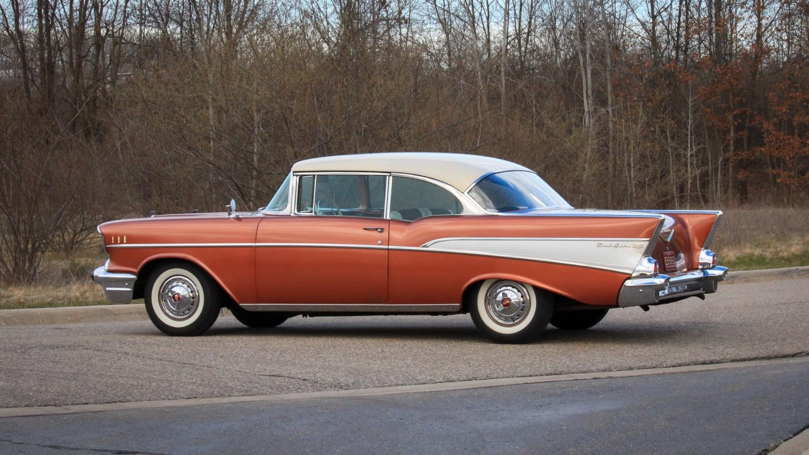

    Giving this a try over here in the O/T section, given some of the parts selection on the car.....
    I've had trifive fever for a little while now, and found a nice candidate a couple months ago. The backstory is a two family owned, 70k mile survivor that's unrestored. It was a little ways from the house, but I fortunately had a buddy that was going to be in the area to lay eyes on it before I invested the time to go get it.
    It's a Bel Air hardtop - a bit cliche if you will, but the Sierra Gold and white interior make it stand out a bit to me. While unrestored no doubt, it has had a couple touch ups but being lacquer, it's been a while ago. Other than the EZ eye gl*** and powerglide, it's a no frills car.

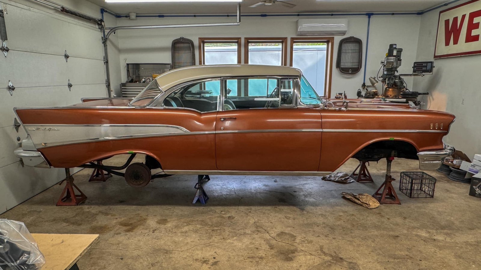

    When I started off searching for a '57, my intentions were going to be a LS/LT powertrain, in a Fast Track ch***is. The course changed with this car though - it was too nice in my opinion to cut up. So with that, I took a step back to use exercise restraint on how much to change with the car.
    I put together a plan for some ch***is improvements in the suspension and brake departments, along with a transmission change. I couldn't bring myself to cut a whole in the floor, so I decided on a 200-4r to replace the powerglide.
    I got the car in the air, stripped the ch***is down to the frame, and was still surprised by how nice this car was underneath. The floors were perfect, with the red oxide still looking fairly vibrant. The car had a seamless frame (from the Norwood plant), in great condition. The ch***is bushings were definitely tired, but those were getting serviced anyway.

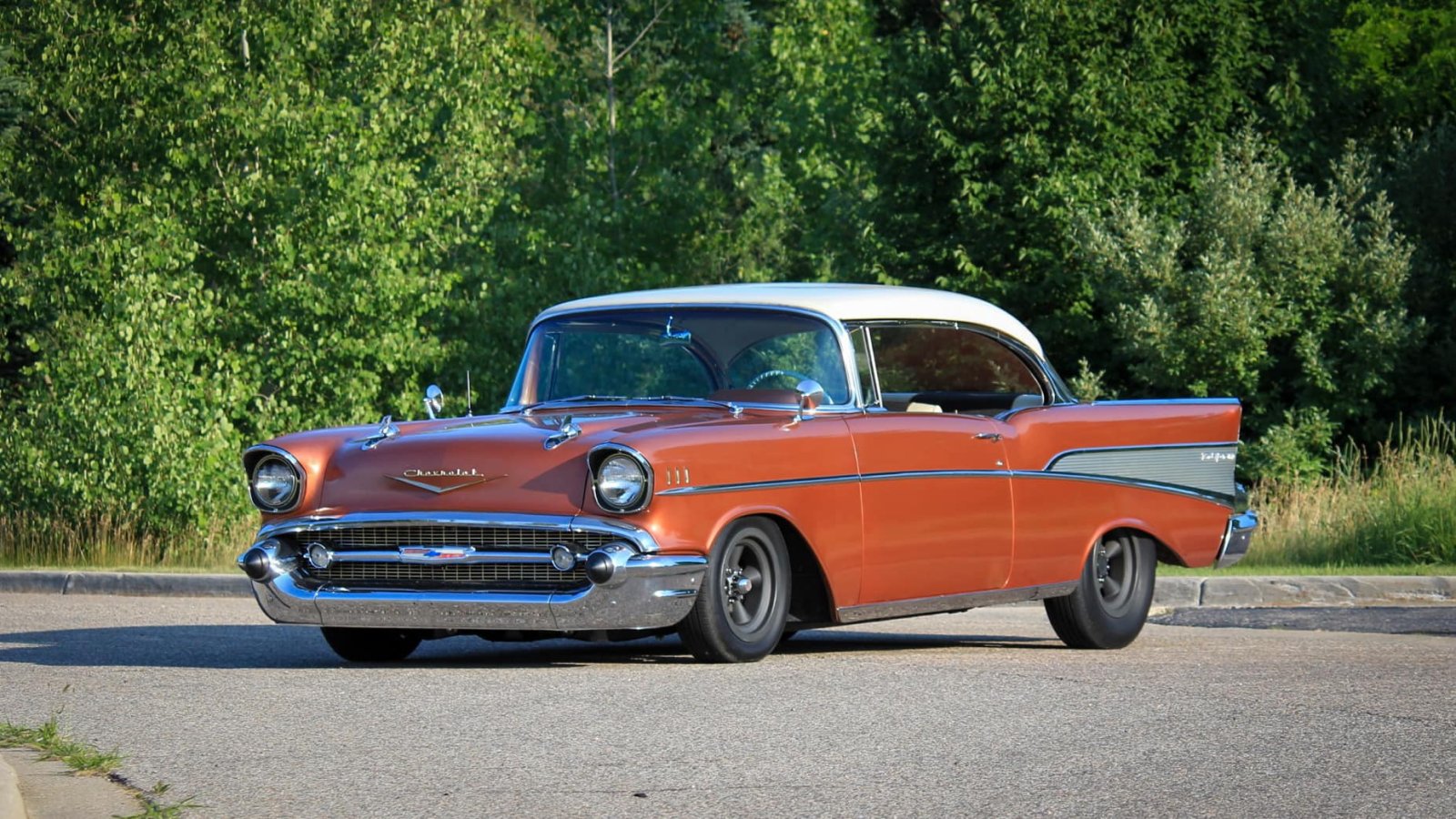

    I'm still blown away by the driving dynamic shift with this car. I knew the upgrades were directionally better, but wouldn't have guessed it would land as well as it did.
    I have a few little projects on the car to pick away at, but my main focus is going to be adding some more miles to it this summer!
