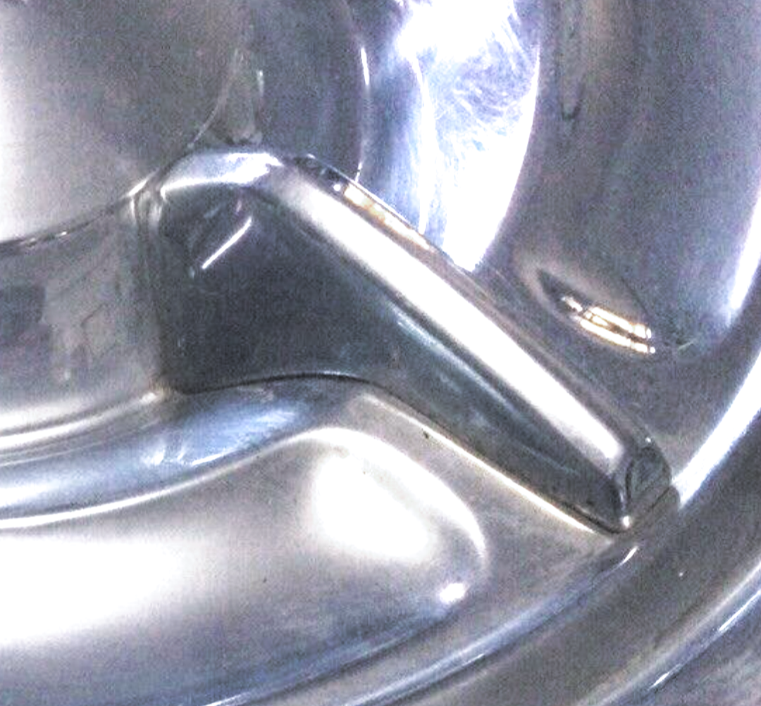

  3. Screenshot_20230402-192427.png Sorry fellas, confusing terminology. Looking for the hubcap flipper bars/blades..teeth? What the heck do I call them?

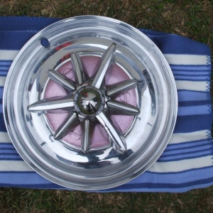

    These '55 Olds flippers on the '56 Fiesta were all made from stainless steel
    that I made off a pattern from an original. Had a shop laser cut me 30 or so
    and brought them home, folded them over my drill press handle, hammered the end over,
    and welded in a bracket across the other end that hooked them on like the original.
    Looks like you could do the same on the '57... they should be just screwed on like the '55s
    and shaped just a bit different.
    Take one off, fold a paper over it and cut a pattern, find a fab shop that can cut them,and you are darn near there. Watson hubcap1.jpg
