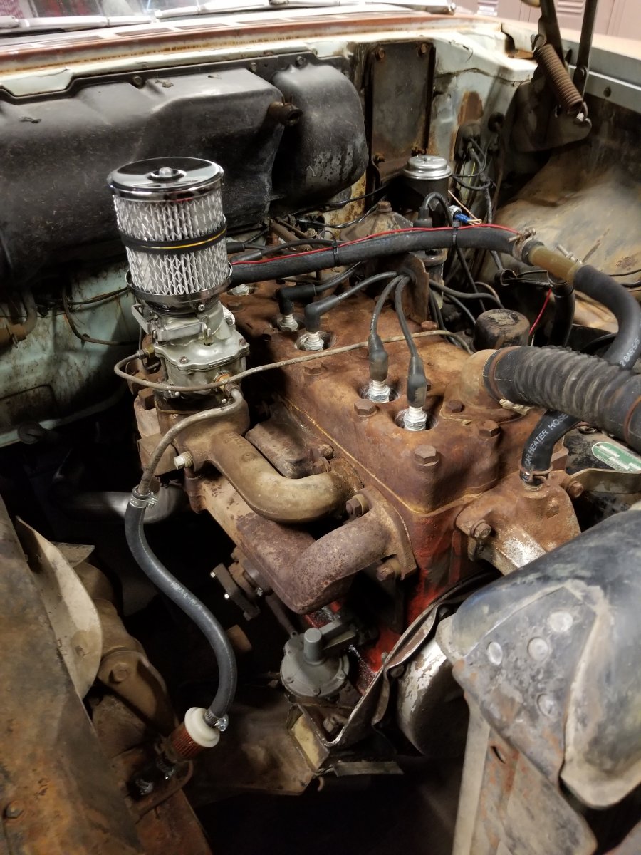

    I am really enjoying the heck out of the rebuilt 230 flathead six in it! Ive rebuilt the carb, replaced hoses and belts and narrowed a misfire down to the distributor, which I am ordering from langdonstovebolt.com.
    The 2 speed Powerflite, however, leave a little to be desired. It gets along okay, but I'm a tinkerer. I have a friend with a T5 out of a V6 mustang. We originally thought that it was out of a V8 Mustang and I was gonna run it in my '59 Apache with a 383" SBC. It's not strong enough for that application, but pushing this 3000 lb. Plymouth behind the 63 year old 230 flathead straight six, I don't see any durability issues. The only potential problem that I see is shifter location, as going away from the factory bench seats is a deal breaker. I may need to source an S10 trans for shifter location.
