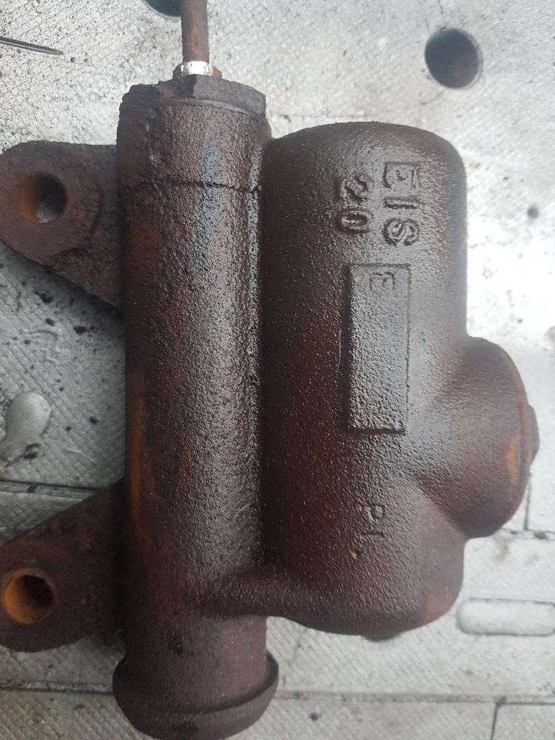

    That master looks like a mid 50's Chev master I have on my s**** pile.
    One inch piston. Three bolt mount flange.
    Rebuild kits should be available on the tri-5 web sites.

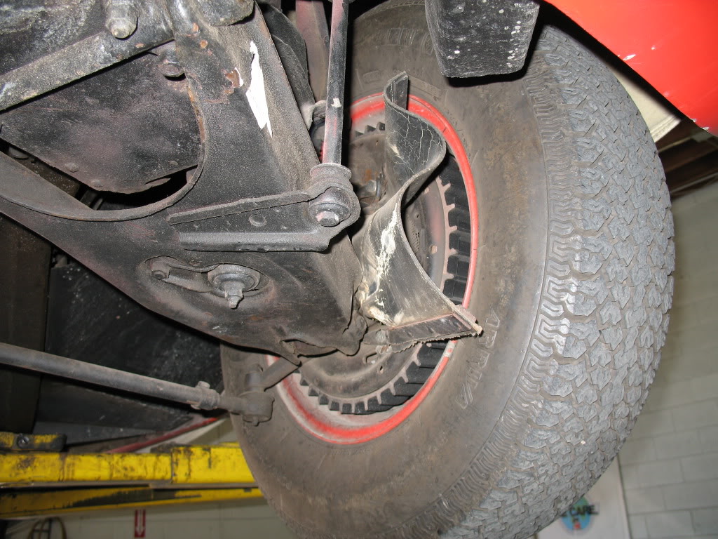

    For reducing fade, you might want to take a look at how 57-62 Corvette RPO 687 big brakes were made. Wider shoes, vented backing plates, and cooling fans. There are improved brake lining materials these days. Seems like development on drum brakes stopped when discs arrived, but it doesn't mean there's not stuff we can do to them.

    DaveDCanada
    Can anyone tell me what year and/or make this master cylinder is?

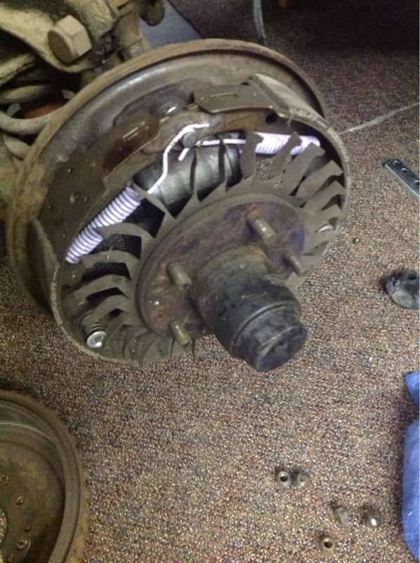

    0127181316.jpg 0201181238.jpg 0205181407.jpg 0206181419.jpg 0127181316.jpg 0201181238.jpg This is what I did to my 51... I believe the braking is the same. I would ***ume the master is about the same. I cannot remember where I got the master and bracket. I believe it was Scarebird...
    I did, in fact, go with front disc brakes. No power. Works well.
    I got the idea on the Hamb and communicating with others.

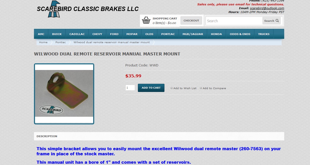

  25. ClassicDriver
    Joined: Mar 8, 2010
    Posts: 124
    ClassicDriver

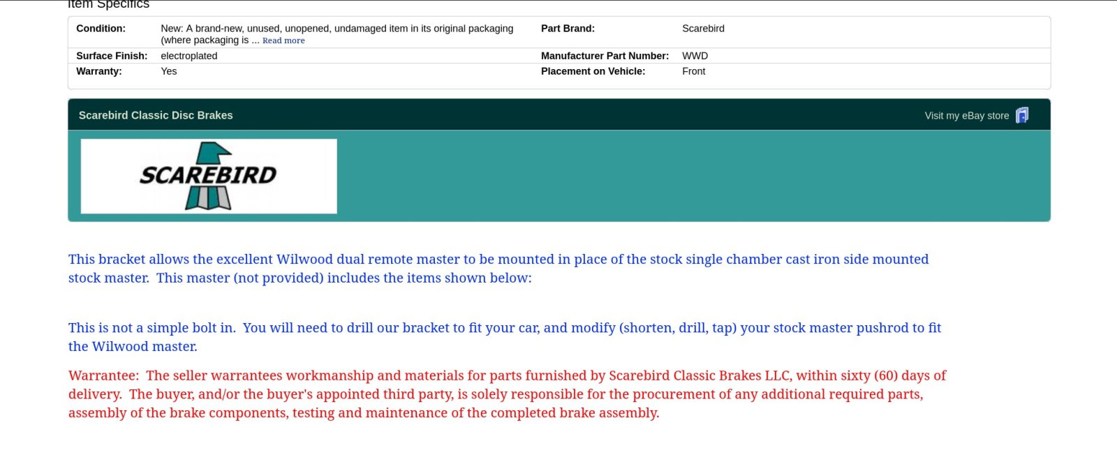

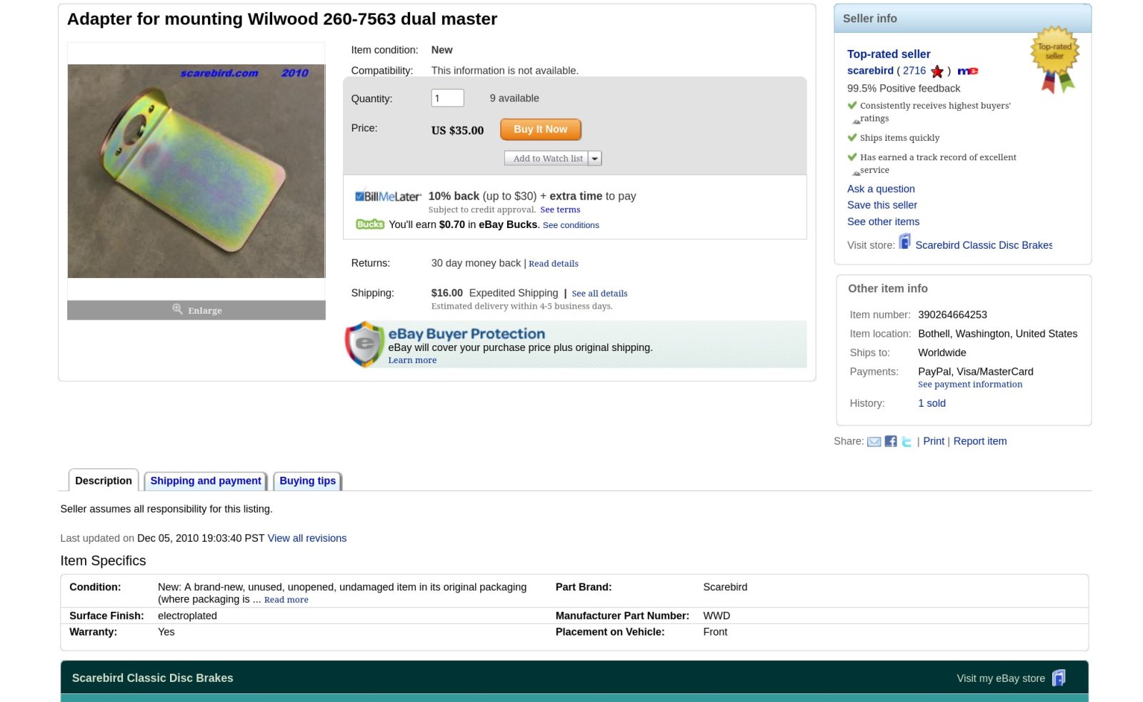

    This is what I dug up from my files. The pictures are screen shots from 12 years ago. I bought the piece from Scarebird thru ebay. See the pics of the ebay ad back in the day. Hope this helps. Scarebird A.jpeg Scarebird B.jpeg
    Good luck.

  27. ClassicDriver
    Joined: Mar 8, 2010
    Posts: 124
    ClassicDriver
    Yes. I dug up from my files...
    It is in the pictures. Wilwood master cylinder, scarebird bracket. See pics. You'll notice I had to modify the bracket a far amount.
    0206181729a.jpg 0206181730a.jpg Scarebird MC bracket.jpg Willwood Master.jpg
