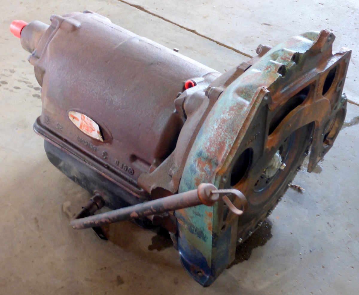

    I wanted to try and keep it as authentic as possible. I found an old Hydro-Motive trans. 3 days later I found an Old B&M Hydro. I thought between the two I could make 1 good one. Thanks to the HAMB I found an NOS Ansen posi shifter for it. Oddly enough with a matching green knob and boot. IMG_2229.JPG SC Hydramatic (1).JPG IMG_2377.JPG IMG_2126.JPG

    Pulled the rear and went with 3.90. Did some math and with the new stroker moter I might step up to 4.33. Also rebuilt the slant pan hydro. Glad I had both transmissions. Needed the torus and pump from the Hydro-Motive unit. Decided on the B&M because it was in better shape overall.

    " Big advantage to using the 389 vs the later 421 is that a 55 bell housing for the hydro bolts up to the 389."
    Yeah, but wait! Did you bolt the torus to the 389 crank? Notice it didn't go on quite straight? You absolutely HAVE to clearance the edge of the 389's crank flange to bolt it to a slant pan hydro torus or the front pump of the trans will be damaged when you fire up the engine. Seriously.
    I've done this swap before. This fact was explained to be by a buddy who put a 59, 389 in his 55 safari in the early 70s. He ruined the trans when he fired the engine. Ten years later, [1982] I almost did the same thing when I bolted a 60, 389 into my 56 cheiftain with the early 56 slant pan hydro. I had to remove the trans and grind the edge of the crankshaft flange to get the engine-side of the torus to seat against the crank's flange. Worked great. A common 4 inch grinder works just fine. You don't grind enough to affect the engine's balance.
    This modification was mandatory to fit a stock hydro to the 389...don't know why anything would be any different with the B&M trans..it's just a modified slant pan hydro.

    56sedandelivery
    A somewhat similar situation exists with Chevrolet V-8's, other than those with a completely round crankshaft flange (265/283); any 307, 327, 350, 348/409, and BBC's need to have the Hydro flywheel machined to clear the crankshaft balance pad. Sealing the crankshaft bolts, and flywheel to crankshaft flange surface also has be sealed. And off course, the Hydro's used a pilot bushing much like a manual shift transmission uses. I'm sure some of this information is covered in the Hydro Group Forum here on the HAMB. I am Butch/56sedandelivery.

    Hey Rocky thanks. You warned me about the flywheel issue when I PM'ed you and I also have a copy of the old B&M catalog. Also, bought a 55 cross member from 55Chieftain here on the HAMB. Hydro group has been great as well. Here is part of the Pontiac page from the catolog. I can copy it to a PDF if anyone is interested. Thanks again. IMG_2508.jpg
