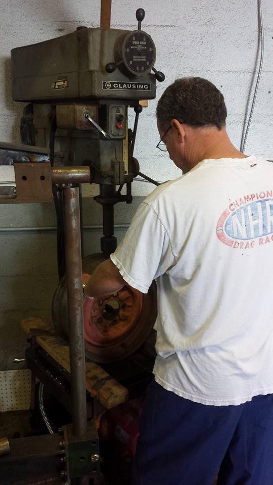

    I machined the flywheel rather than the crank. I noticed the flywheel that came with the B&M looked like it had been turned on a lathe. Makes sense because it also came from a 389. This is my 59 motor with 55 bell housing.

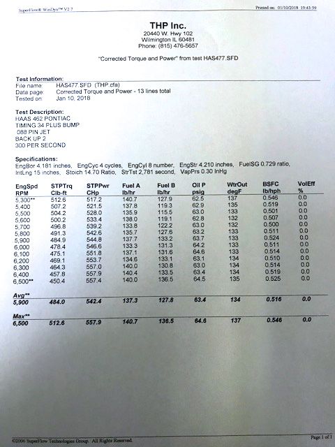

    Forgot to post the Dyno sheet. I was very happy with the results. Made 557 horsepower. Haas_dynosheet-1.jpg
