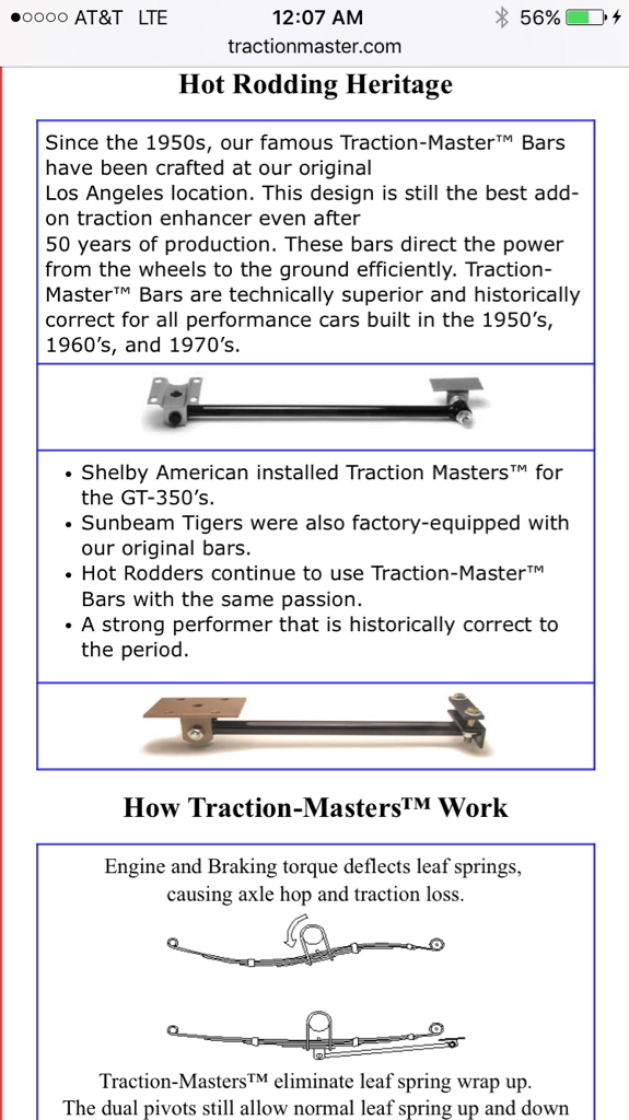

  14. In the first illustration. All that style does is stop the spring wind up and deflection. The front bracket is welded to the frame at a point forward of the spring eye. If the spring eye bushings were solid, like on a Cal-Trak and most serious leaf spring /******* bar install, it would ride terrible too. The rubber spring eyes will give some on a street car, or on a mid 60's drag car , for that matter.
    The second style looks like it was meant to clamp to the spring. It still won't create much separation to plant the tires. You could bolt a piece of spring and some clamps to the front half, and do the same thing.
    The ******* bar does not pivot at the axle end. Therefore, as the axle tries to rotate on the spring, the bar pushes up at the spring eye and causes separation, which in turn , plants the tires.
    The Cal -Trak is a bit more sophisticated. It almost acts like a mini 4 link, but does create separation also.
    BTW, Jenkins had Lakewood ******* bars on is A/Stock Chevy II in 1966 and I believe that's right around the time they went on the market.
