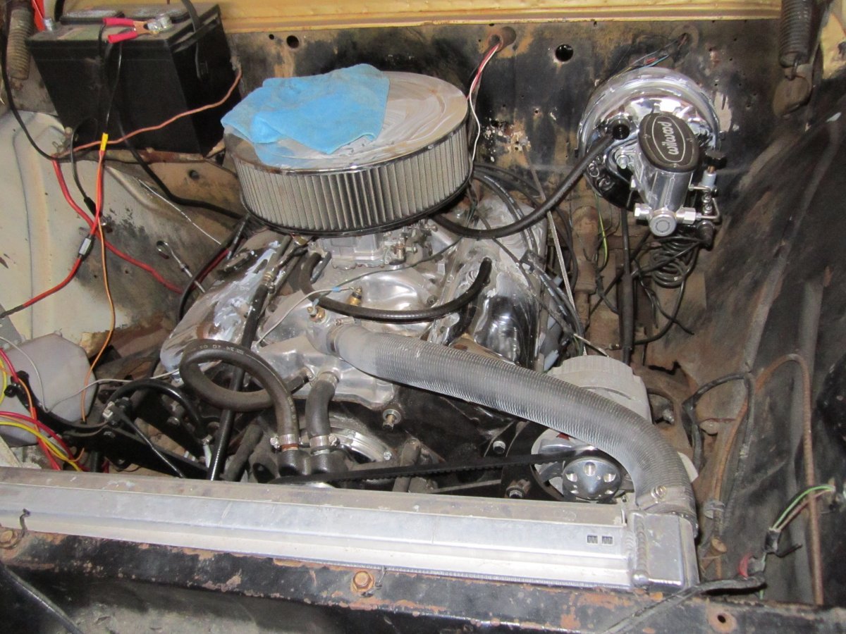

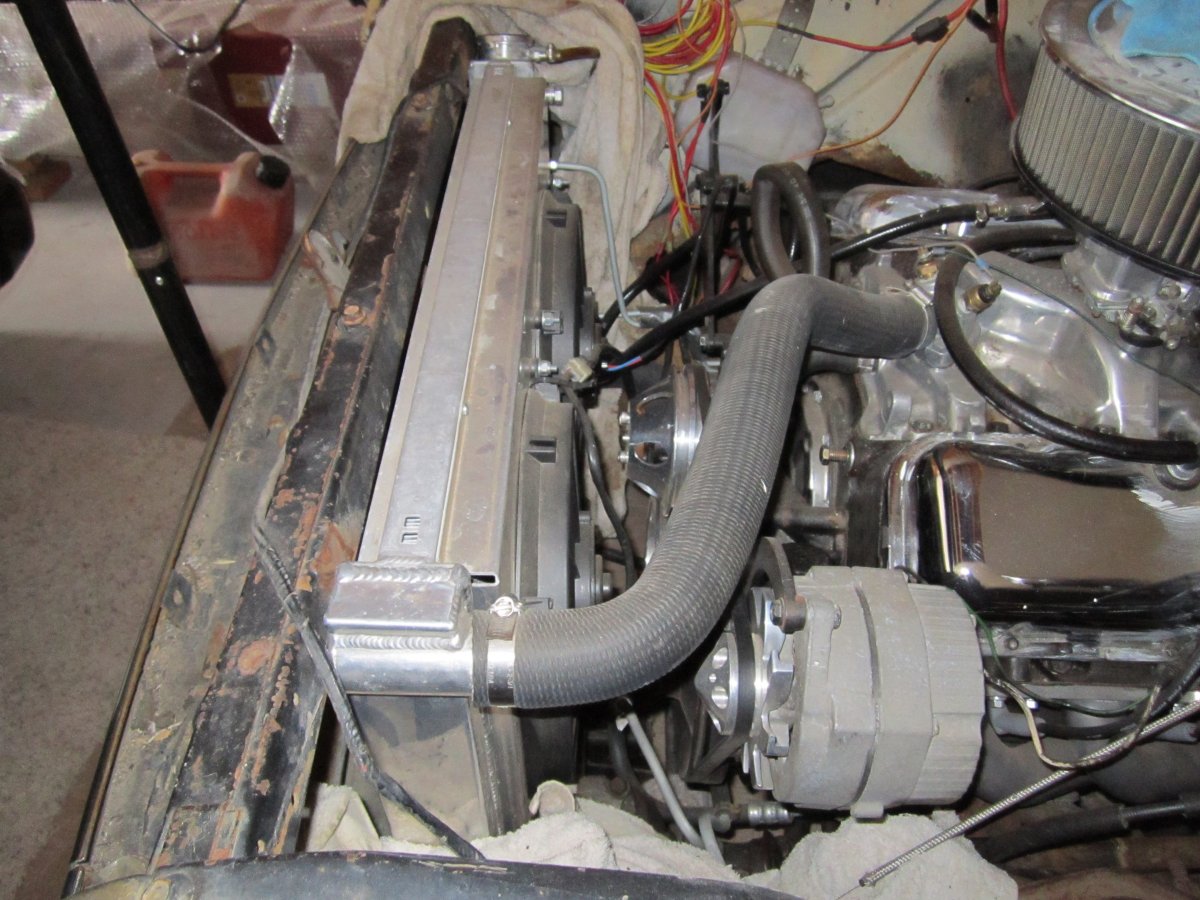

    Has anyone ever fitted a crossflow radiator in a 57 pickup or have any design ideas for mounting panels/ brackets? I found a couple random pictures on the web, but not sure how the insulators stay in place or if I should use aluminum or steel. I would like to have flat metal on the top to cover up the top of the core with some kind of rubber underneath to hold it. Also unsure what the bracket(s) should look like for the bottom.

    I put a 427 in it so it needs as much cooling as it can and like how crossflows look. I like all the ideas, I was thinking about welding aluminum plate on the sides too, but was thinking I should insulate it and cover the top of the core at the same time. Maybe I weld plates on the sides to hold it and make a flat cover for the top is the best idea.
    The radiator I have is out of a 75 c10, the stock hold down plate isn't completely flat and pushes the radiator closer down to the power steering box.
