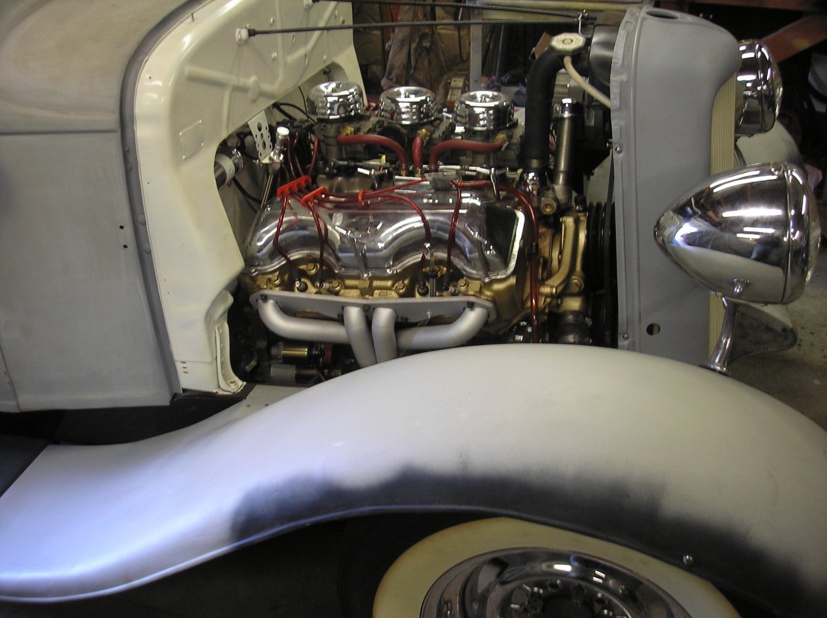

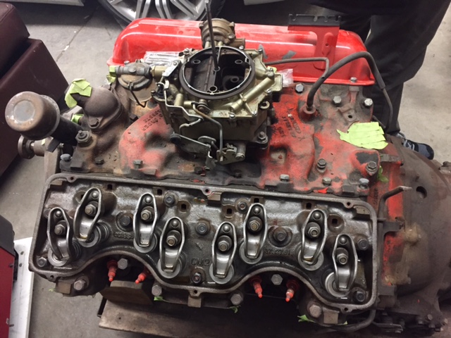

  25. '37-4D
    Joined: Dec 12, 2016
    Posts: 221
    '37-4D
    Here it is as I purchased it.
    MOTOV8N and saltflats like this.
  26. Fordors
    Joined: Sep 22, 2016
    Posts: 7,047
    Fordors
    Looks like it came without a distributor, just so you aware the 348-409 uses a distributor with a different length than a small or big block. Also, is the oil pump drive shaft there?
    '37-4D likes this.
