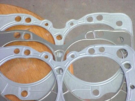

    from the web FWIW:
    There was an early casting of the 872 block ( before approx Feb/March of 58) that did not have the sparkplug cooling and the later 872 casting which had the provision but the block cooling p***ages were not drilled.
    Pics of the different gaskets
    409 on top
    58 348 in middle
    59-61 348 on bottem
    Notice the hole size difference between the 58 gasket and the 59-61 gasket
    '37-4D and Countn'Carbs like this.
