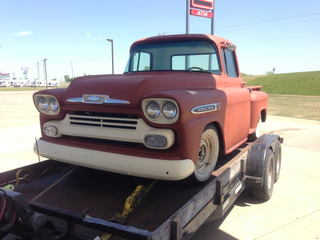

    On our way to Dallas!!!
  5. chaddilac
    Joined: Mar 21, 2006
    Posts: 14,077
    chaddilac
    Looking like a fat girl on prom night!!
  6. 1959apache
    Joined: Nov 22, 2009
    Posts: 2,635
    1959apache
    Are fat girls usually on trailers for prom night?
    Looks good :D
  7. chaddilac
    Posts: 14,077
    chaddilac
    Yea after they've been rode hard!! :D

  9. Shane Spencer
    Joined: Oct 3, 2009
    Posts: 2,160
    Shane Spencer
    Lmao^^ here comes the meatwagon. Truck looks good guys
