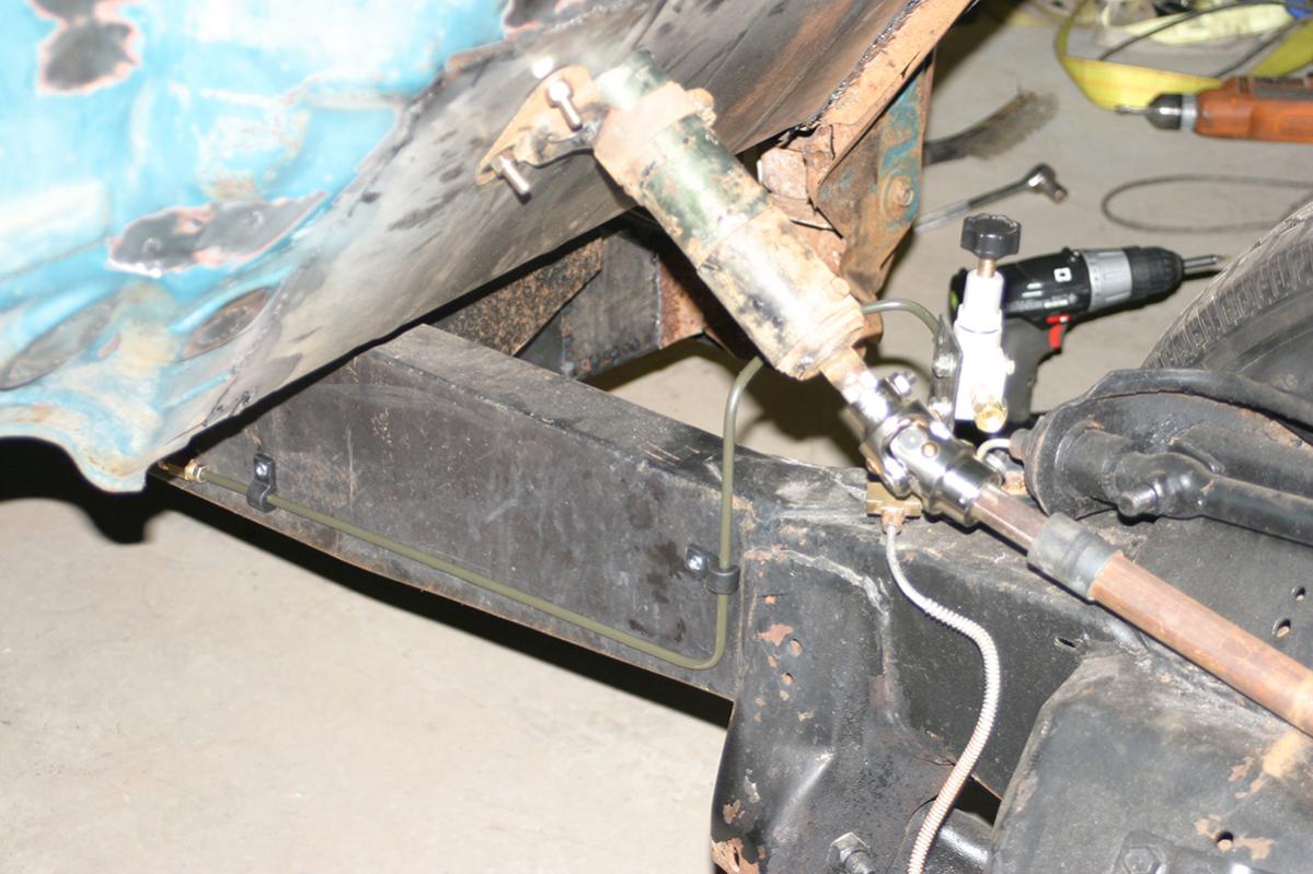

    Can you take a picture of your proportioning valve for us? I'd like to see how you have your lines running in and out. It sounds like its providing more pressure to the front brakes than the rear causing a line lock of sorts
  14. chaddilac
    Joined: Mar 21, 2006
    Posts: 14,071
    chaddilac
    Here's what I got from when it was here....
