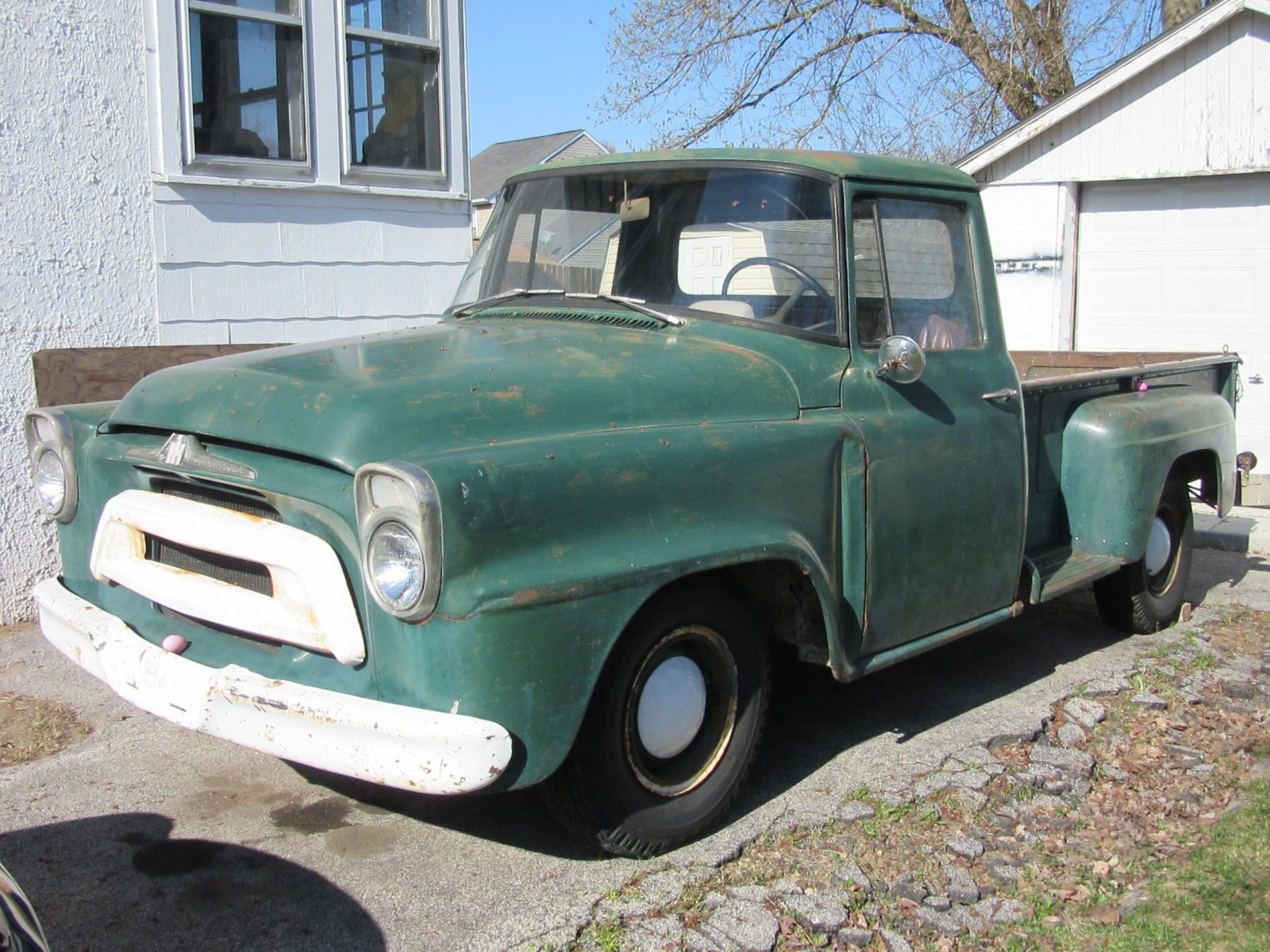

    1958 International Harvester A-110 pickup. It's gotten to the point where it isn't any fun to drive anymore. Always runs great, but stopping and steering is ***-puckering at best, even after some major going over.
    So I'm upgrading a few things, but hopefully without losing the old work truck feel. IH rebuild services and parts are either very expensive or just plain obsolete as you can imagine.
    So I'm starting with steering. Lots of creative setups on similar Ford and Chevy trucks of similar vintage, from Toyota box to R&P conversions. I think I've decided to tackle a cross steer type setup using a Saginaw 525 box and losing the sloppy (Ross?) box and drag link. Searching the web sent me down a rabbit hole that pretty much brought me back to the H.A.M.B. and popular g***er steering idears.
    Lots of space (relatively) behind the oil pan and axle, so rear steer is likely. Found this pic that most resembles what I'd like to do:
    Of course I don't have a source for a steering arm with the 2nd location for a drag link (like above) but I have seen the 4wd guys using a Jeep style tie rod end like this:
    This kinda makes the tie rods into a "Y" configuration instead of being parallel. Is that a problem? My Saginaw box will need to mount at an angle suitable enough to allow for me to catch the column that I will be cutting at the firewall to install a short "D" shaft and Borgeson universals similar to the setup above.
    Am I overlooking any shortcomings using the Jeep style tie rod end? How does pitman arm length and angle affect correct geometry here? Advice/insight/pics appreciated...

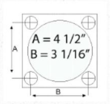

    On a tip from an old, old post on one of the IH forums, someone in a land far, far away said he bolted up a set of those flat style steering arms DIRECTLY to the spindles on an IH pickup. What? Crazier **** has happened. Without digging into my hoard for a pair of 49-52 Chevy spindles, I hurriedly pulled some dimensions from the web for both the Chevy p***enger car spindles and 41-68 International light duty pickups...
    I'll be damned... within a 1/16 of each other!!
    Can only Heim joints be used with these flat style steering arms? Adjustment for Ackerman? Found plenty of (forged?) arms for cross steer on early Ford spindles (to use ball style TREs)... has no one ever made similar steering arms for the Chevy spindles?? That seems crazy... even I have a set of Chevy and Ford round-backs in my hoard and I've never owned either!! Regularly driven... I'm more inclined to stick with ball style TREs....?????
