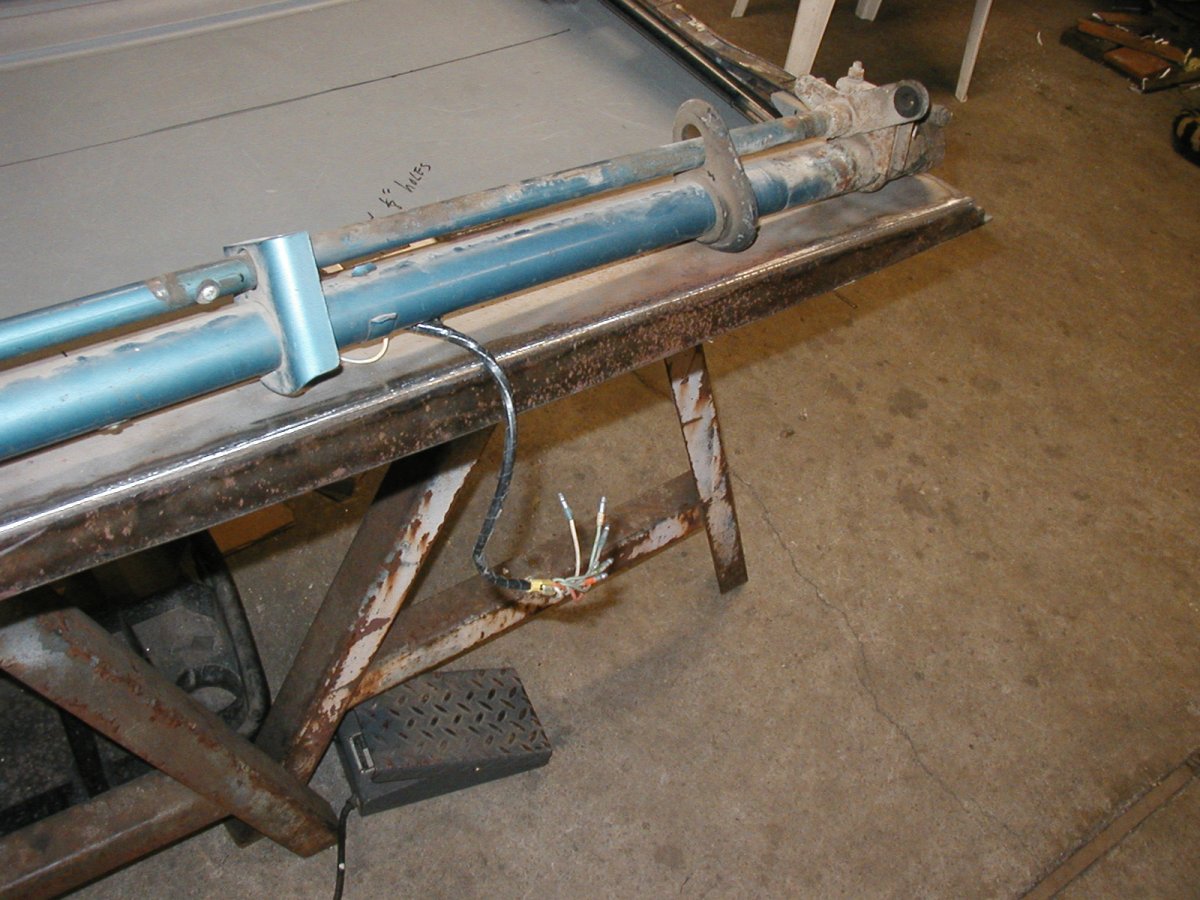

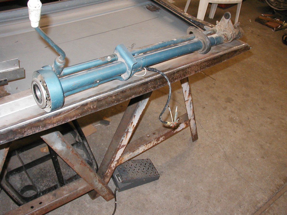

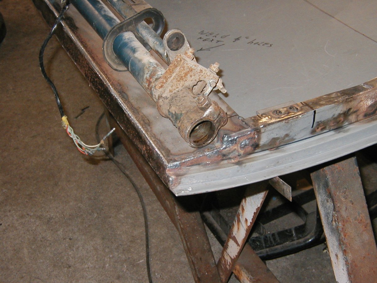

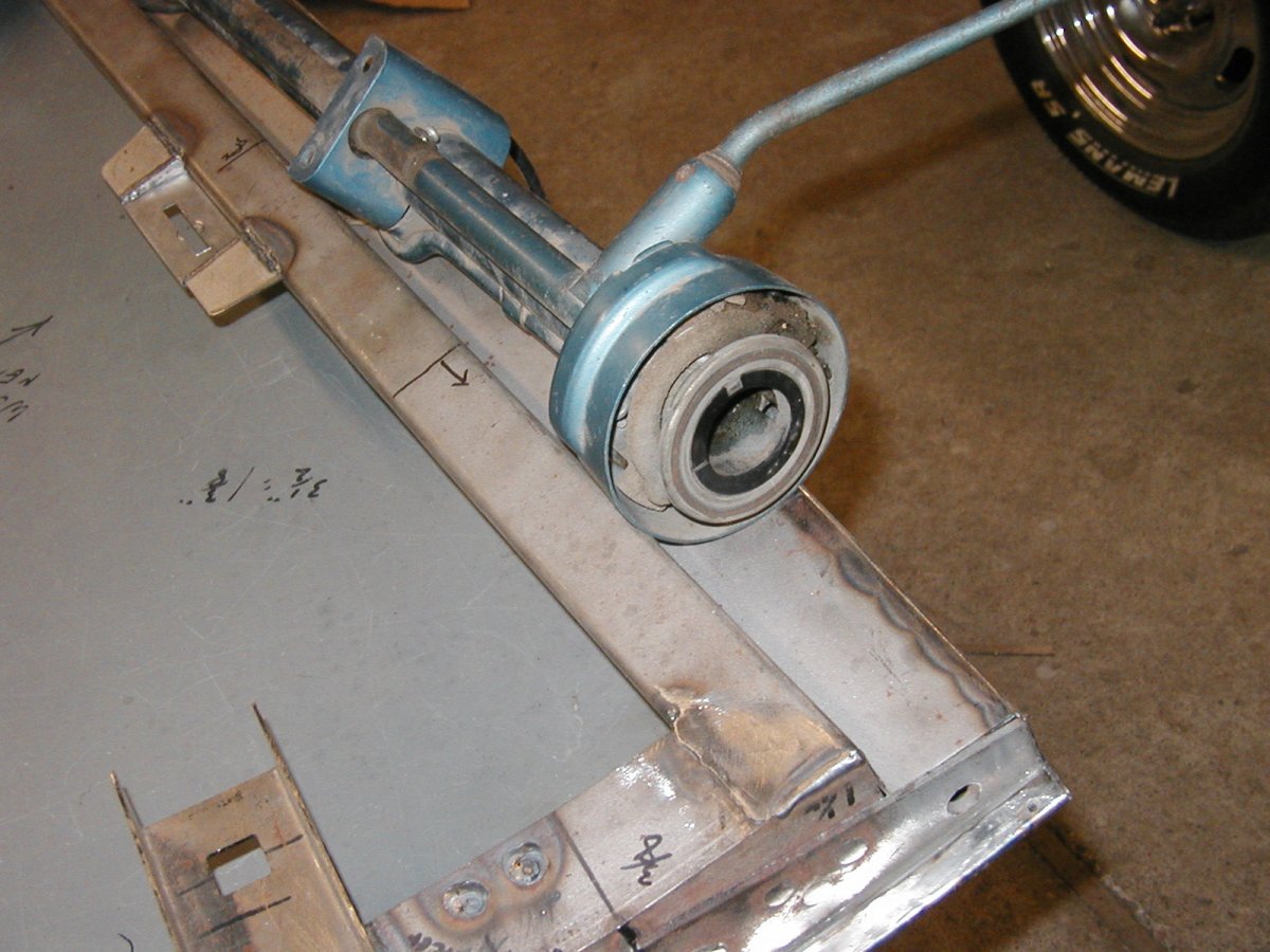

  7. Quite a bit different than the Ford family. I'll get you some photos today and post up latter. Will also include length measurements. I can tell you the under dash mount and gear box mount will take some mods to make bolt up. Don't look difficult though.
    The Wizzard
  8. That looks more like the later Ford/Mercury columns, say '63ish-69. If the outer tube diameter is the same, you may be able to mash something together using a later column or just use one intact.
  9. So, 57-58 & 59 outer jacket total length is 32 1/2". Steering wheel base to dash mount is 10" From steering box mount to firewall is 7 1/2". The 3 years will interchange but the signal switch is different for 57. It was the last year with a horn wire that went through the steering shaft. 59 and 9 had the horn wire follow the signal harness. The dash mount bracket will slide on the tube and is of Crimp style when bolts are tightened. The base of the tube slides over the top bearing retainer on the box and again crimps with a band to hold in place. The gear indicator is a pointer mounted to the selector shaft and the Crown is in the dash panel above the column. P1010362.JPG P1010363.JPG P1010364.JPG P1010365.JPG
