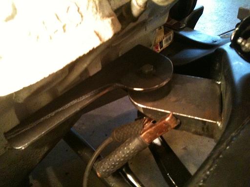

    Here are the motor mounts.
    I *just* got done welding the motor mount perches to the frame.
    Someone asked me to post photo's,so here they are.
    I mocked the engine up with Ram Air Restoration RAIII manifolds, and they clear the steering box,but it's tight,and I had to trim the upper control arm near the bushing on the passenger side just a little.
    The mounts on the block I made from 3 1/2" C channel, and trimmed 1 side off, making it look like a letter "P" when looking down, or a reversed "P" on the driver side. They are 9" long and will have a dual bolt pattern drilled to go on both old, and newer blocks.
    The frame perches were made from 3" C channel, and I rounded the front near the rubber mount.
    The rubber mounts are some core support bushings I had for an "A" body, and I made a hardened steel bushing/sleeve to go between the block mount and perch. If this rubber is too squishy, I have some hard durometer rubber at work that I can make some new ones from.
    That's all for today, making the trans mount/cross member is next.
