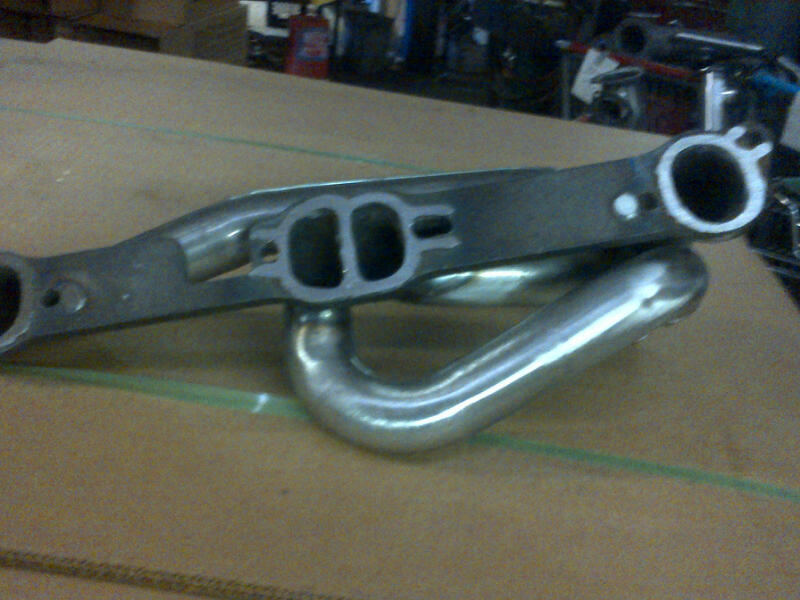

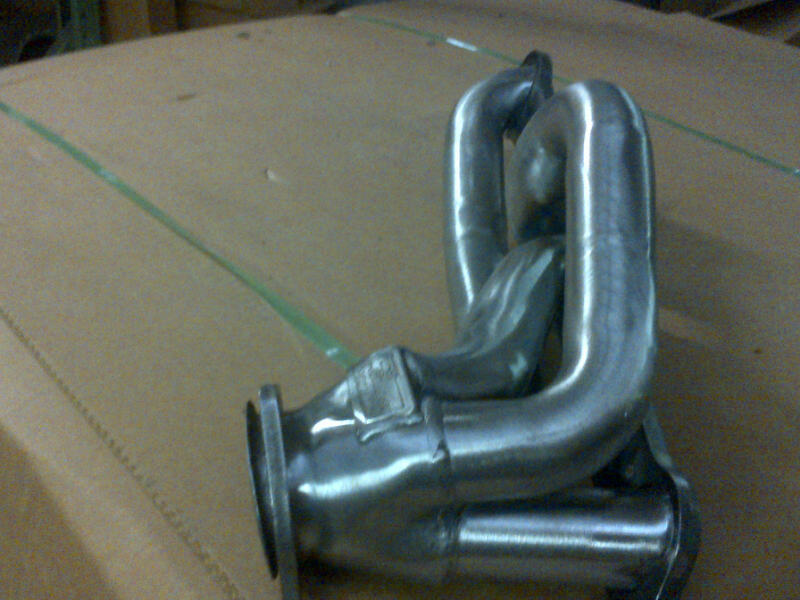

    These are the Sanderson shorty headers for 67-69 Firebird p/n PF-1
    If someone has a set of these, I could really use a picture of the driver side header from the top bolted on the head to gauge how far the tubes come off the port.

    I'm not trying to get into a pissing match, I simply would like to see a pic of the sanderson headers from a different angle/view to judge how far the tubes come off the ports.

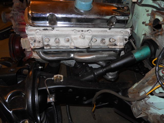

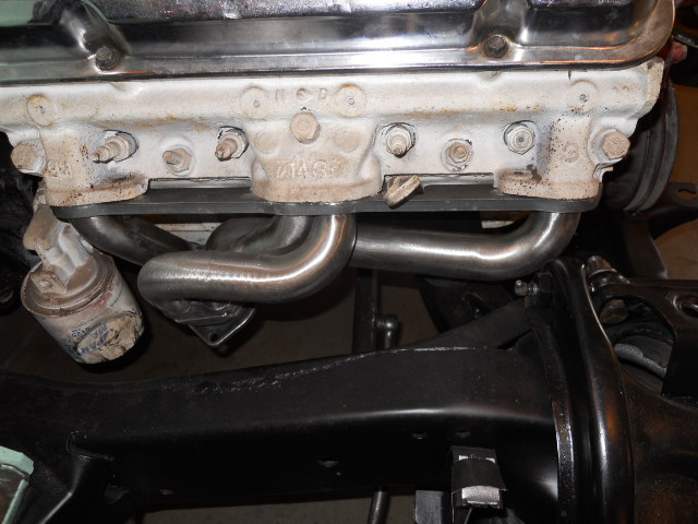

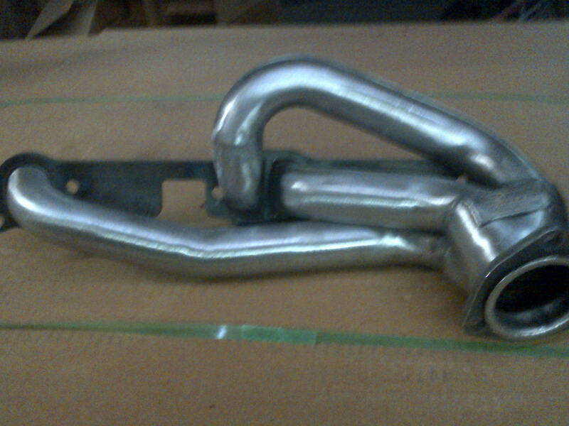

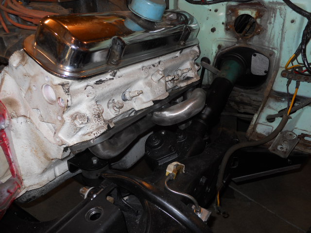

    Here are the pics of the Sanderson shorty's.
    I simply called them and asked for some pics of the driverside header from a couple different views.
    I think they will work great with a good deal of clearance.

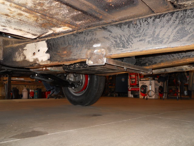

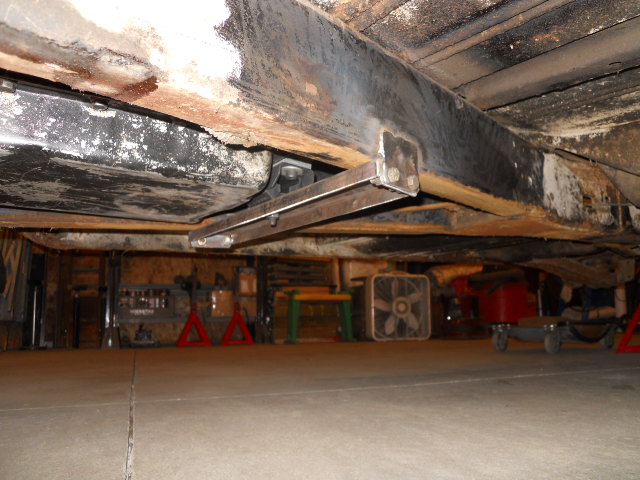

    Bought the Sanderson headers, made the trans cross member, and modified the trans tunnel to accept a 1 piece shaft.
    Shift linkage made and functional, now it's time to open up the engine and get this thing ready to go.
