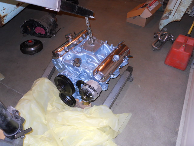

    A little behind schedule on where I wanted to be with the car.
    Finished the brakes up today, minus bleeding.
    Rebuilt the 4.30 Safe-T-Track with parts from Fab Craft, got it back together and wrestled this dump truck wannabe rear back into place.
    Boxed the lower rear control arms.
    Engine will be together this week.
    Just need to order my 57 chevy gas tank, and figure out a radiator that will fit, make an exhaust system, and finish this thing up.
    I'm getting spring fever, lot's of old iron out today in the nice weather after a LOOOONG Winter that didn't want to let go.

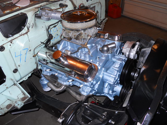

    Engine was set into place today.
    Ordered a radiator from engineered cooling products, nice all aluminum, american made. Had to do a few modifications to the radiator support to make it work, but I think it's going to do the job.
    Ignore the ****y looking air breather, it's just there to keep anything from getting into the engine.
    Still need to get the gas tank and figure out the exhaust, but I hope to have it running in the very near future.
