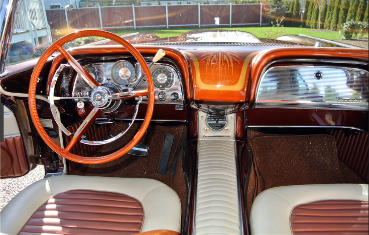

    I was wondering if abyany has ever put a 1958 T Bird Dash into a 48-51 Ford F series? I know it's not just gonna bolt up as is. Anyone have dimensions of a 1958 T-bird dash? I have access to a Ford truck for measurements. Like to know what I'm in for.
  2. The critical measurement will be the T-Bird dash depth... This is a very 'deep' dash, with nearly 12" from the windshield to the furthest point out on the dash face. Compared to the truck dash depth of about 4", that leaves a lot of dash sticking out...

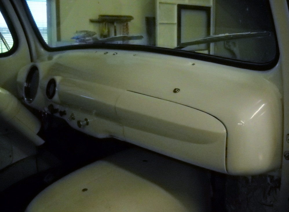

  13. I grafted a '49 Ford car dash into my '51 Ford COE. Had to narrow it a bunch, those cabs are really narrow at the dash.
    There are several dash swap threads on here if you search.

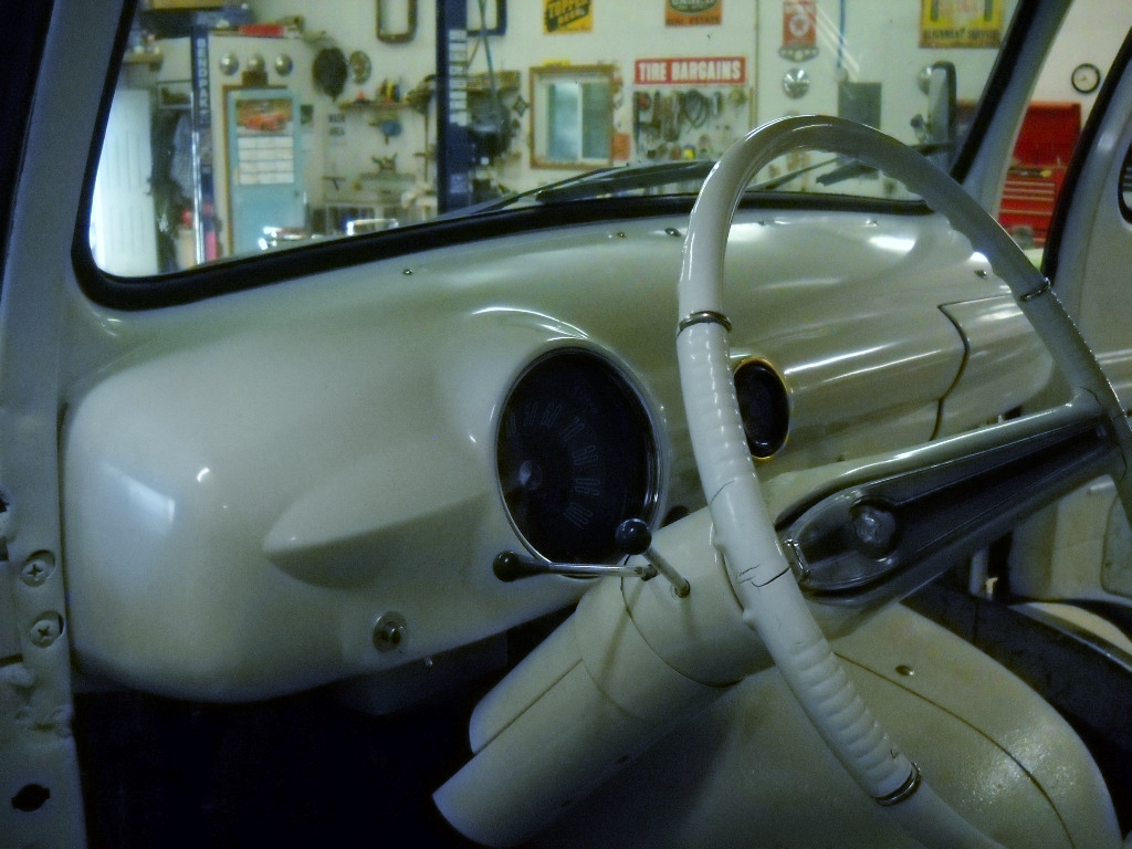

    I had a '53 car dash I was going to use but decided not to.
    Here's mine, still in process. I mirrored the left edge of the stock bezel and just enlarged the opening. I also filled the radio opening.

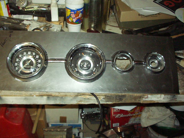

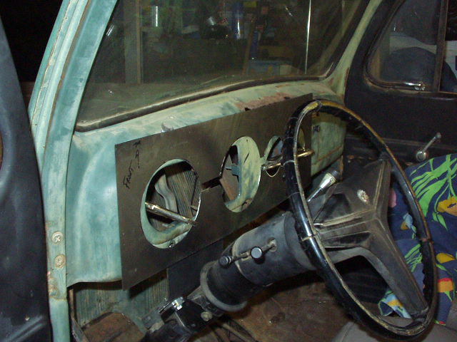

    Anything is possible. I swapped in a 56 Packard dash into a 58 Packard. Lots of cutting and fitting to make it work. Like others have said, the biggest issue is the depth of the 49 cab, there just isnt much room there. What about just using the cluster?
    My original plan with my 49 was to graft in the cluster from a 58 Pontiac. I made a start on it way back when but haven't gotten around to actually cutting on the truck. It's still on my "to do" list.....
    ...someday...

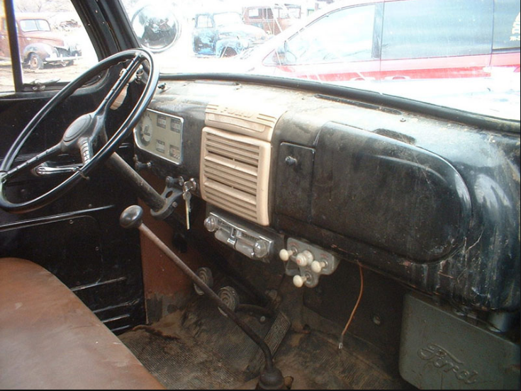

    Here is what I did with my 48 F1
