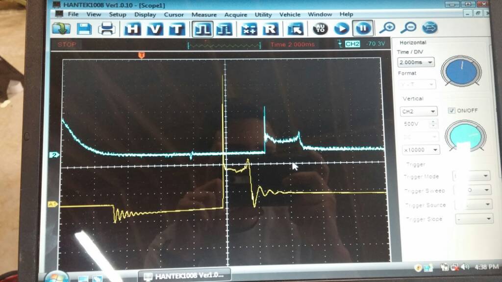

    Alright, thank you all for the patience, the car is generally a weekend project so that's when I will have the most new info, we recently got a new oscilloscope for an unrelated project, and got some readings from the bird when it is hot, the yellow line is the example waveform provided for vehicle ignition provided by the company who makes the scope, while the cyan is the reading we got. Ocaissionally the waveform would wander left and right, even with the trigger and the timeframe remaining the same. The two attached photos are of the coil and cylinder 8 when hot, the coil is the one that matches the template wave form better, aka, the spark looks UGLY on cylinder 8, any new ideas?

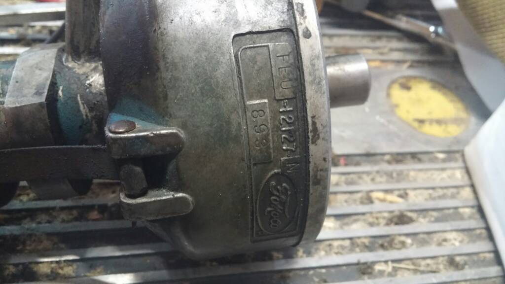

    New distributor is in the car, but even with all my measurements the gears didn't mesh until I tried to start the car and now the timing is off. Tomorrow is fixing that issue and finding TDC for cylinder 1 and aligning the distributor to match. Attached are pics of the old distributor and the new, when you turned the shaft you could hear the bearings grinding against one another, and it wears a ford badge, and the diaphragm for the vacum advance was in VERY poor condition, which leads me to believe the distributor was original to either the engine or the car.

    Thanks! Yeah, once I found out that was how you adjusted dwell to a point on that ignition I definitely messed with it, but on the scope it is showing good spark at all temperatures right now.
