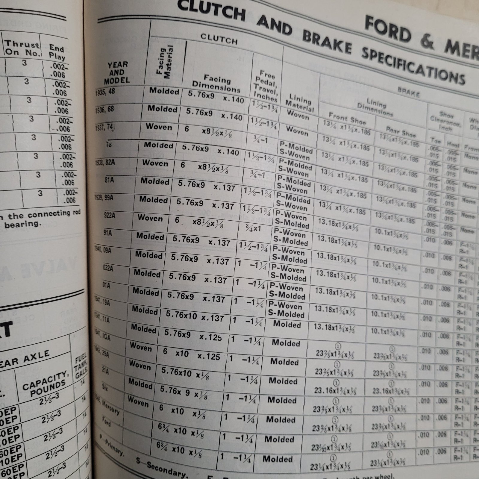

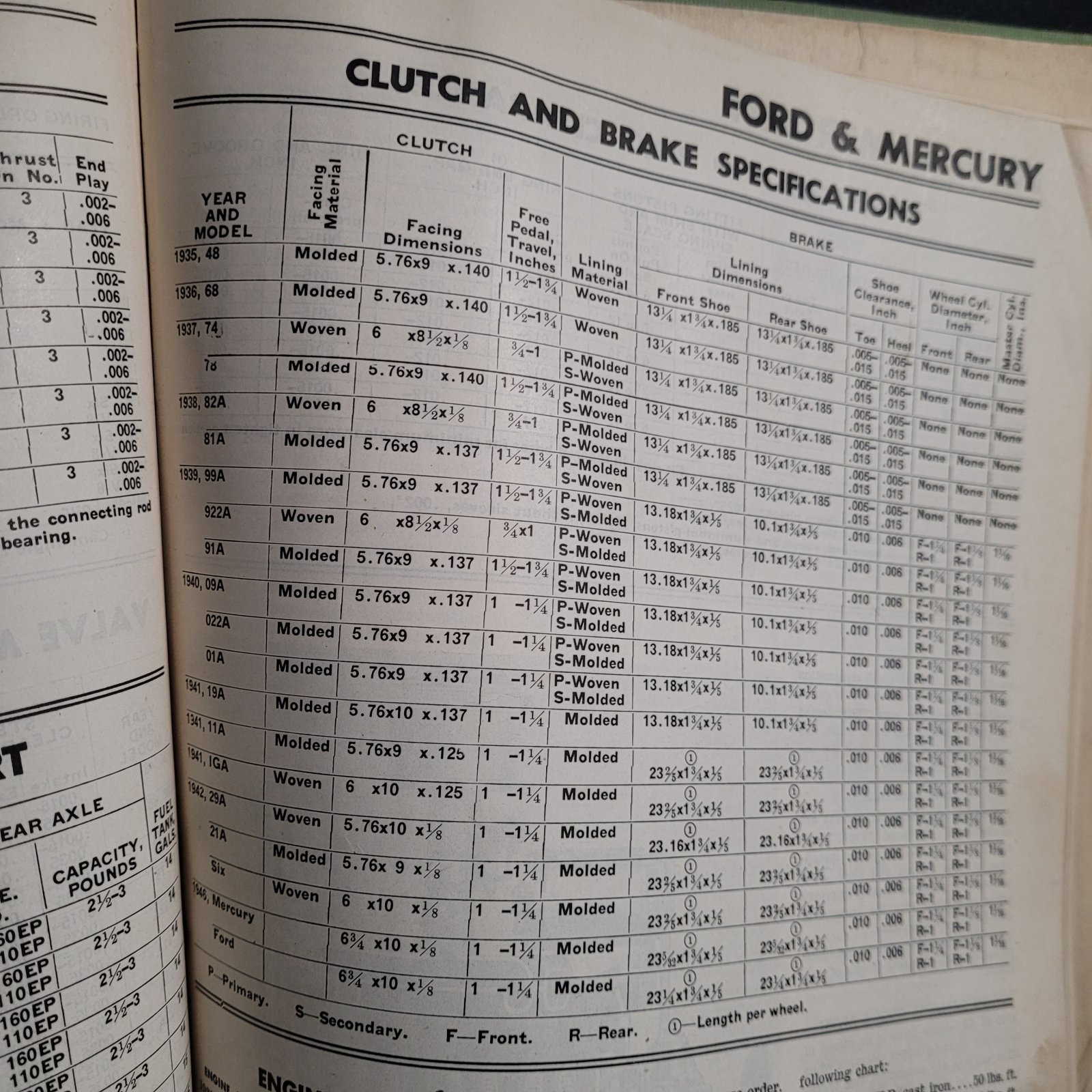

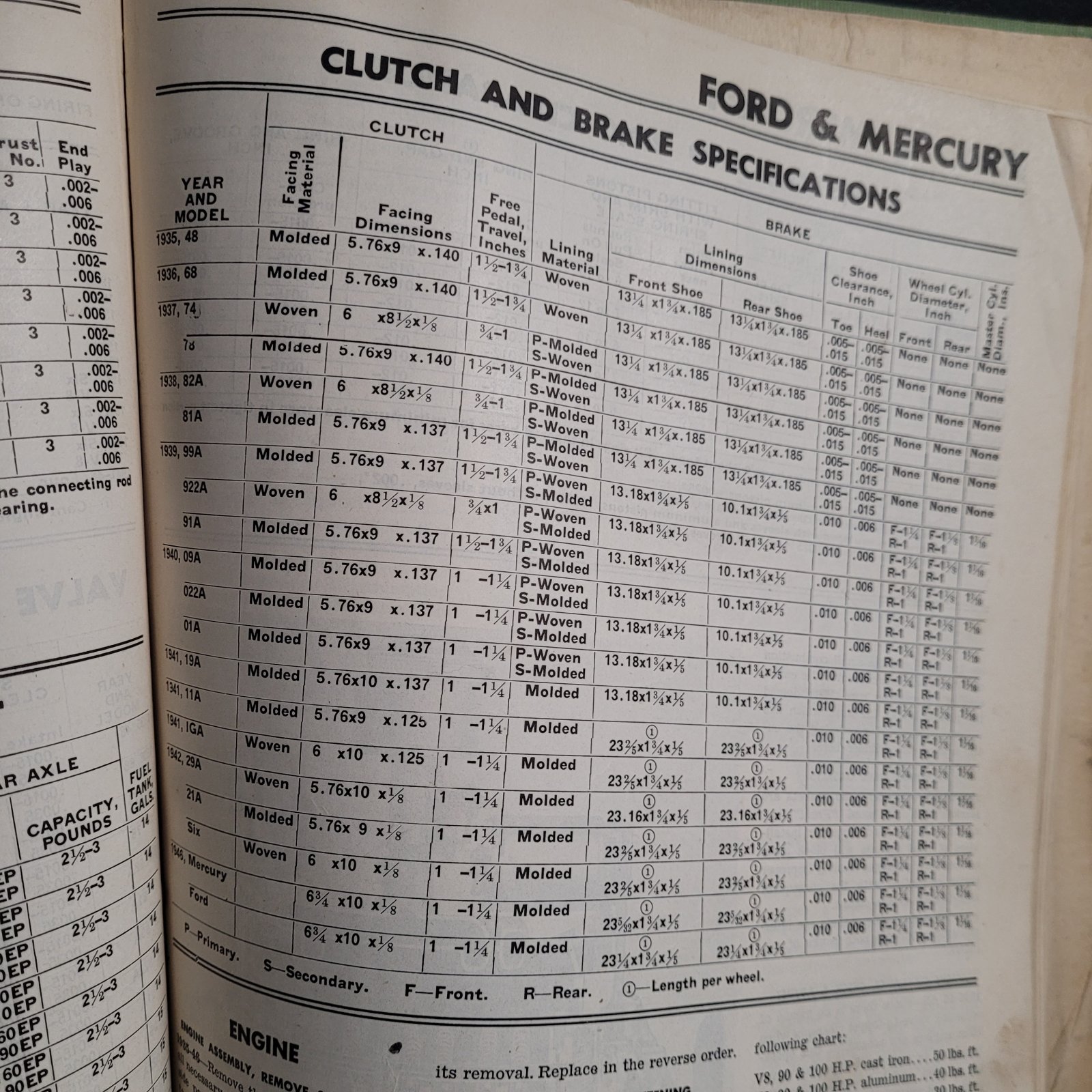

    20210804_220326.jpg 20210804_220321.jpg 20210804_220316.jpg I took three shots of my 1946 motor manual Ford clutch spec page.i can't tell which one is best on the phone.I
