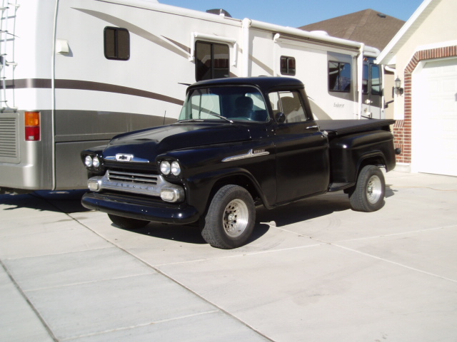

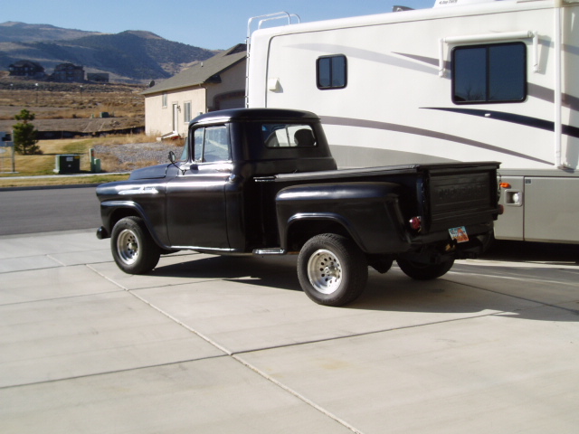

    This is how the truck looks now. A little rough around the edges, but it's just what I was looking for.

    Here is my 58. I just bought this 4 months ago. I would like to lower the front a bit and the rear quite a bit. It has 275/60R15 on it right now. I have a friend in CO that has the same year as mine and he is running 50's on his.
    If you are planing on changing out to different lugs then I would just run what you have till you do that, or pick up some cheap used rims and tires. Save the money for the upgrades.

    could you try to get a better picture of the wheels that are on the truck now? I can't tell what they are....point being that if they are original, they're pretty skinny, but if they're later model wheels then they might be wide enough to use. It's pretty easy to spot them if you know what to look for, but not easy to explain it.

    Squirrel, to be honest, I didn't even look at the wheels real close to see if the are the original style. I ***ume you are referring to the wheels that have the metal clips for hubcaps? I brought the truck home on a trailer, put it in a friends wharehouse, and due to work, haven't been able to do anything with it since. I have some days off this coming week and plan on pressure washing it, checking the brakes, changing the oil and filter, etc.
