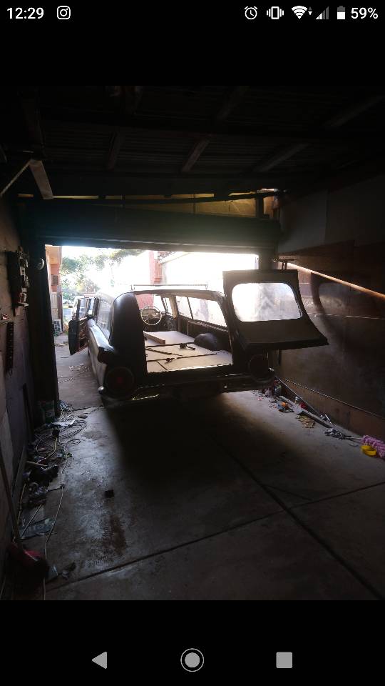

    So i haven't actually posted anything about the old girl here since ive gotten it, but instead ive just kinda been in the shed going gun-ho at it the past 5 months!
    So from the start - late December. I got a call from the drummer of my band saying 'check out this pos, you should buy it for s***ts n gigs haha'
    Immediately when I saw it i thought 'Thats a smith'
    Smith He****s were made in Sydney back in the day and were upper end, long wheel base, full coach built bodies and thus, very rare. Ive been after one for ten years.

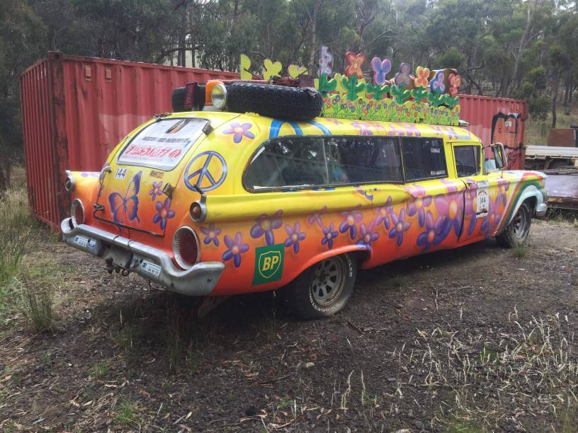

    Anyways, i saw it and it was an ex variety bash car (Variety bash cars have to be atleast 30 years old, modify it to be an all terrain and drive across the country to raise funds for charity)
    Being an ex bash car, it was painted stupid, gutted to have seats, TV's, roll cage, aircon, 50 tonnes of mold and rat s*** and even a few condom packets haha. The smell was atrocious.
    So, i bought it as is, took it home and started the tear down. Heres the sorry girl when i started.
    *apparently there's only 3 of these made by Smith. My buddy in a band called Wild Turkey has the other with the difference being its a hatch rear
    Ill update more in the next post.

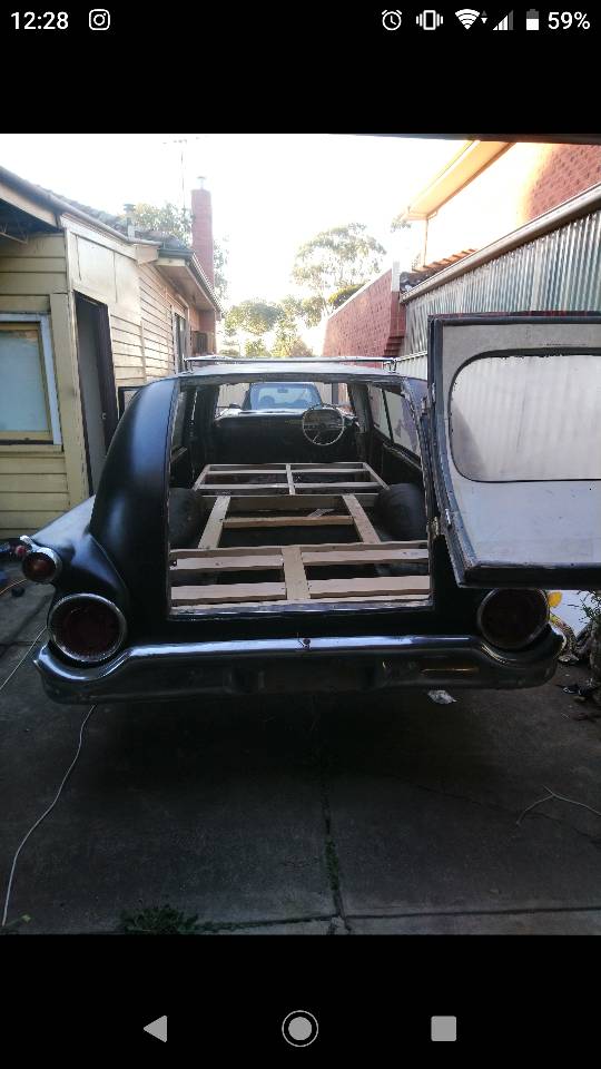

  16. Okay so if you're really keen you can view on browser & all the progress pics will show. Heres what ive been at the past week, rebuilding the coffin table. Note the battery box door ive cut out to sit behind the driver and under the table, making otherwise useless space useful.
    I also heated up some perspex to make a new rear window. Originally, Smith used whagever to make the rear windscreens outta gl***. The rear windscreen in my mates is an upside down XK Ford windscreen. Useless to me since mines got a door & his a hatch so ill figure the right gl*** to cut up one day.. For now i can see with this.
    Making the dividing wall was a lil tricky but more so a time thing than anything. I made a template for one half of one side of the top half of the wall, above the window and the made 4 pieces, worked well. I did the same for the sides of the window also.
    Using red automotive carpet & it looks sweeeet in person, darker, almost a burgundy/maroon. Also got some wood I've been varnishing for all the edging.
    Oh, and i dropped the rear 4 inches!

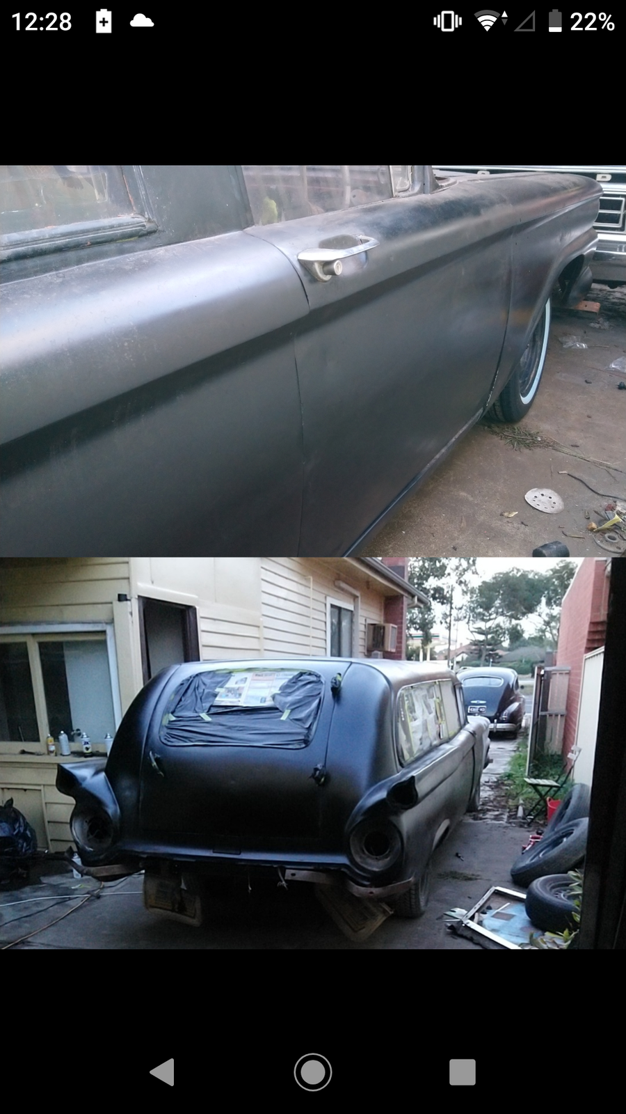

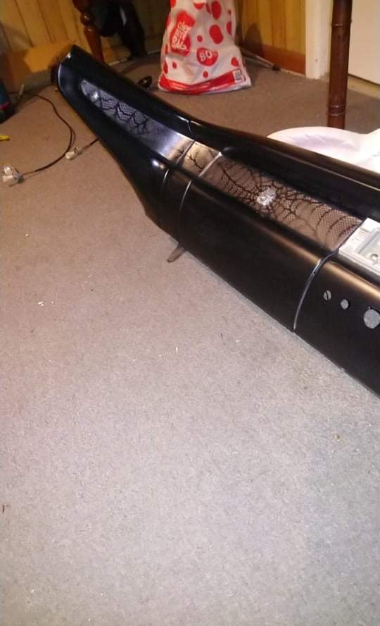

  20. Fitted wheels n finished off the rear end interior. Rebuilt front end with new brakes n cut a single coil off the front. Refinishing the dash currently and test fitting the seat but otherwise its coming along!
  21. Not much exciting n new. Rebuilt the rear brakes and removed n cleaned the diff centre, new oil etc. Aligned the driver's door since it was waaaay off, so that'll do for a pic update! I actually also refinished the dash too now i think of it. Hard to getta good pic, that'll come when i finish the drivers compartment! Dash was originally grey n ******ed.

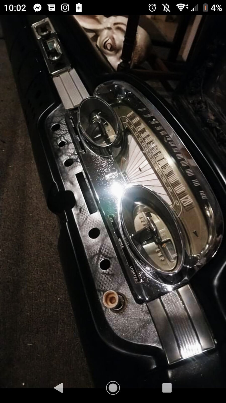

  27. Also picked up n fitted a 59 Edsel Cluster - the little details!!
