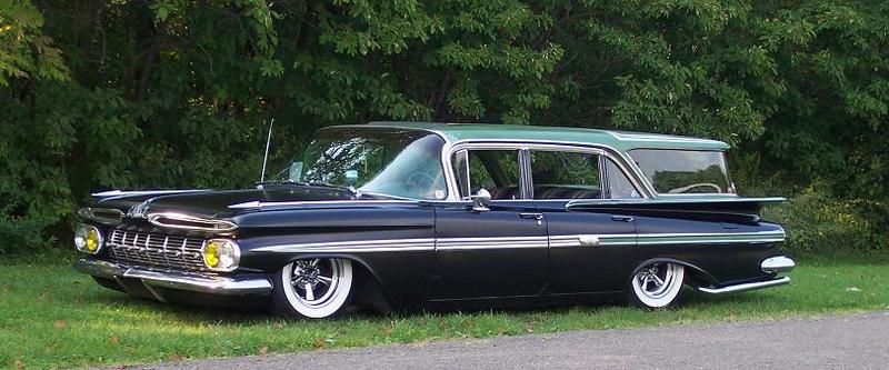

  1. Ok, this thread will get some flak as a friend has found a '59 Chev 2dr wagon. The owner claims it is a real Impala as the military ordered some for it's higher up's that year..so COPO's. The others were Brookwood's but how to tell the difference as trim swaps are easy?
  2. this thread is totally useless with out pics military vehicles are almost allways strippers so im doubting the impala
  3. Damn, thats nice, but I'd like to see it when/if military.

    Definately not useless.
    Nice looking car, I dont know if i'd beleive its really an impala never heard of a 59 Imp 2dr wag but who knows. very nice looking wag !
  5. I brought up the very same car on another thread here recently and most said I was full of **** .... I have saw that wagon before listed on e-bay in the past and the seller was going with the very same story there and if I remember correctly he has the original purchase order and delivery invoice to back up his claims .... sure is a nice looking wagon.
    Knowing the military train of thought I guess its possible but I would sure like to see the validation.

    If it was a real impala (nomad), gm would have put chrome trim around the windows. the "impala" trimmed 4 door wagons were called nomad, not impala. all the wagons had different mames than the p***enger cars, brookwood shared the biscayne trim level,parkwood ,the belair, and nomad ,the impala.There were no nomad 2 door wagons.
    it is likely that the original purchaser ordered some impala trim and installed it himself, because he liked the look.... It is even more likely that whomever restored the car installed it because they thought it would be neat , and now it is "real" because it exists....

    Also the jailbars in the tail lights, note the 2 door car in question doesn't have them. And even if it was the real thing, it's been all street-rodded out anyway, ruining any collector value it might have had if it was real, which it isn't.

    agree with the rest that isn't real. but it is nice.

    I'd like to see the vin numbers on the car to see what it shows up at...Notice I said numbers? Anyone can do a quick vin swap with a rivet gun but what do all of the the vins say?
  13. ****, all the **** that gets added/subtracted to the new cars at the dealership I work at, I wouldn't have a doubt that some dealer added Impala trim to a wagon and sold 'em as 'Specials". Eye candy to draw in the unsuspecting.
    And I bet I could come up with a better story than the 'military' one.

  14. Those "jailbar" taillights were standard on Nomad wagons (only made four-door) and optioned for wagons and ElCamino .... my question would be did it come from the factory like this or added later .... putting two door bel air or el camino trim on a parkwood (2-dr wagon) is not that uncommon (read this http://www.streetrodderweb.com/feat..._impala_biscayne_brookwood_wagon/viewall.html )
    .... like I said earlier, nothing surprises me from the military but I would want to see do***entation to know if the car was ordered this way.

    I've learned with old cars to never say never. BUT, I'd need to see the cowl tag. That would end all debate.
