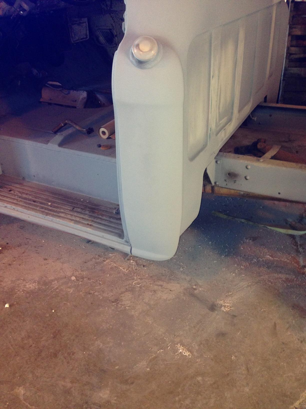

    finished both cab corners the re stamps made that real easy got some color on its a 30/30 paint job but I plan on using this truck.
