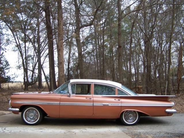

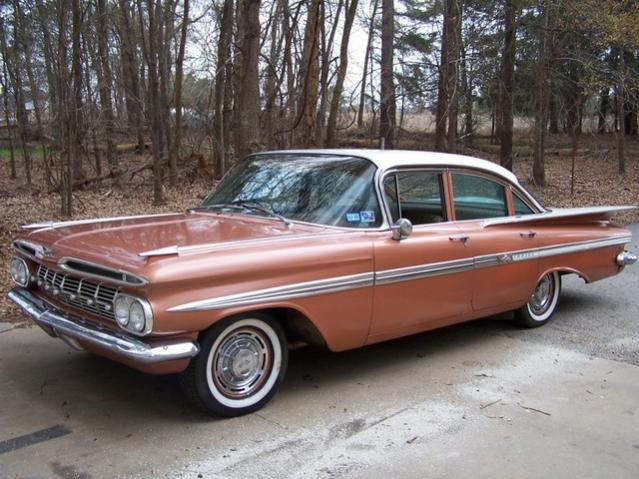

    impala 4 door sedan: mainly just a trim package, all major body panels and gl*** will interchange with the belair, and biscayne 4 door sedans-
    ** I'm curious abou the canadians, they might have prod. figs for them..., and I do remember on our trips to canada for 567 conventions the abundance of 567 210 2 and 4 door hardtops up there, seems like canada got more of the lower end trim packages***
    some pics of some 4 sedan , and 2 ht, I will try to get some more shots up later.
