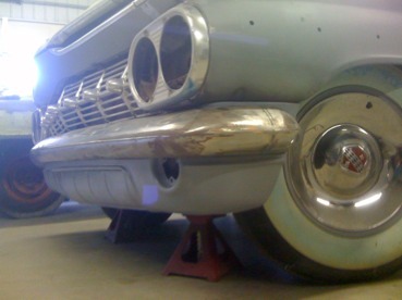

    Thanks , yes it does now i cant wait to see what the lower valance looks like in primer when i put it back on the car, Iwas debaiting on chroming it but i think my chrome bill is already going to be a little high .:eek: so i just primed it

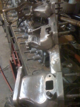

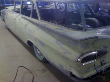

    Monday update time again , so in the past week I've been working on the intake a couple hours here and there in the evenings, and today I put the primered parts back on and bodyworked all day today again, the talegate and the back part of the quarters ,, and the tops of the fins are ready for slick sand .

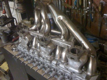

    Thanks guys, now back to working on the intake for the rest of the night .

    Yet another Monday update , today I spent more time body working the left side of the car , installed the door popers and I've been working on the intake somemore in the evenings .

    Intake coming along nicely, like the door poppers.....Jim

    thanks , im glad the modification to the intake is about done :eek:

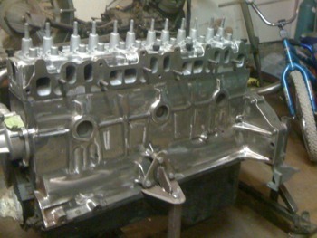

    Another Monday update , so I've finally got done all the modifacations done on the intake , I took off the orgainal head and swaped in the 12 port last night , and ran into a little bit of a proble with the valvecover adaptor and the new head but that's all part of building hot rods and kustoms , but I guess that's why I like mocking everthing up . Also today I put in the front seat for mock up , since the last time it was in the was over 5 years ago and the seat bracing and floor were pretty much rotted out I rebuilt them but never had the chance to throw the seat back in to drill the holes in the floor , also I spent the finishing up a lot of loose ends ,
