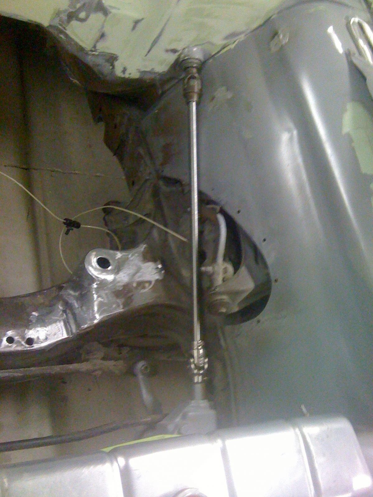

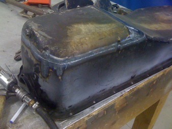

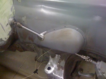

    Monday update time again , so in the. Past two week I got the steering shaft and the powergen in the mail, I set up the steering , modifyed the controlle arm cover for the shaft to go threw , I also shortned the oil pan 1 1/4" since it was hanging below the bottom of the crossmember , I also started taken the powergen apart to shorten the rear part of housing and to get rid of th powermaster logo , today I did a lot of filler work on the engine comparment and, I also sent the head out to get a valve job , porrted , and milled ,

    Cody, everything is looking great. One question I have is with shortening the oil pan will you have any problem with having enough oil for the engine? I know you have thought this out, just need to know.....Jim

    ive seen guys run 250 oil pans on 292 jim and had no problems and this no shorter than a 250 pan , i could have just bought a 250 pan and threw it on there but i just decided to shorten it and put the money into some thing else on the wagon :D
    thanks mike, i keep looking at it every day when i go into work and think yah ive hit the chrest and im on thoe downward slope , then other days i think how much i still have to to before oct 20 :eek:and it makes me think im time im still climbing getttin no where :confused:, ill feel much better when i get the body off the frame :rolleyes:
    thanks j , with the channeling , this has been the 7th car ive channeled , and by far been the most challenging , the 6 cylinder didnt make it aney easyer to do and adding the mc gurk valve cover added a couple more inches over the stock 292 valve cover , i know you guys cant see it from the pic s but the hood and the hood's inner structure also has more crown in it than the stock hood to clear for the engine , so the motor can go up aney more or down and more because of the motor hitting something ,

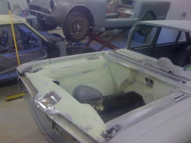

    Nothing exciting today guys , i spent the whole day sanding slick sand ,

    Its these long hours spent blocking out primer that make a nice paint job. Is this your first primer coat or do you have more to go?

    yah it does , ive lost track of hours sanding but i know its been a lot:eek: , this is my first primer, and actually all the time i spent before is paying off now , there a lot of little things but with a car this big i guess that to be expected , but over all im pretty happy with the way it turning out , , ill prime it one more time with dp-26 (a 2k) primer and it should be good to go.
