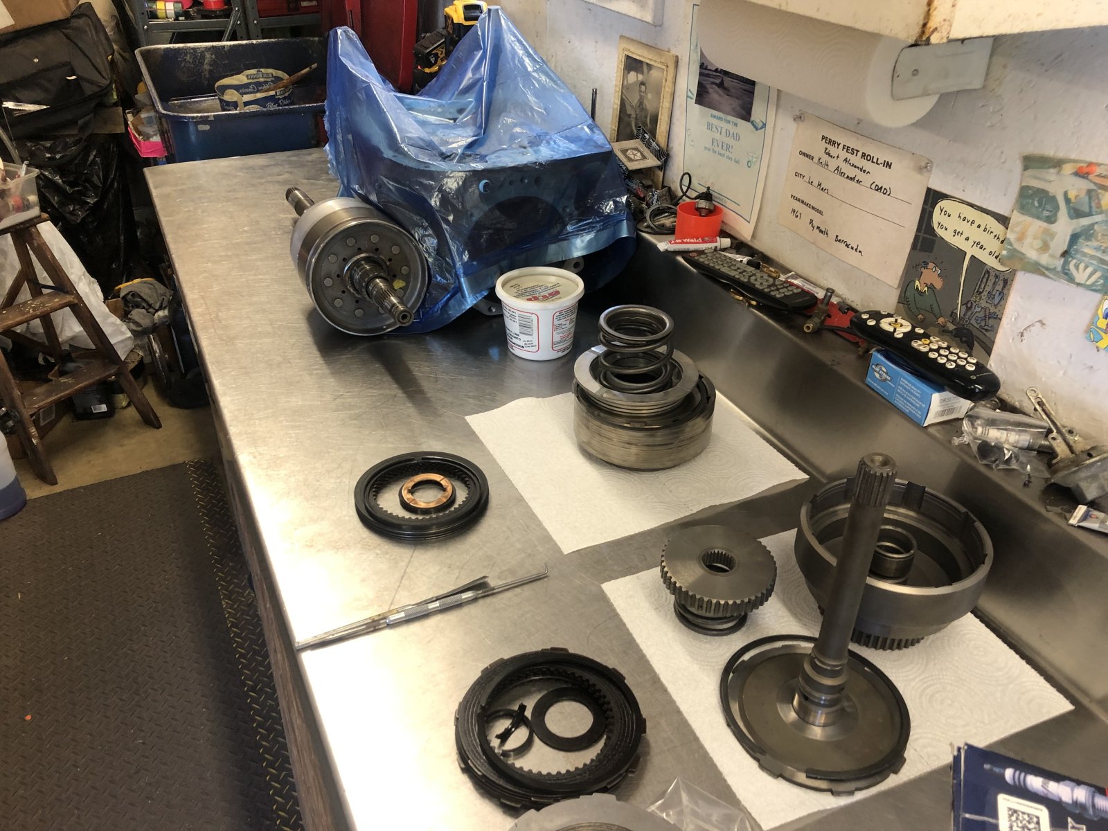

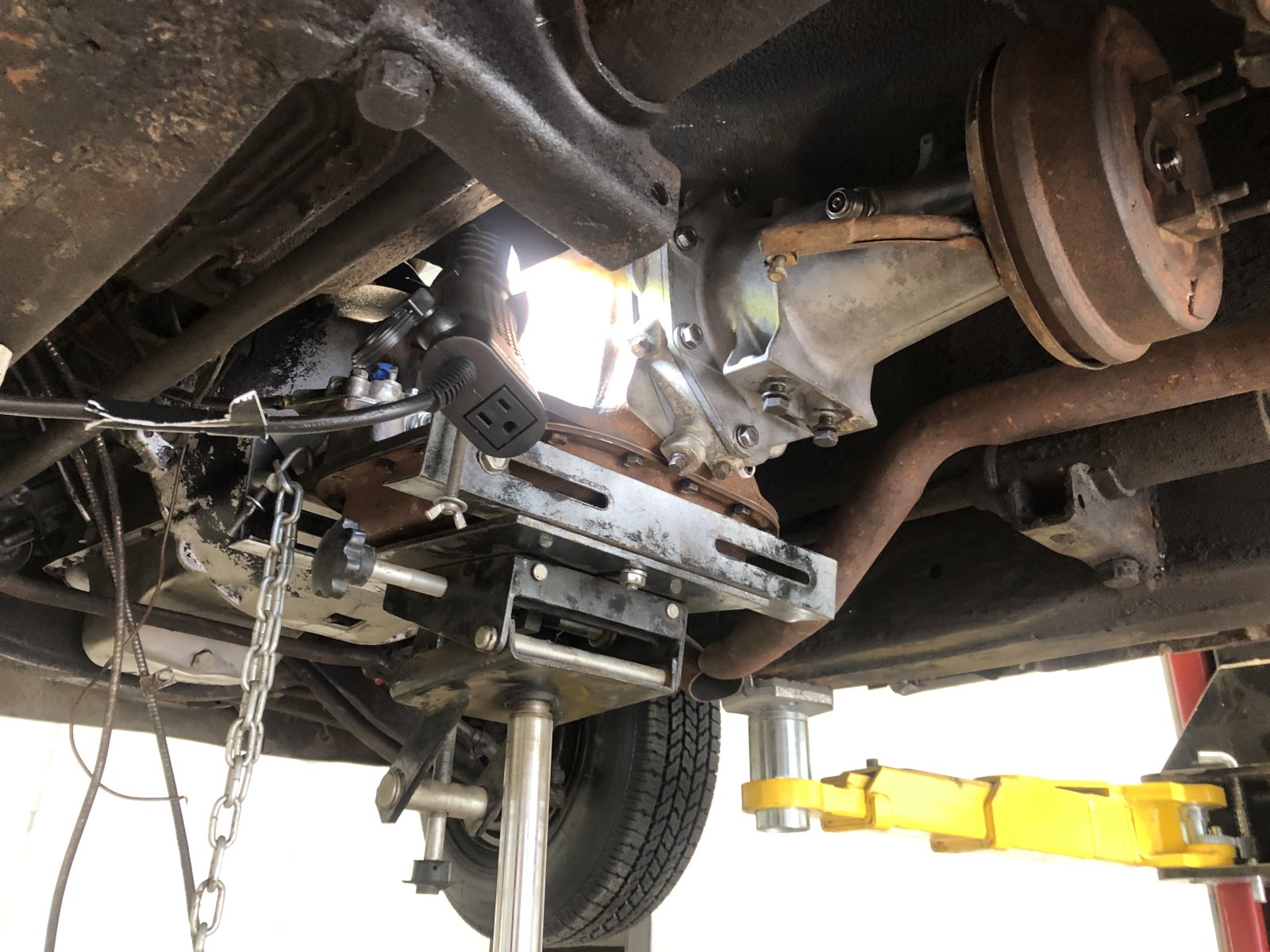

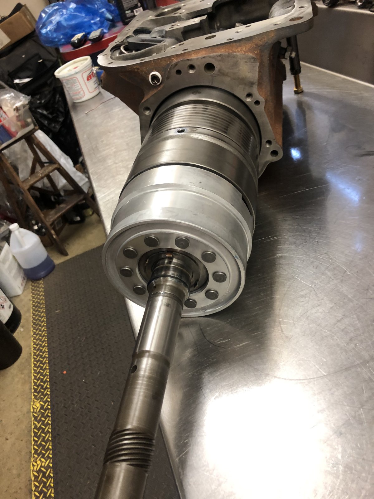

    Transmission was dropped off for oil leaks at front and rear and knew it would be best to disassemble, clean and check clutches. Forward clutch pack was slipping.
    Piston seals had hardened over time, and did a complete overhaul.
    I helped re install and not being there for the removal , was difficult figuring out the small details of cable adjustments and linkages.
    Found a suggestion to remove pan and have owner push buttons through the gears as I watch the detents on the valve body.
    Will be doing that next week. Appreciate all the info
