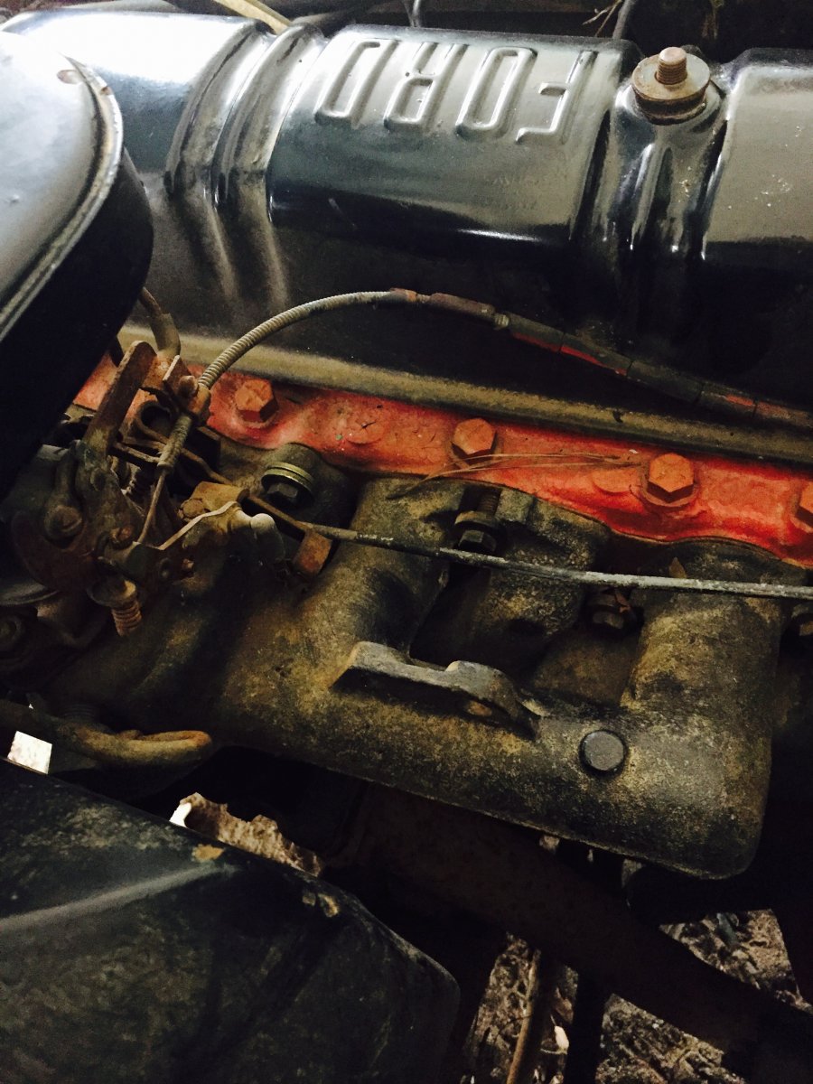

    Thanks JJ. I'm getting up bright and early to continue working and will have some better pictures of the linkage. I snapped one a few days ago when i was trying to figure it out...not sure if it shows enough image.jpg its a pushrod type of linkage but I'm almost positive something is missing. My brother in law has a different type of linkage.... For what it's worth the choke is free and operating properly even though it needs some cleaning... On that in the morning... Again thank you all for your help and support... Also thanks for following JT... Do you know if that is a 2 or 4 dr?

    im beginning to believe it may be a spring on the carb that I'm missing... Some sort of return. I don't get much feedback from the carb itself... Looking for a carb diagram

    You appear to be missing the throttle return spring.Any local auto parts store should have a generic return spring that will work.I am glad to hear it is a manual trans car.Old automatic transmissions can be problematic.

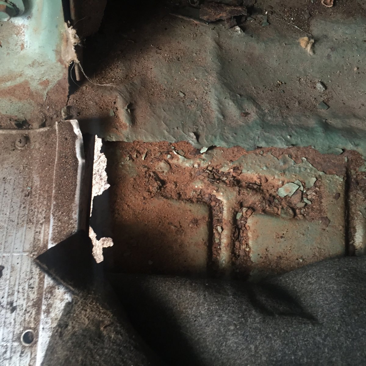

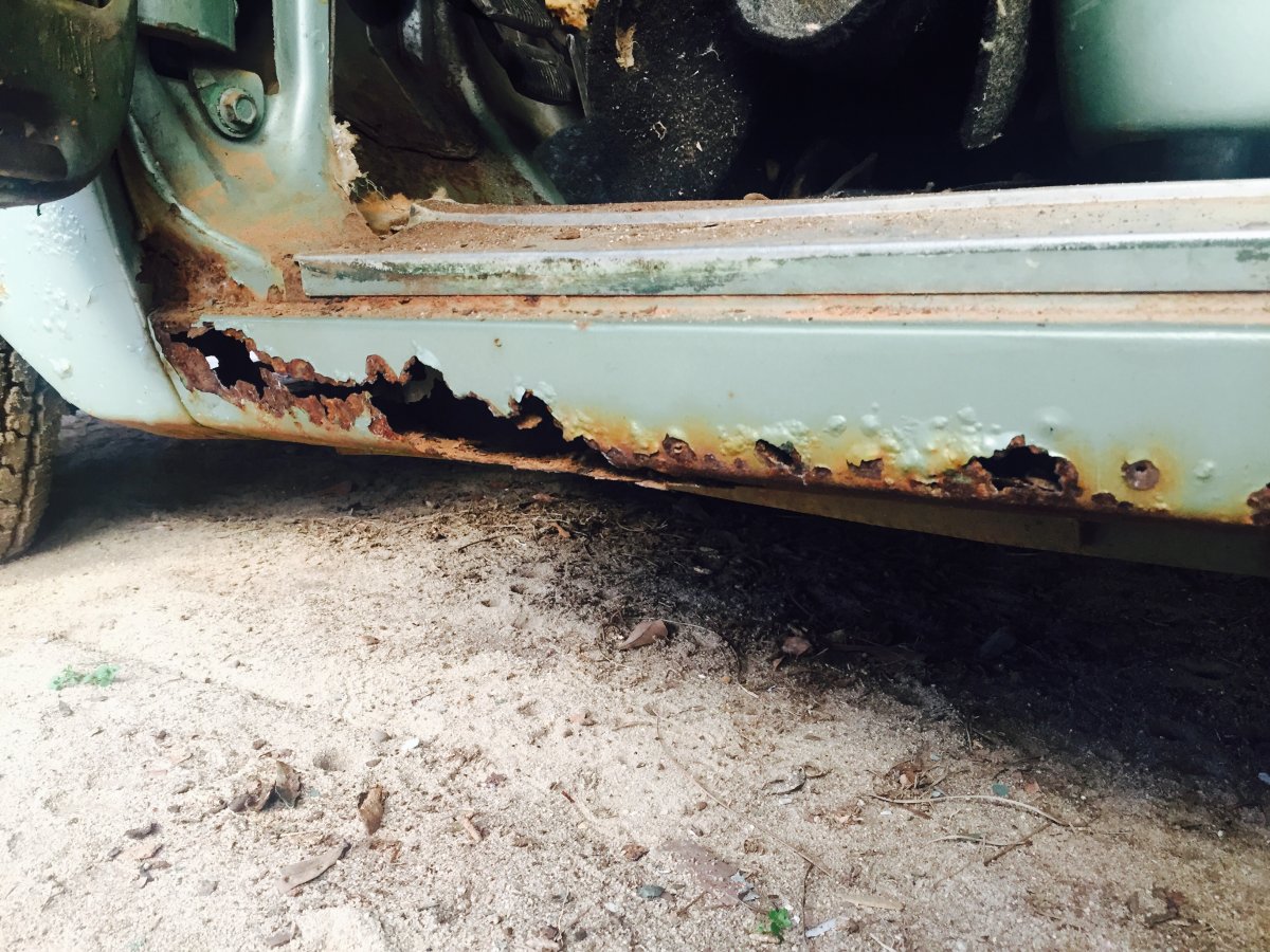

    Back again with some photos that aren't for the squeamish....as you can see, rocker is finished. Floor pans are a real basket case... Toe boards surprisingly ok... So if you build a car from the bottom up, do you start with rockers or floor pans? image.jpg image.jpg image.jpg

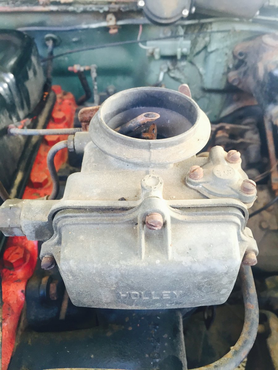

    What carb is it?
  27. bobss396
    Joined: Aug 27, 2008
    Posts: 18,732
    bobss396
    Fish or cut bait? Hard to say since there's a lot of rust to deal with. The toe boards look pretty good though. It would be a good idea to tackle both at the same time to get it out of the way.
  28. SoulProprietor

    I hear that! I found em... Turns out if you specify Edsel instead of Ford for the same parts at some places, they are cheaper for the same part... Which is fine by me. I'm about to go shopping.

    Rui
    Looks like a 1904.
    Attached are the exploded views for the Holleys. I can also send you other holley stuff and manuals but you'd have to provide an email. Large files.
    Have fun and good luck.
