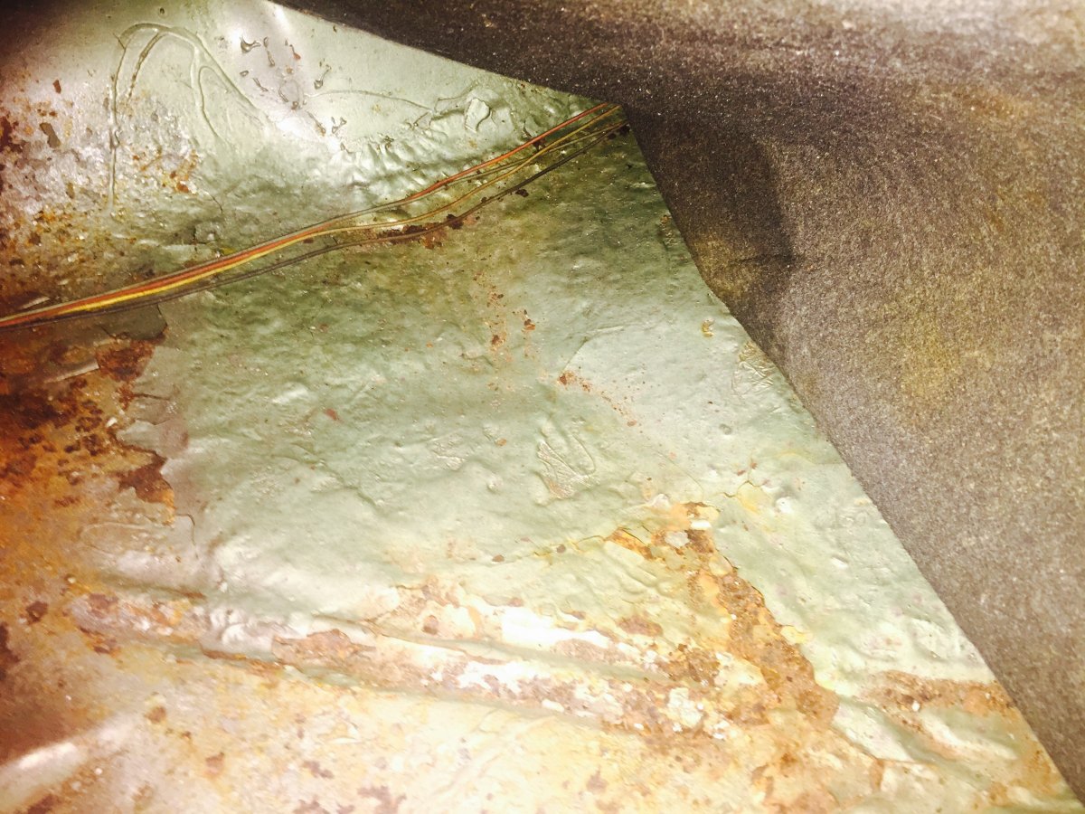

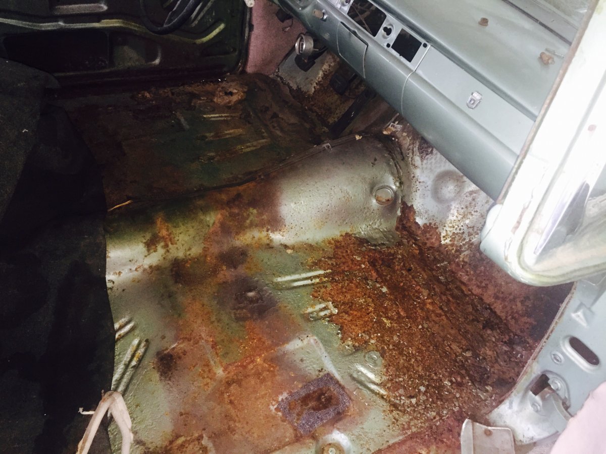

    Get all the carpet & seat out, lets see what the whole floor looks like. I'm not going to guess what is good and what is not. Where to start will depend on what is left. Generally, the rockers and body structure is where you begin. The floor pans just connect the body structure together.

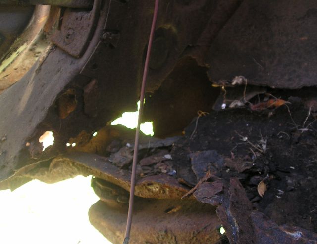

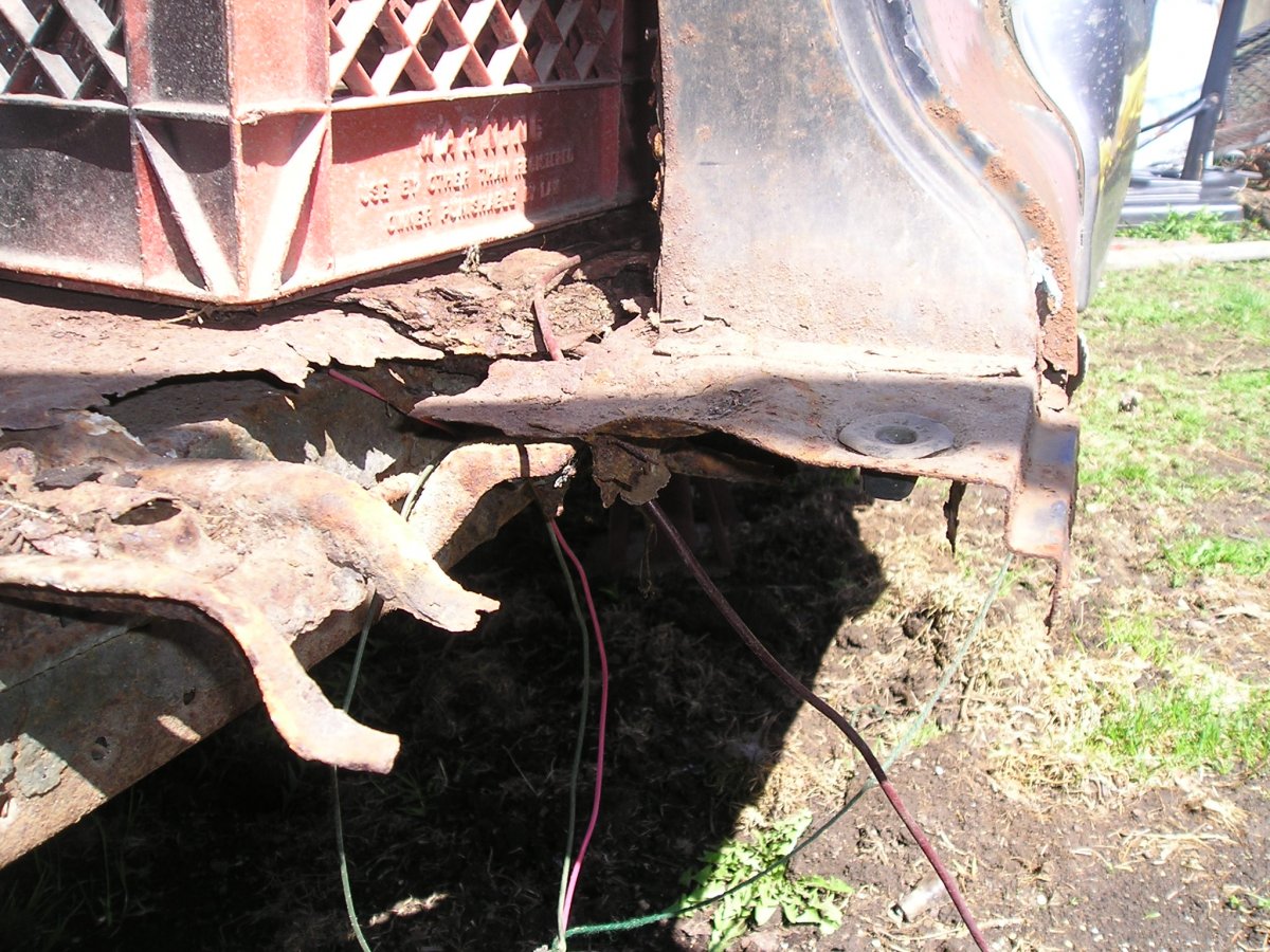

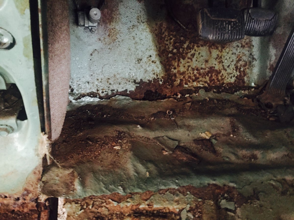

    Thought I'd show you a few pictures of the floors & rockers on my blue & white Plymouth coupe before I started. The last picture is the drives side toe board, from inside the car. Gene

    Wow, that looked rough Gene. It's amazing how that kind of rot can be turned around... I hope to be able to do the same. I would've and should've had it all ripped out by now but had a few things get in the way this weekend... I plan to strip the carpet the rest of the way out this evening. Some better overall pics will follow. I definitely appreciate the guidance!

    To be honest I think as a first major project you could risk a stalled project with such a lot of bad areas, floors sills rockers A and B pillars roof trunk etc. you love this car but does it have to be this exact car , I am sure someone here on the HAMB could help you locate the same model but with a pile less issues. Any way just throwing ideas out there.
    You say you don't want to redo work so bondo over rust is out. Your metal work does not need to be fancy just solid with a skim of bondo over the clean solid metal.

    I always like to look on the bright side of things and give things a go. As much as I would like to encourage you to give it a go what you have here is a parts car. What you don't want to keep sell and the money who will have saved by not doing the expensive rust repairs, which would only be a temporary fix you should be able to buy a far better body. A good 59 body shouldn't be that hard to find you will be chasing the rust in that old girl for ever it ain't going to go away.

    I am known to not be too bright -but-If that was my car I would get it running and driving and start cutting out pieces of rusty metal and welding in non rusty metal and in general doing the best I could.You cant hurt it and you will be surprised at what you can patch up.JMO.

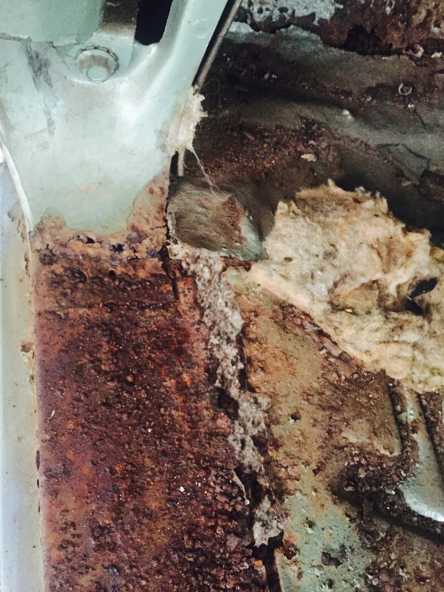

    Hate me for being realistic, but you cannot restore that car. It is way too far gone.
    Just take the roof project for a start; if you find a way to afford and haul a roof home.... You cut the old skin off and see that the attaching sheetmetal pieces are also rotted away... now what?
    The floor is not just a piece of sheetmetal that can be removed and a repro one put in, because all the attaching pieces will be rotted too.
    Some guys here have 40 or more years doing resto work, and it would not be an easy or cheap task if they tried to fix this for their own car.
    If you are broke right now, try to clean and repair any pieces that could be used on an incomplete rustfree body that you can afford later.
    If you don't trust what several have said, then just pick one bad area and go to town. Take the driver floor for example. Remove the fiber kick panel too, as well as cutting out the skin. You will be faced with the task of figuring how to fix the rotted front door post, and fix the inner and outer rocker that the post gets welded to.

    If you take a look to make sure your frame is Ok, and if the body support braces seem solid....your best move at this point with lack of major skills and money? I would use filler to make it look better.
    If you start cutting out metal instead, I feel pretty sure that you will get overwhelmed very quickly, and can't get it back to where it was before.
    By using fillers, you are not doing things that can't be reversed later. And it will look a lot better.

    The roof and the bottom of the front door jamb are pretty bad and this amount of rot only gets worse as you dig deeper. But you know what is ahead and not afraid to get dirty. With my car, I was lucky to find one as solid as it is. I never intended to take the car so far apart which easily added 6 months to my efforts. But a great day when the tide turns and it goes back together.
