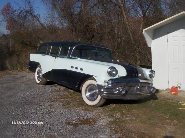

  11. If it was me I would get her running 1st and go from there. A running car is worth more than none running one.Get her running and if your up to it start with the floors. Believe me I know about tight bugets. I bought this running and driving buick wagon NOT!!!Got her running 1st than worked on the rust.Bruce. 00o0o_82PxJSvNBPi_600x450-1.jpeg
    SoulProprietor likes this.

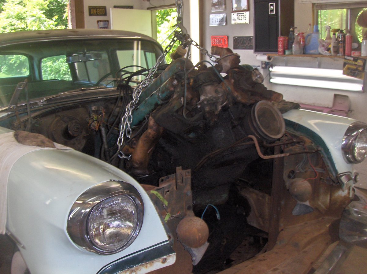

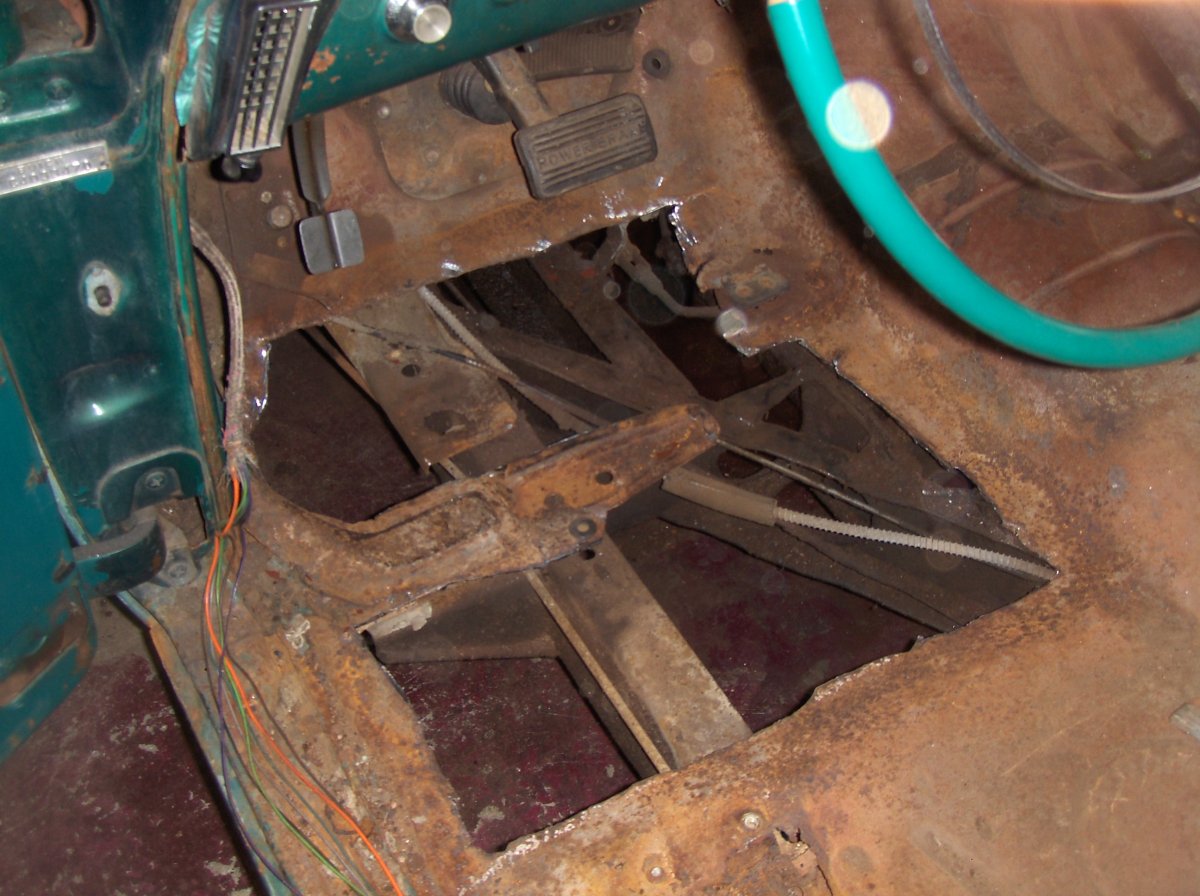

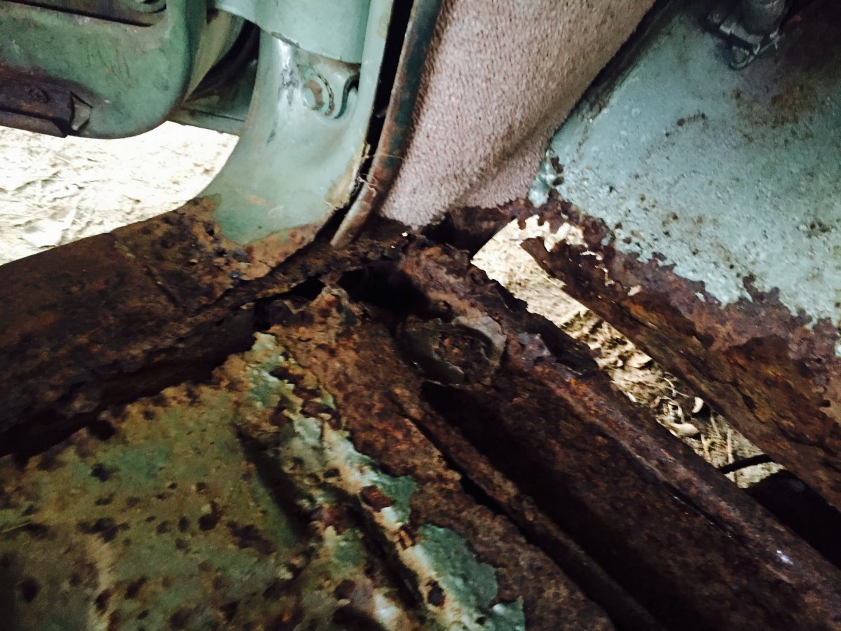

  14. Just got to lick your wounds and keep plugging away.Good luck Bruce. 002.JPG

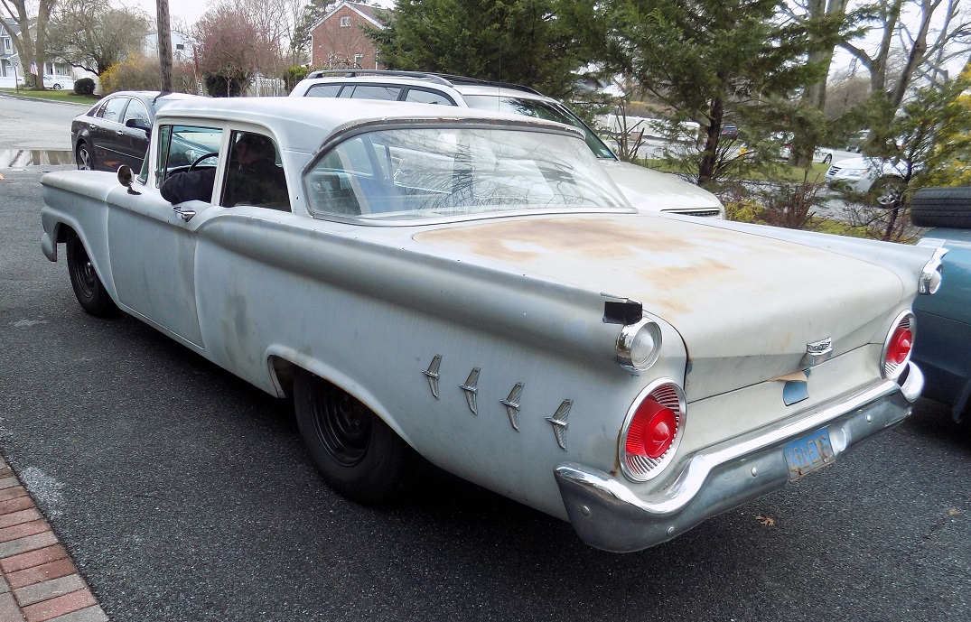

    This is my car as of a couple of weeks ago. I swapped to longer front springs after these were taken. I had a tire s****e issue.
