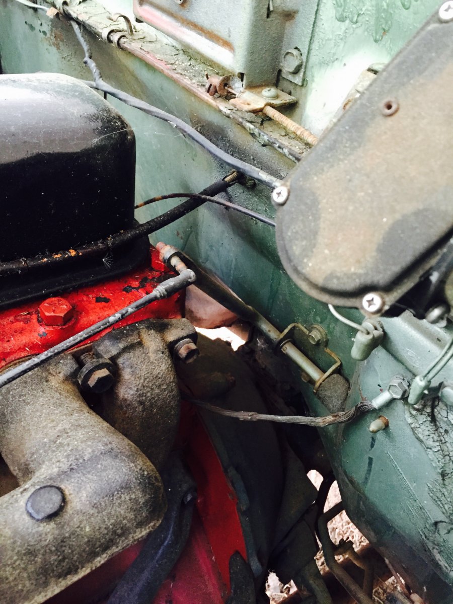

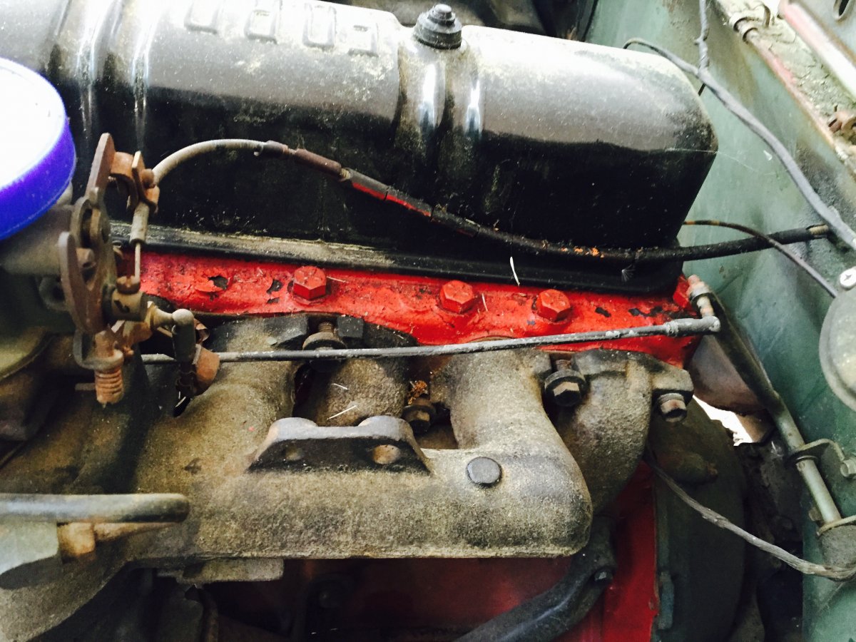

    I went back and looked at your pics,that looks like mostly stock linkage that has been put together wrong.Looks like you have enough there to make something that will work. Making things like throttle linkage is light,fussy work and can be fun.Especially if you are not up to carrying around engine blocks quite yet .;)

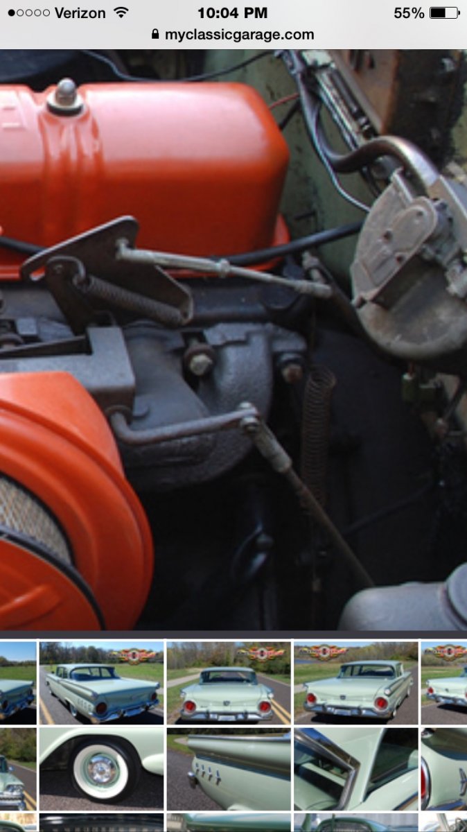

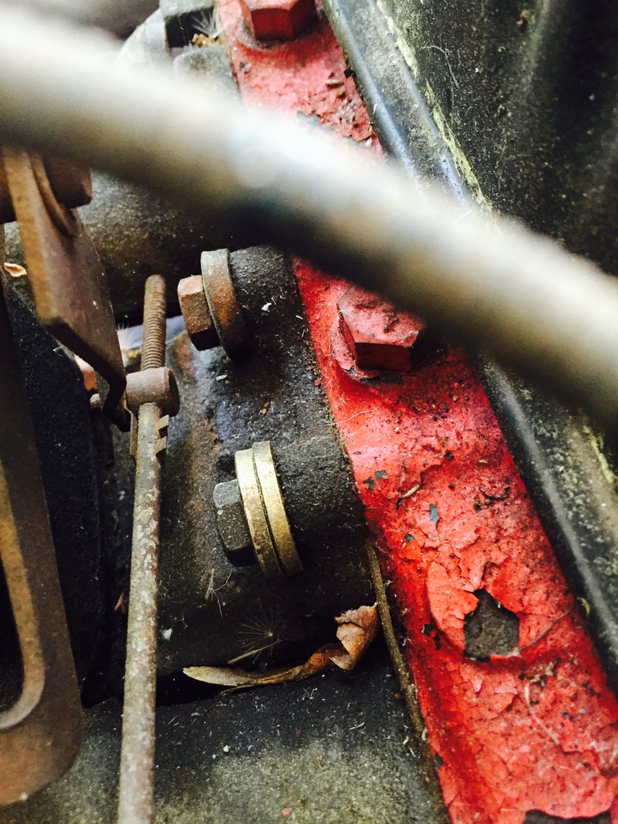

    So here are a few more pics of my linkage... I'm beginning to think that maybe what I'm referencing may not be right for my vehicle. image.jpg image.jpg image.jpg
    Does this appear to be a proper rod? I referenced this pic below and it looks like I'm missing this bracket with this spring. Is that why I'm missing return at the pedal? image.jpg
    I'm wondering if what I'm looking at is for a model with automatic ****** for the kickdown... I just don't have any return on my pedal... Any ideas?
  20. The second pic is of an automatic trans linkage install; the rod going down and disappearing is the kickdown linkage for the trans. The manual trans cars won't have that linkage or the bellcrank/brackets as shown. It appears that you may not have the OEM carb on the motor, but the linkage appear to be OEM.

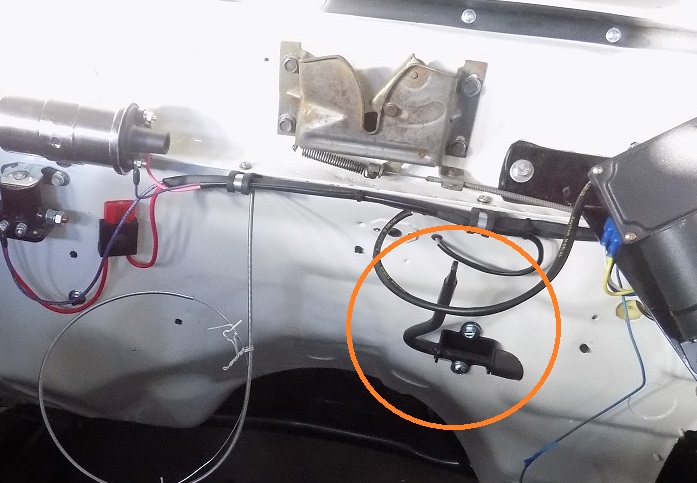

    I had a few boxes of loose parts that came with my '59, which was a 3-speed with OD from the factory. I know I have some of the linkage and will look for it later. This is what I had on the firewall... circled in orange, nothing else.

    Thanks for the input Steve. I'm going to reference that carb model... It is a Holley that looks to be from that era but may not be oem as you say. I have an autolite I may put on it. Does anyone know if the pedal return spring action is supposed to come from the carb or a spring somewhere else on the linkage? I'm ordering a manual this weekend. Thanks again.

    Thanks Bob. Yes mine has that linkage through the firewall too. Was there a spring action on that portion or did it just pivot freely?

    Your carb return spring may well have connected to the rod that goes between the carb and your firewall pivot on one end, and connected to a simple bracket at the front of the motor. All that spring has to do is pull the throttle closed when your not stepping on the gas. If the spring connects at the same location on the carb as the rod does, and the other end connects to something that won't move at the front of the motor, it will pull the throttle closed. That is what you need. The stronger the spring (or the more its stretched) the harder you will have to press on the gas pedal to get the motor to rev up. Gene

  26. Early cars (particularly Fords) didn't always have a secondary spring on the linkage, depending on the carb return spring only. Somewhere along the line (mid '60s?), the feds started requiring a secondary spring as a safety feature (actually a good idea) so if one spring failed, you'd still get throttle return. Adding one is a good idea, just don't get carried away on spring tension or driver fatigue can result.
