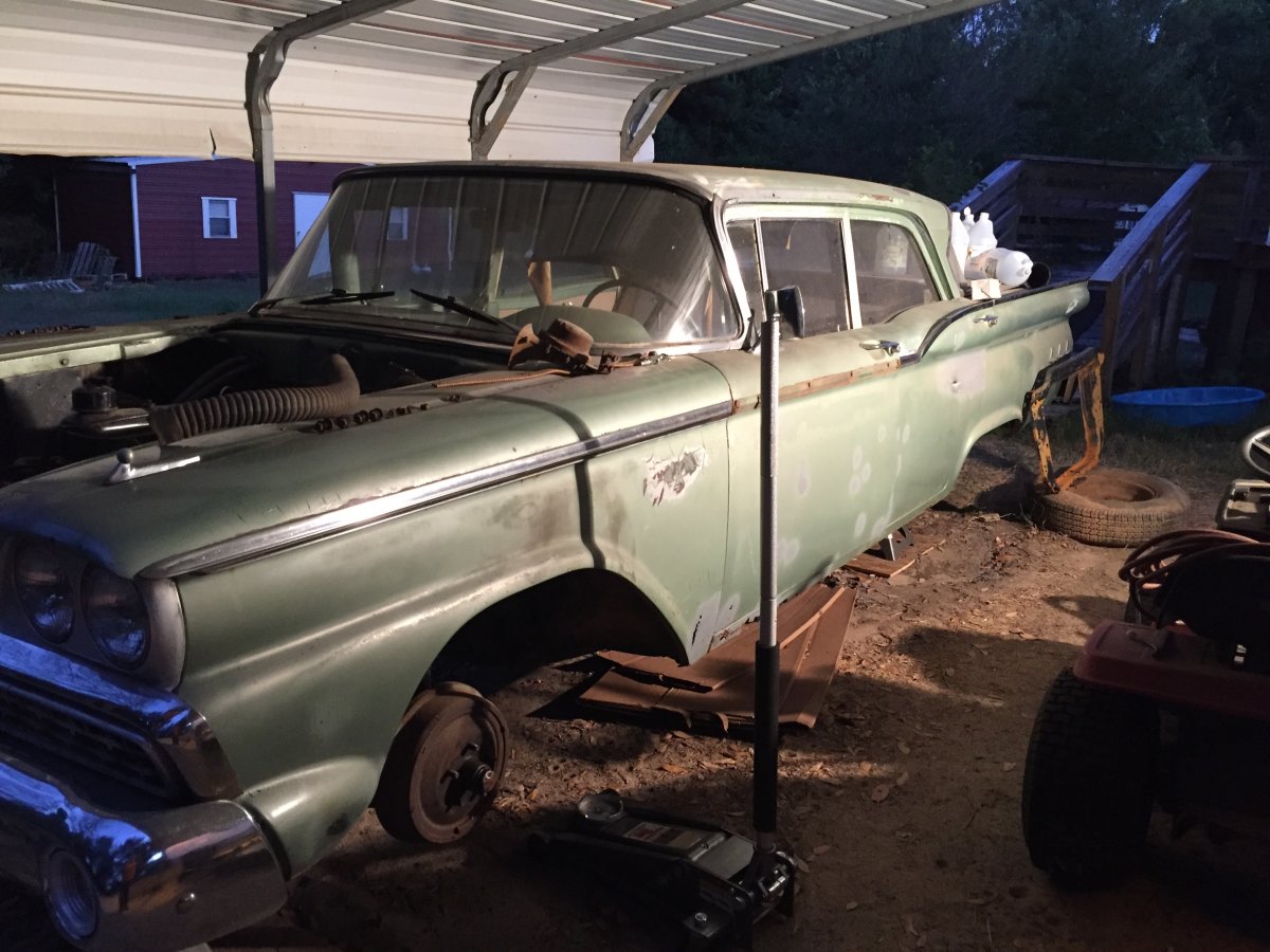

  20. SoulProprietor
    Joined: Feb 1, 2016
    Posts: 83
    SoulProprietor
    image.jpeg Time for a late night session...
    michael knight and jakespeed63 like this.
