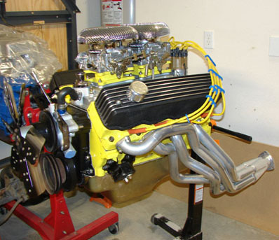

  8. Abomination
    Joined: Oct 5, 2006
    Posts: 6,775
    Abomination
    What is a Poly?
    I'm the webmaster at the Polyspherical Engine ***ociation.
    http://www.geocities.com/polyman64
    There's a bunch of info there. Feel free to ask around in the Poly Yahoo Group http://autos.groups.yahoo.com/group/318poly/ or the Poly Forum http://www.diamondbackengines.com/forums/index.php/board,6.0.html
    There's also a list of hard-to-find parts and their vendors on the ***ociation's site.
    Yeah, it could have a Red Ram, or maybe a 383, but as it was the 1st year that they started stuffing EVERYTHING with a 318 Poly, it's likely one of those. Hell, it became their bread & ****er, go-to V8 until '66.
    ~Jason
  9. Abomination
    Joined: Oct 5, 2006
    Posts: 6,775
    Abomination
    Polys have scalloped valve covers.
