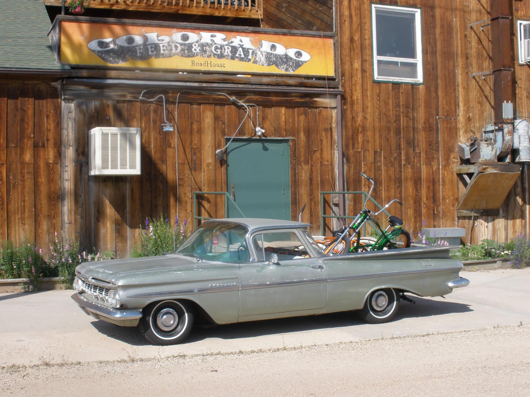

    Been following this build since the beginning, awesome job, your a motivater. I'll try to post a pic of one I picked up a few months ago, it's been sitting by a cornfield a couple of blocks from me for the past 17 years. A couple of days and I got it on the road, atleast to work and back and to the dump, home depot, etc....!
  10. The goodtimes start when I know I past the half-way mark, thanks Brent!
  11. Thanks for stoppin' by, an I'm glad to be motoivator. The world is becoming a better place with every 59, put back on the road! That looks like a nice El Camino. Very cool, Jay
