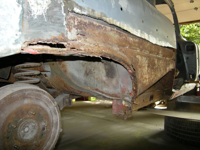

  12. Well, I finally had a little time to work on the Elky, today. I finished the metal work on the drvrs qtr, an I cleaned up the bedfloor. It wasn't a high point, grinding all the grimey paint and rust off! Some more time, this time with the paint & rust stripper wheels, will have it looking a little better.

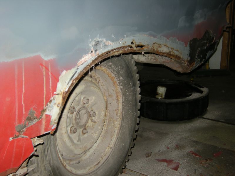

  23. So, All the paint is removed from the underside of the drivers fin.
    I used a dolly, and pushed out all the dents in the drivers wheel wells.
    I put the window regulator and t/lite ***y together. It moves pretty fast!
    I welded up the cancer in the drivers wheel well.
    Also welded up the rear sill, where the t/gate and that meet.(last picture)
    Tomorrow, I will fab up & weld in a mounting bracket for the window regulator motor
