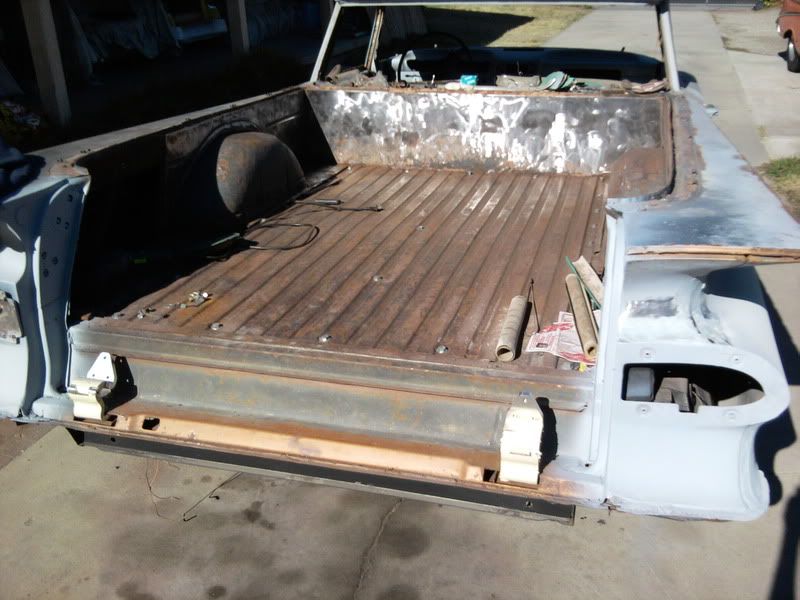

  3. Taped up the hinges and threw 'em on the decklid..
    The first time its had a t/gate since I've owned it!

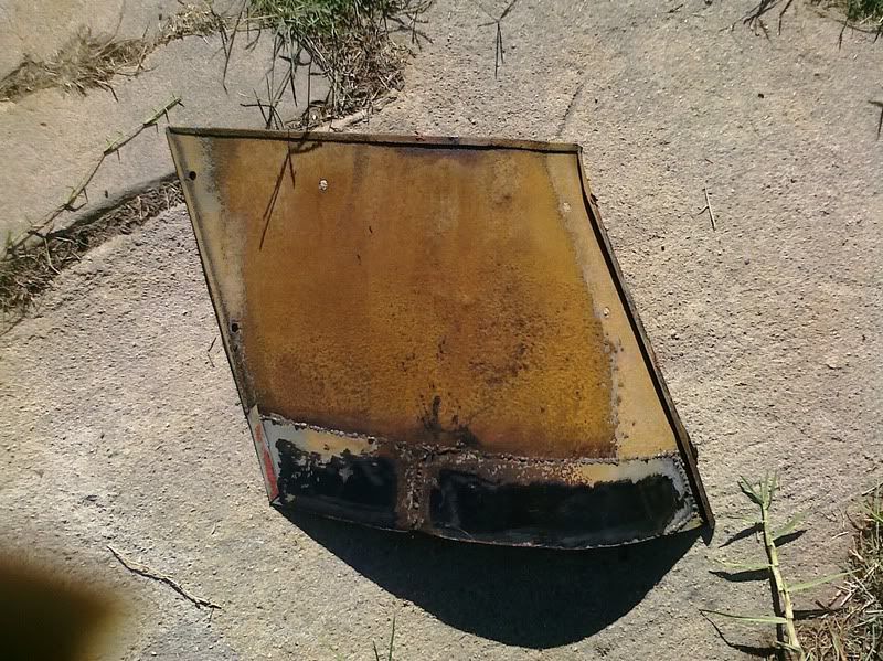

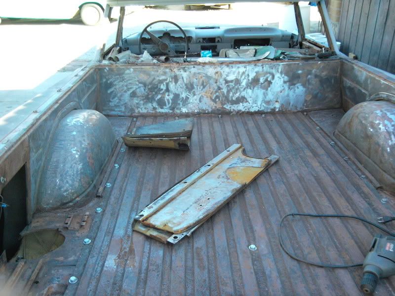

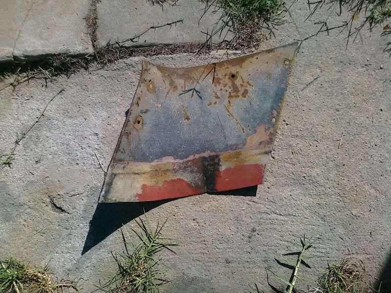

    Then I checked on the side bed panels, I have soaking in the molasses/vineagar mix.
    Tomorrow, I will cut out the rust and weld in a new pieces on the t/gates inner bottom.
    I had to use the circular file to elongate the t/gate holes. The hinges are exactly the same as the original specifications. No worries, just makes me wonder!
    Then I wanted to go over my MIG welds with the gas torch. Just to practice, really. I can tell the difference between the metals willingness to move, when I hammer and dolly after using the actyl/oxy welder. I used a 0 tip, and the thinnest filler rod. I look forward to using it more.
    Weld, grind the weld, hammer and dolly- repeat!
    I have to shrink the top of the t/gate in the morning.. Feels good to be working on this thing again! Good day, today!

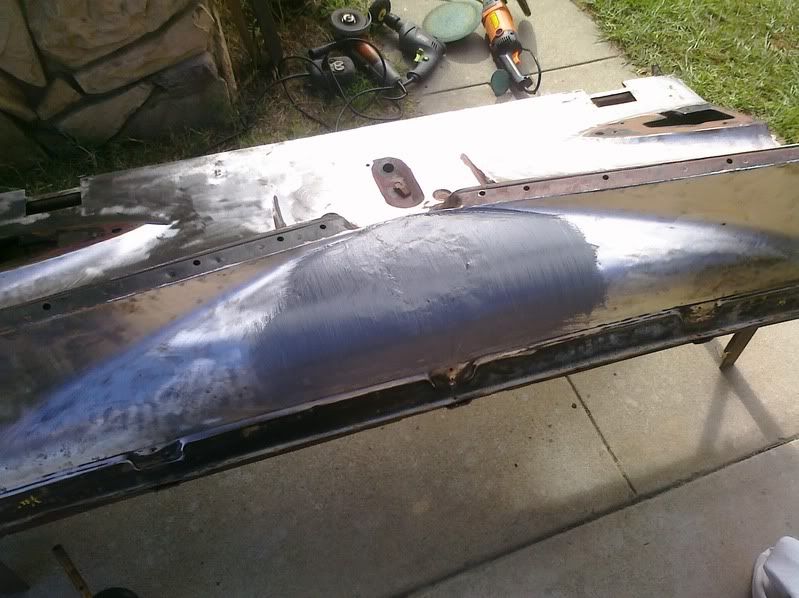

  9. More 'rustoration', today! I also pulled out that kink in the t/gates corner.

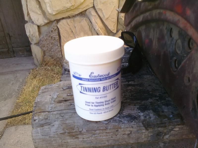

  10. Cleaned up the side bed panels, before I started my attempt at leading the t/gate.
    Started here
    Made the paste to nuetralize the acids?
    I didn't understand this stuff at first..
    It ends up resembling the powdered tinning, I'm used to seeing.
    Well, I learned what not to do. I need to see the old man do it, so I can see where I'm veering off!
    Looks like a Robot Agent, took a lead shit on the t/gate. Oops, better clean that up.. So I melted it all back off!
    And this is where I finished off.. Burned the f#*k outta my thumb, too Hahaha I learned a lot today!

  23. So I was able to get some primer down, weather permitting. Cleaned up the jambs a little and sanded on the t/gate some more! Felt good to get back on it, didn't even cuss once today! Hahaha
    The paint (Orig.Gothic Gold, The 2nd color Blue & The Zolotone) on the bed sides will be stripped down, tomorrow. I need to get primer on 'em while the weathers still in the 70's! Dad will be at the Veterans hospital all day tomorrow. So Imma get all the major noise making outta' the way, while he's out!
