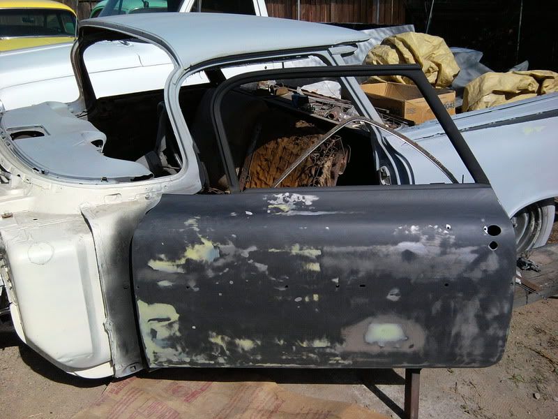

  1. Thanks. Yesterdays and todays experience, was not something I will soon forget. Shrinking some spots with the gas welder, I warped the door skin pretty bad, yesterday. But I worked it back into shape. Took quite a bit of time, yet I figured it out. And that's what this car/trk is all about, for me!

    Speaking of cutting corners, I left the old lead where it lie.. I'm not messin with it. I gotta keep it movin' The pic doesn't show the Metal Prep on there. I was 'slow' today.. but atleast I did somethin'!

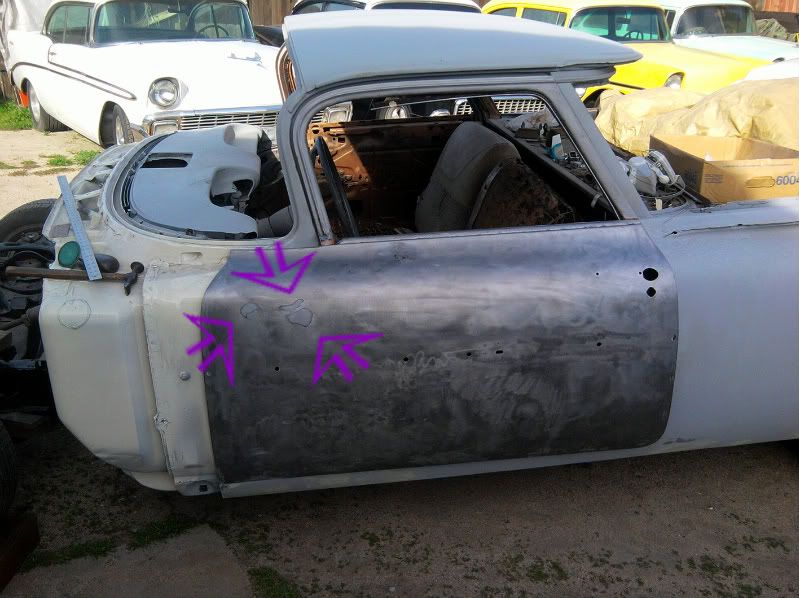

  21. Drivers door is finished, we'll I'm not working anymore on it.. put it that way!
    I've just been, all over this thing, tightening loose ends. Welded up the six, mirror holes.
    the gas welder is becoming my new 'BFF'
    Then began stripping it down.. the BL stripper works 'excelent' if you're inside a building with no wind. The spray bottle only works for a day also. Cos' the stripper eats up plastic. It takes 30 minutes for the stripper to do its thing, completely. The wind did me in, but usually, you don't use much since you just spay it on.
    The hours just slip by, before you know it.. I completed all the metal work, on the door. It's been another noisy day today.. ears still ringing. This is a before pic, when I had just got it down to the bare metal.
    Nice weather, today.. once the sun is gone, though! Fah-get about it..

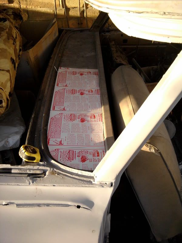

    Made the patterns for the doors and parcel tray..
    So I measured it with a micrometer, marked it with chalk & cut it with an ax!
    I ran out of daylight, but I just cut out the rough shapes(easier to take away material, than to add it!
