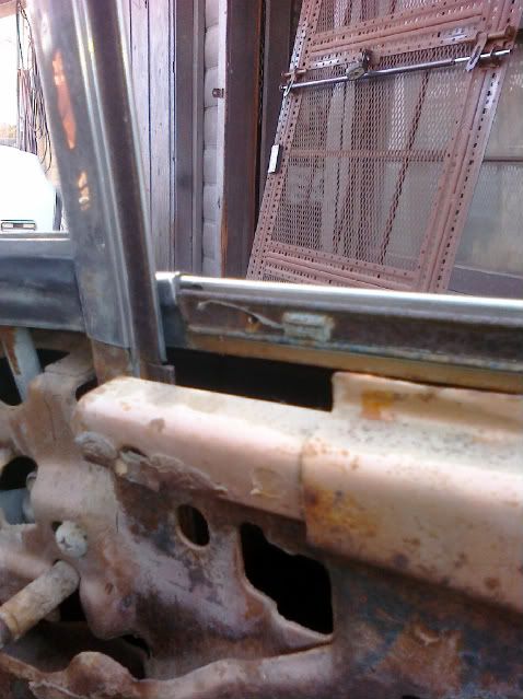

  1. The driveline is together, and surprise.. I found more rust! Shocking.
    I guess the drivers side needed to prove, its just as bad as the p***engers side

  4. look for rust under that lower center trim strip...it likes to rust there also.
  5. Shhh.. it can hear you! HaHaha.. It looked good when I checked it out, but I don't know whats lurking underneath there.
  6. yea both the '59 i had and my '60 had some rust under there. the window channels was rock solid but the channel under the stainless strip had holes and went into the cab.
  7. Before the rain started today, I was looking & poking around under there. Nothing is standing out, but that's why they call it lurking.

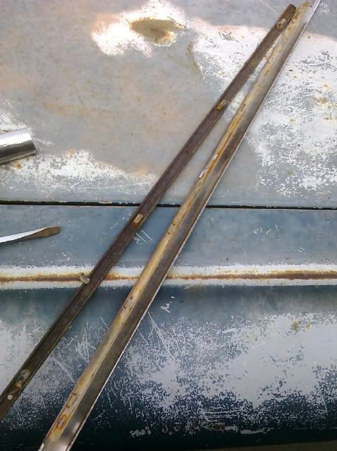

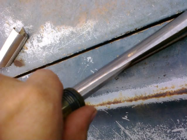

  18. Vintage44, Here's pictures of the tools. My Dad took the handles off. I wasn't paying attention when he was doing it. He had to use a screw driver, to keep the white plastic piece out of the way. The normal tool we use, wasn't pushing the clip out.
    Taking the molding off the door, you have to remove the screws holding the felt piece. Do not destroy the felt, you'll need it for a pattern. My felt is actually gone, it's just the backing.
    There's two screws to undo.. front & back
    the molding should lift fairly easy.. then undo these two screws
    It should slip out now
    The felt backing was still attached to the molding, on the p***enger side.
    Then I carefully pried the backing off the molding.

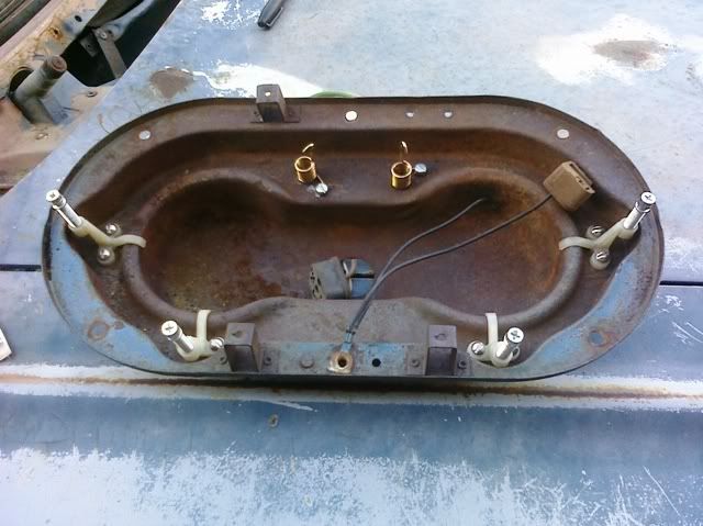

  26. Here's the speedo head I picked up a couple monthes ago. Clean piece and the price was right.
    Located the dash trim piece I needed today. Here's the 59 in boxes & shelves.
