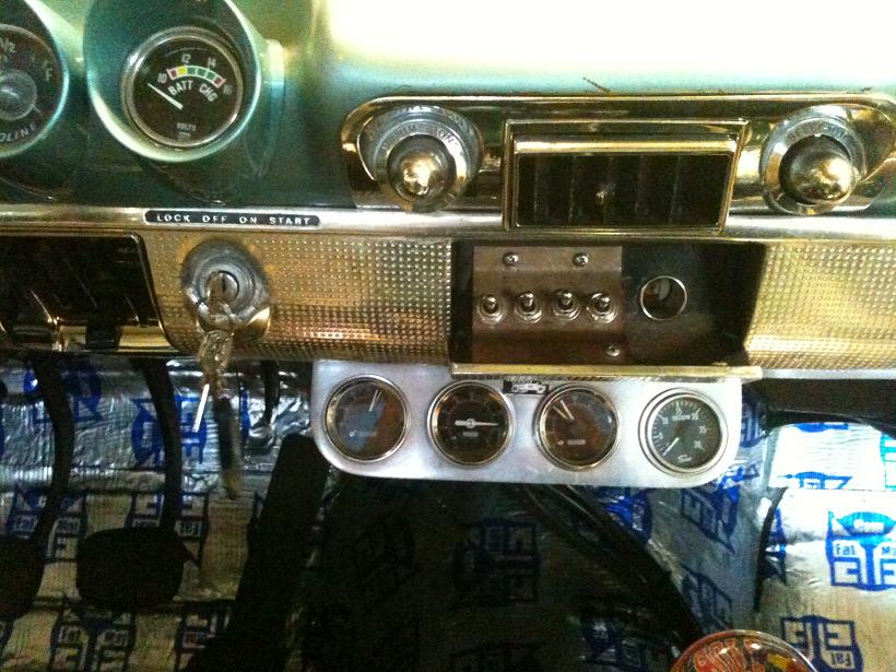

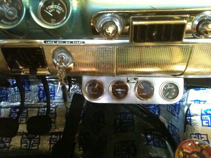

    When I get home I'll take a pic of all my bag stuff in the smugglers compartment, It fit great for me, although I do have it hinged for access.
    I put 4 individual toggle switches in the ashtray but kept the cigarette lighter.
    The air pressure gages are in a 4gage moon pod under the dash, a dual needle for front a dual needle for the back, a tank pressure and engine vacuume
  9. Yeah, pics would be great! I was thinking I have room behind the gas tank, on the underside of the bed. I might be able to get away with it. Vee Vill See!

    I put my full size spare behind the gas tank under the bed. It even fits between the hitch brackets with no problem.
    I also poked an A/C vent through my radio opening.

  11. I see there's enough clearance between the bed floor and the tanks. Enough, anyways! I'm not gonna carry a spare (Eeeeeewwww, such a rebel! Actually it's just AAA) I have too much time in my bedfloor, so I don't wanna cut it up and hinge it. Plus, I'm lazy! Thanks for the pics..
