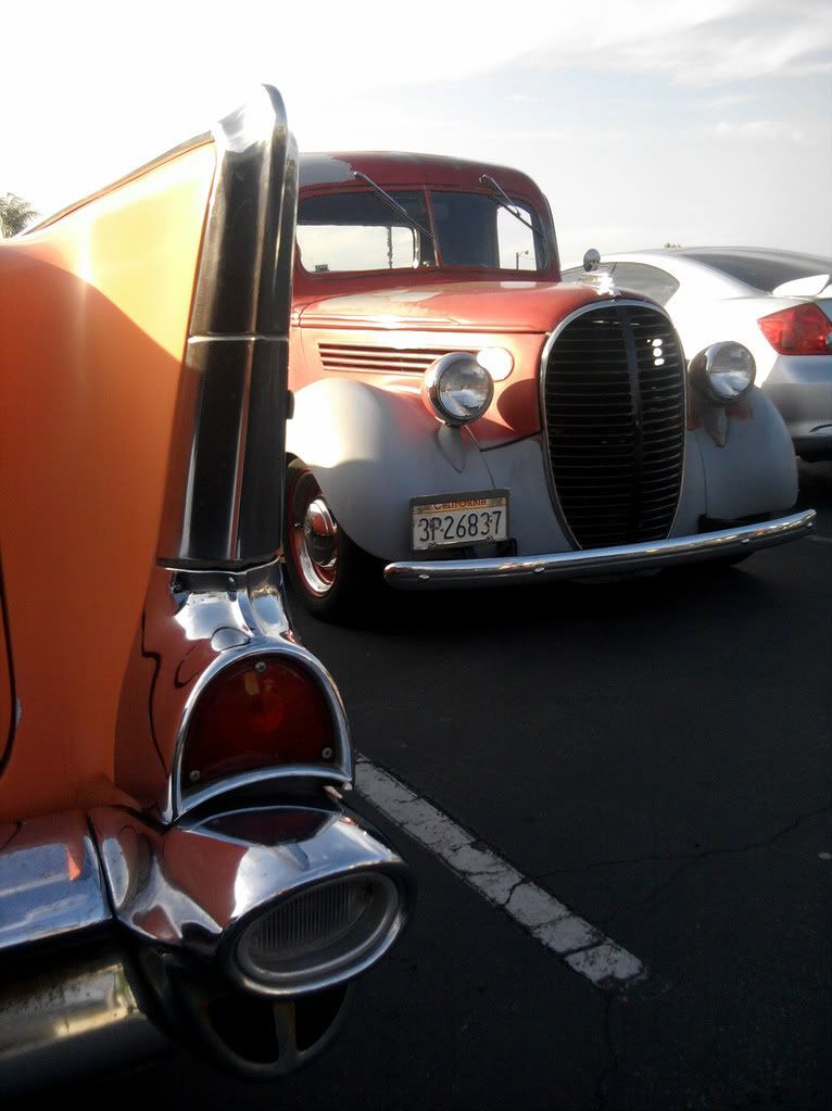

  29. I went to Tuxies for a while, today. Here's some pics I took to share 'wich-yall'!
    I love 57 Sed Del.. sorry
    I love the road rash!
