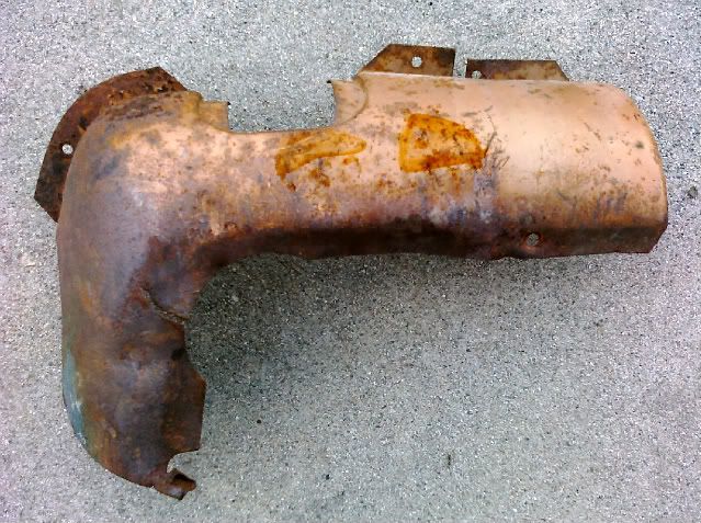

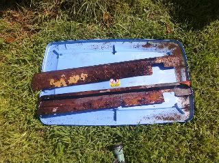

    Here's a before pic, of the one rear lower valance, that did come with the car. Vinegar works excellent, the rust peels of like soggy paint. Most of the paint came off, also!
    It was deceiving looking at the parts in the container. They looked like they did the day I put 'em in there. But today I seen the paint wrinkled & coming up. So I pulled them out & wasn't impressed. As I squirted them w/ the hose, thick layers of rust washed of like I've never seen.. A friend was watching me as I did this, he just kept saying "that's cool" - "that's cool". I was thinking the same thing, cos' I don't like sanding if I don't have to! [​IMG]
    Just water & a scotch brite pad worked amazing at removing the stubborn rust..
    The hinges look amazing, I put them back in to hopefully get the rest of thhe rust!

  6. I need to find a bigger container, but other than that. It's working,(even when I'm not..haha) doing a better job at removing the paint & rust, w/o grinding the GOOD metal away. In the end, less prep work for me, too!

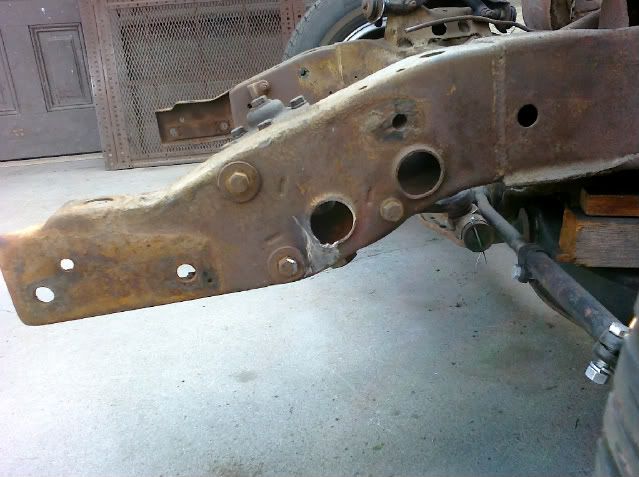

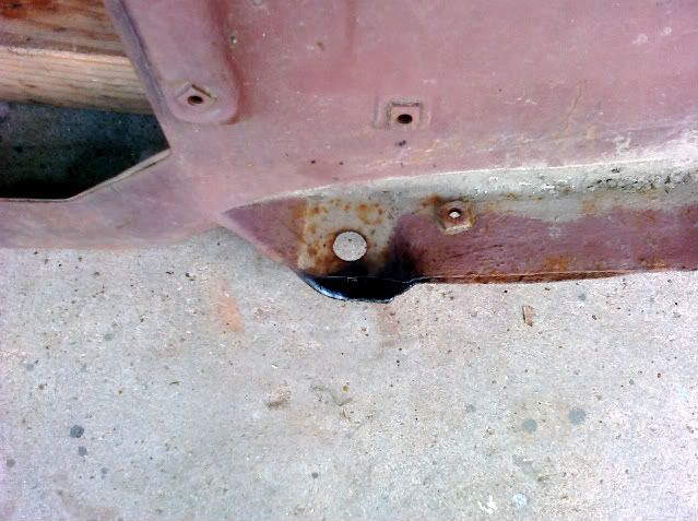

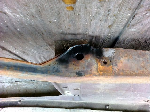

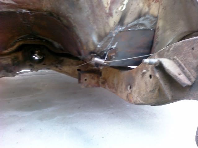

  14. Welded up the frame where the tow truck drivers hook, tore the opening. A little more time to get it looking like it never happened.
    Welded up the new "straight" core support. The bottom was cracked..
    I finally got around to closing off those holes in the rear shelf.. I welded in some mini patch panels!
    Once again, on "Weld, Grind & Reweld!"..
    Good enough..

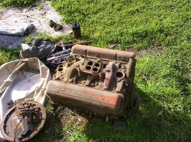

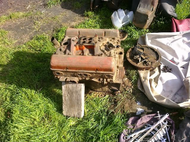

  16. Fuel lines off today, E brake cables routed to the back. S****ed more of the frame gunk off. Adding & cleaning parts in the vinegar derusting bin. Started taking down the 283 a little more today also. Sounds so small, compared to the 427 BBC, that's showing up tomorrow.(not mine, my Uncles) This is just the measly o' 283 that came w/ the Elco. Tomorrow, I am going to get the date code. Didn't think about it today.
    In Late 61 it was in the Vette, 62-64 Trucks & 63-64 P***enger and Chevelles.
    Why don't people change the oil... this 'ish is black in this thing! Froze up, too!
  17. Oct 19 1961 date code.. It was like scratching a lottery ticket! 3789935 is late '61 Corvette only w/ that date!

    As for the 283, I just tucked it away & covered it up. I will dis***emble it soon, since I'm very curious whats inside..Solid Lifters? All 64 and earlier SBC's, have forged cranks. I would think it has forged rods, being outta of a Vette. Perfect engine for a enderle injected roadster, I'd say!

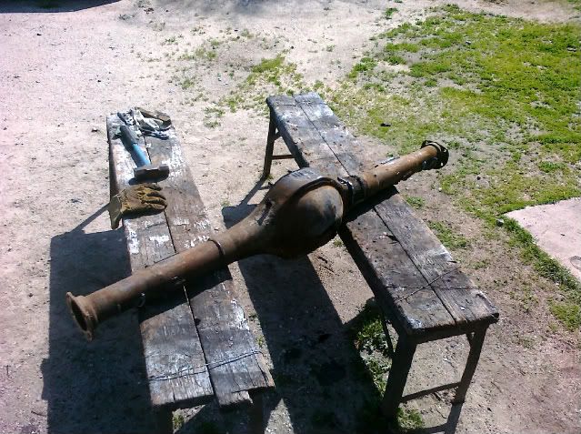

  22. Still soaking parts in vinegar. I need to make a larger container, somewhat of a big fishtank. Just a wooden frame & cardboard sides for integrity. Lined with plastic so I can soak the big pieces.
    These pieces do not fit down in the container I have, so I use a cup and baste the vinegar over them everytime I think about it.

  23. Uhhhh, I don't think the casting number dictates what vehicle it came out of........ ????
    Why would it be Corvette only?
  24. That Casting number was used from late '61 to '64. Late '61 was Vette only.. Date code says late '61, Viola.. Corvette

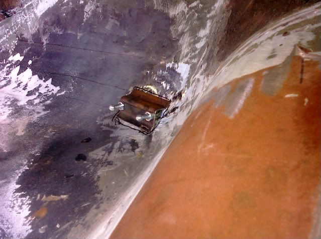

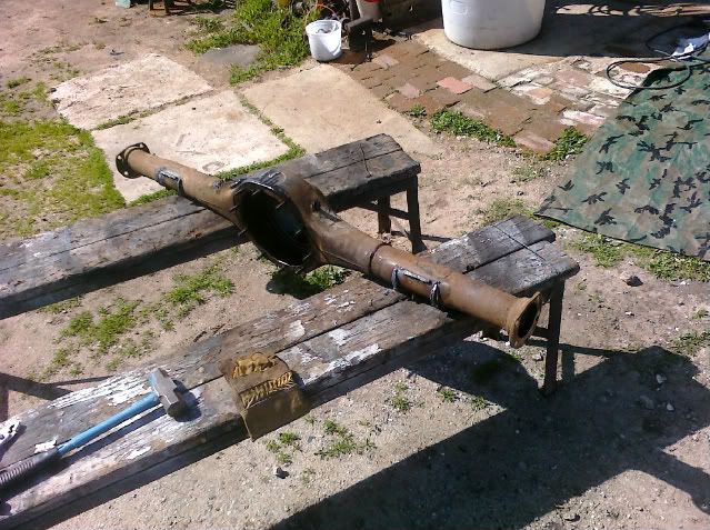

  25. Cut some brackets off two 9" Fords, today. First time using the new plasma cutter! So much fun turning metal into ****er!
    The new plasma cutter.. That's my Uncle Joe, the other half!
    Then I used the porta-power (the upper arrow) to push that body to frame mount(lower arrow) against the the new floorboards, so I could weld it.

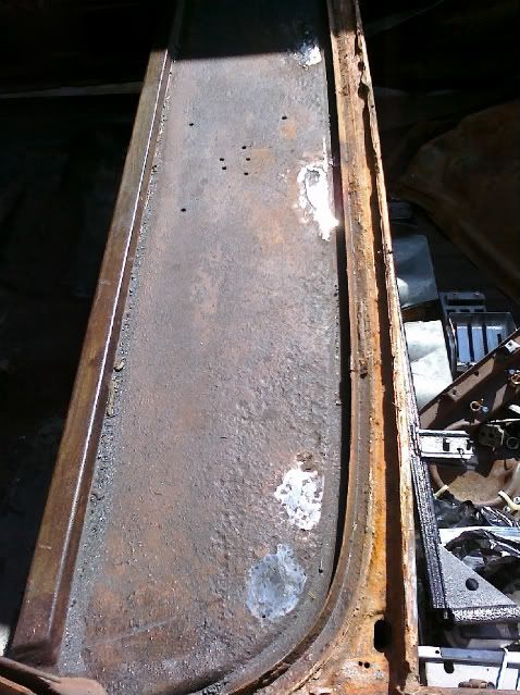

  26. Put a couple of paper towels down, then poured the "Blue Lightening Rust Remover" Kept the sun off with the cardboard.

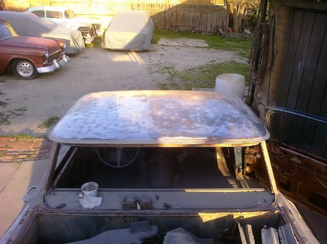

    "I DID MY HALF!" hahaha.. I wish. But, today I picked up a little more about using the slap file. Watched Dad shrink a couple high spots, then I fixed my first area that was "oil canning" succesfully. It was a great feeling when I pushed the spot down & it popped up on its own. He showed me where to concentrate on.. quiet a bit away from the low spot.
    I'll finish up tomorrow, cleaning the rest of the paint off. Then continue metal finishing the p***enger side of the roof.
    I want to make sure ALL the rust is gone, before I primer this up. I need something to remove ALL the impurities. I see a trip to the paint store in the near future.
