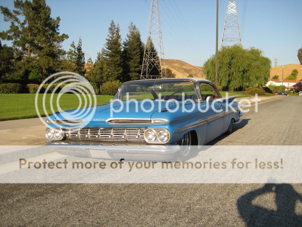

    here's a few. Some Really Cool...some not as cool...hahaha.

    Slammed 59 with nice supremes.

    that blue impala is bad ***.
