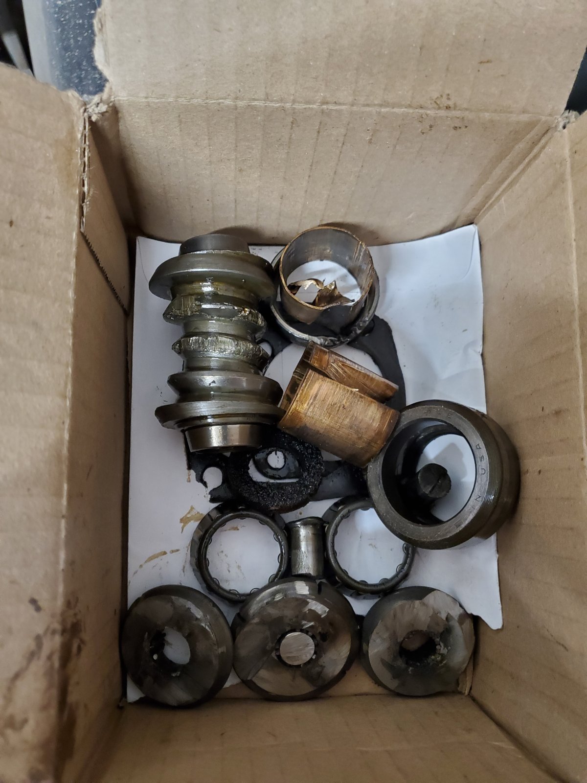

  1. My new to my 59 F100 had a clunk in the steering box. When making a tight right turn it would lock in position and I had to arm strong it back past this spot. Tore the column out and this is what I found. Luckily for me I've only put a mile or two on it since I acquired it. Let the rebuild begin. 20210821_184735.jpg

    Yikes!:eek:

    I’ve heard the worm is a bear to press off .
    There keyed or hot pressed on , I do know you can’t put to much heat as It could soften the steel . I myself will be dealing with something like this soon .

    The worm is an easy press and no heat is require. I use a 7/16"-1/4" drive, deep socket to press them off the shaft. They have a shallow, tapered key that engages a slot cut into the steering shaft. Only thing to watch out for is when pressing the worm onto the shaft. The shaft needs to be supported throughout it's length, or it will bend. There are a few ways to do this. I like to use a stack of 2x4's with a hole drilled through each one. Stack them up and secure them, then slide the shaft down into them and press on the worm. The boards will support the shaft from flexing. Another way is to slip a heavy washer or nut onto the shaft close to the worm, weld it on and use it as a support. The washer or nut can be left on the shaft as it won't interfere with anything.

    I've never seen a worm gear that bad. Gotta wonder how they did that!

    I just pulled my f100 box apart and same thing . Looks like a rat chewed on the gears . Sector is mint.
