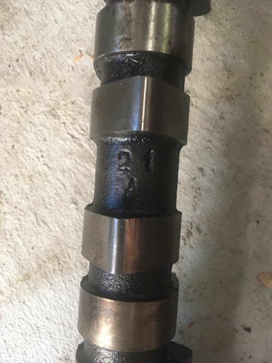

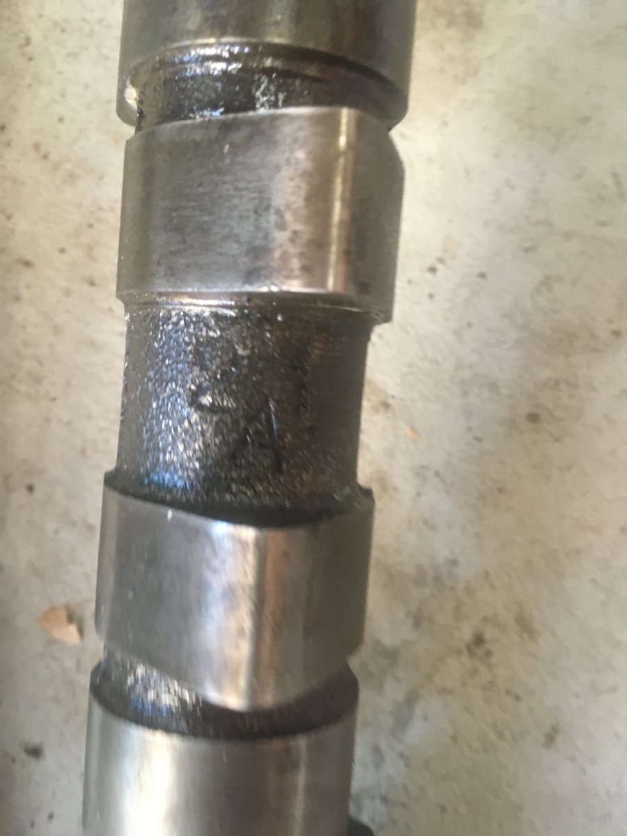

    I went to send a camshaft out to be ground today.
    Both came out of 59's
    One allows oil into oil pump chamber and into valve chamber.
    One allows oil just into oil pump chamber.
    Thoughts? Better oil pressure? Filtering?
    Both cams marked 21A

  4. Old-Ford-Iron
    Joined: Jun 9, 2020
    Posts: 38
    Old-Ford-Iron
    I think Ford retained the 21A part number throughout the 59 series. Interesting if they changed stock cam lift with the same part number.
    Clearly here though we have two 21A stamped cams with different options on the rear cam bearing.
    One came out of a seized 59 with 8ba rods/ 8ba valves. it was in a vehicle
    One came from a free spinning 59 with 29A rods/mushroom valves.
    I think they are interchangeable. just looking for thoughts--or in case I'm missing something.

    Old Ford Iron you have where the oiling is coming from incorrect. Oil that feeds the rear cam bearing
    comes from the oil pump idler gear chamber. The oil pump fills this chamber with oil to the height of a hole located at the top of this chamber. The slots in the cam bearing journal surface allow the oil coming from the pump idler chamber to oil the cam bearing and the fuel pump push rod eccentric surface. The Ford design works nicely in most applications. The difference in the two cams you have the single slot or double is actually not that important the important detail is the actual cam bearing journal diameters on the cam. Fords minimum cam journal diameter is 1.7955 that's the smallest diameter allowed for the standard diameter cam bearings. Anything under that diameter will need to be ground an additional .010 under. Remember all three cam bearing journals need to be measured.
    The oil pump first feeds oil to the rear main crankshaft bearing then some oil heads towards the gear drive compartment. Next oil is flowing to the cross passage in the block casting which then leads to the oil tube located in the valley of the block. From this tube the remaining areas are feed oil.
    Ronnieroadster

    good feedback, thanks
    so the the two oil gallery holes in the rear cam bearing both have oil coming solely from
    oil pump idler gear chamber through the "slots" in the cam bearing journal...
    ya something to be aware of. I need a oil passage diagram now that you peaked my interest
    It just seems like you could have a good unneeded pressure drop with the two "reliefs" (5 psi?). Interesting experiment to do if someone has the time lol. I sent the single "relieved" one in today. As it is passed Ford's recommended (1.7955) minimum parameters and won't need turned with oversized bearings.
