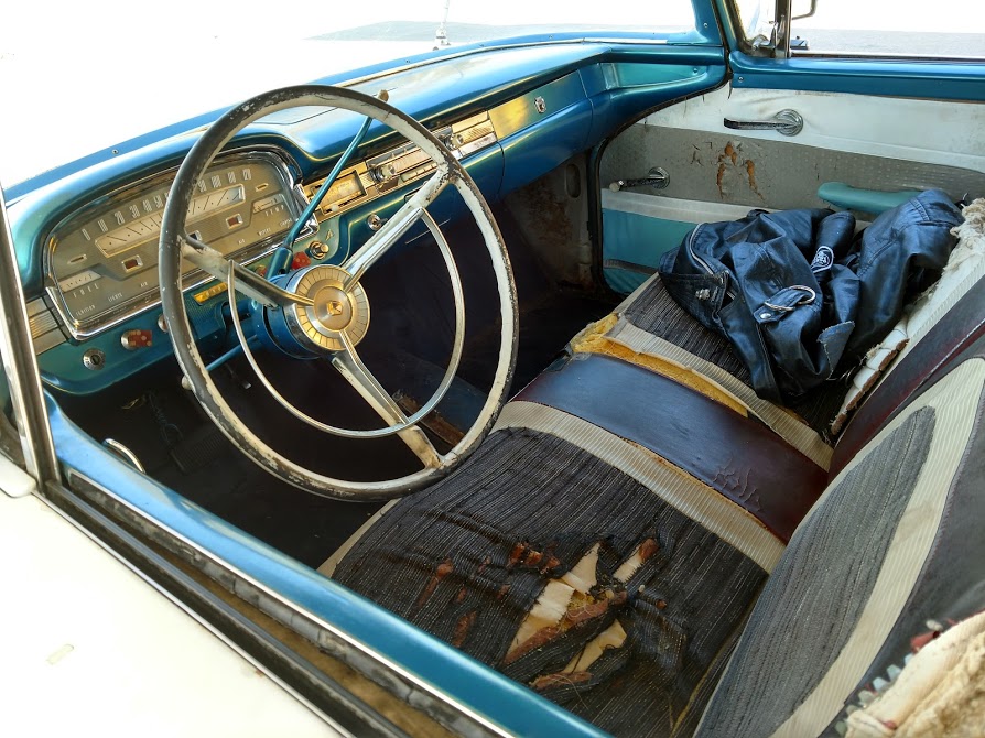

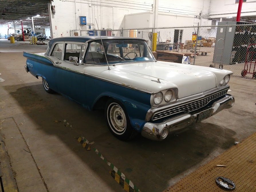

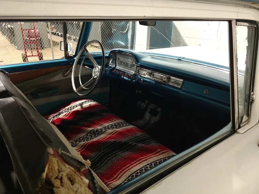

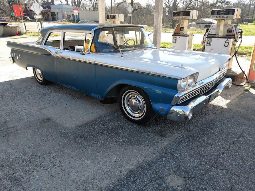

    Hey everybody,
    I'm getting around to posting some pictures of my 1959 Ford Custom 300.
    I have big plans for it, but this summer I'll just keep it going well enough to attend my rockabilly events and cruise-ins. I daily drive it for now also.
    Sure feels good to snag one of your dream cars! To be honest; when I started going to The Road Rocket Rumble years ago I thought I'd never be able to get one... and just look how lucky I am!
    Very grateful to be a part of such a vast and knowledgeable community of like-minded folks. Enjoy some pictures!

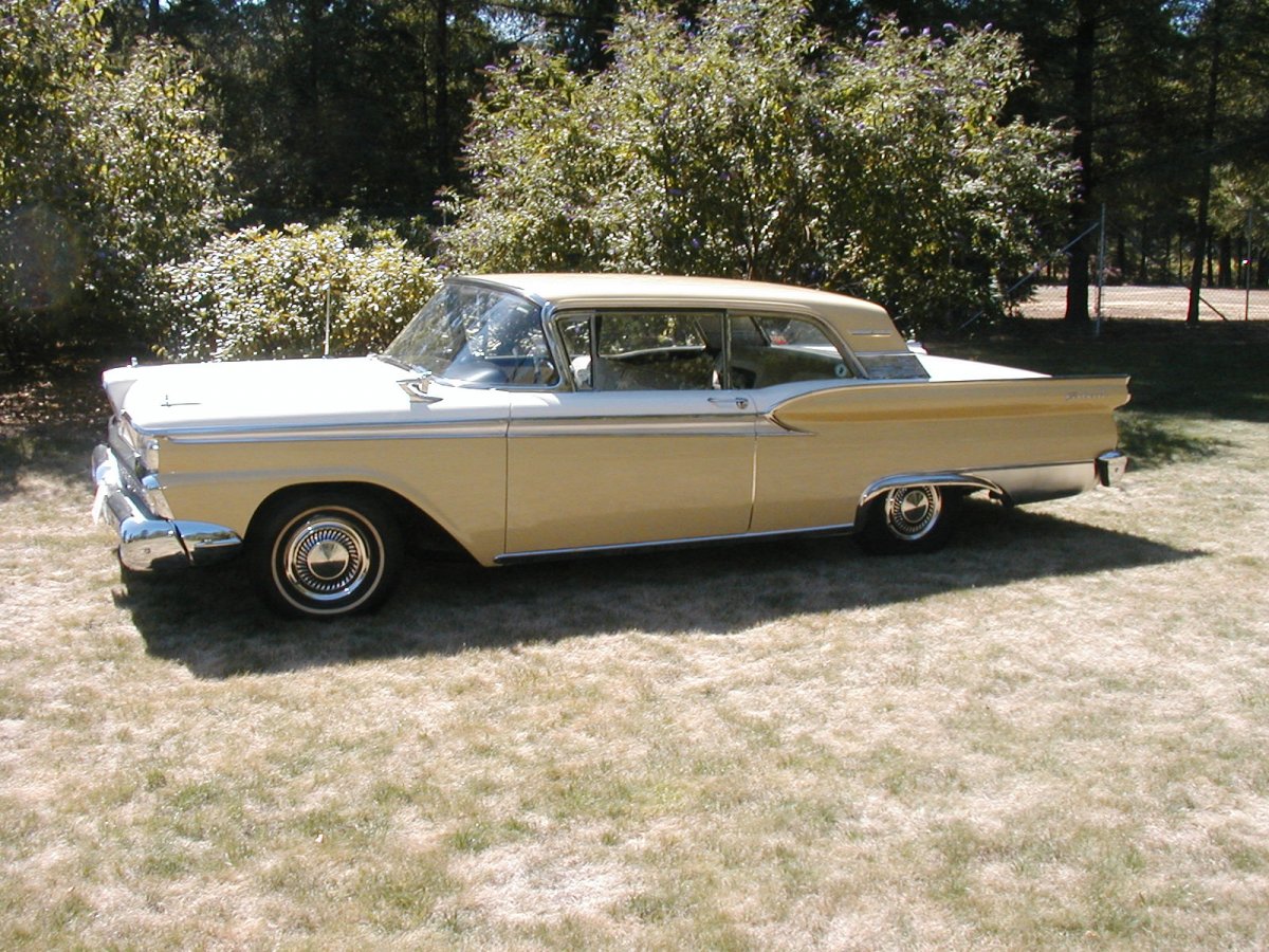

  6. I know how you feel. Here's mine. They sure get a lot of comments and you don't see that many of them. It often times wares my original American 5 spokes.

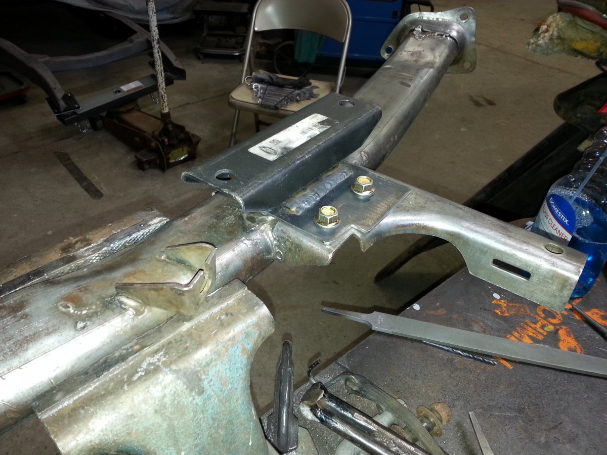

    If you wanna run a T10, im in the middle of doing that in my 59 but with a FE. I was able to use a T10 from a full size 62 Galaxie, modified 62 ****** mount, and stock crossmember. Went together real well I thought..... 20180201_120454.jpg 20180201_120545.jpg 20180204_125005.jpg 20180308_224208.jpg 20180308_224153.jpg 20180401_212407.jpg
    57 300, bobss396, mgtstumpy and 4 others like this.
  27. UNSHINED 2
    Joined: Oct 30, 2006
    Posts: 1,211
    UNSHINED 2
    Still have to weld tunnel in. I had to make the tunnel a little wider for clearance for the shift linkage....hope this helps you a little
